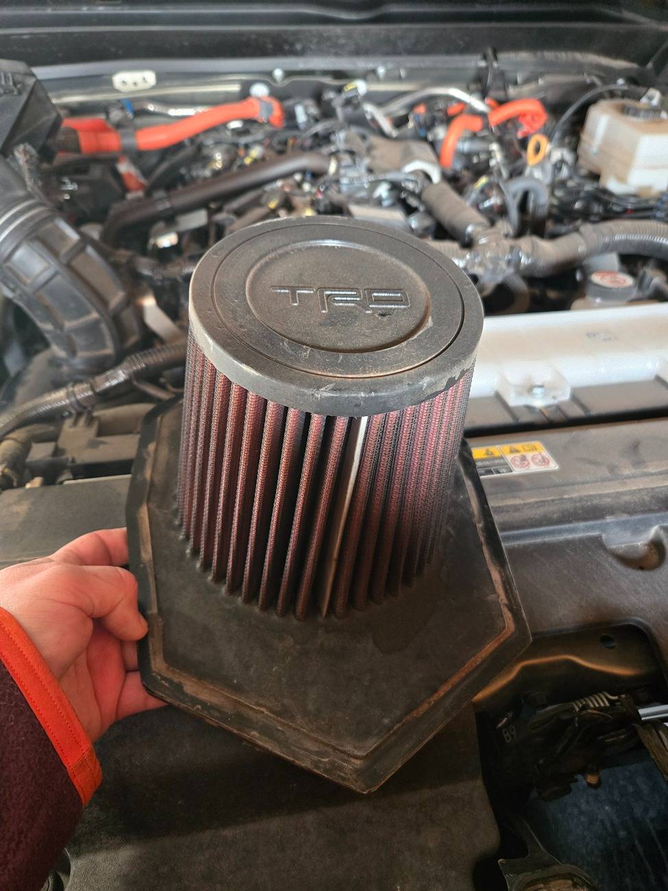

Just replaced mine. If you disconnect the mass air sensor it’s super simple and quick.
The new filter only had a tiny bit of oil on it. I was tempted to add more, but I didn’t wanna mess with the OEM spec.
Not sure why unplugging the MAF would make it easier, it doesn’t interfere with anything, the process still sucks, here’s before and after 21k
If you don’t unplug it, you cannot pry the filter housing apart by more than 2 inches. If you unplug it, it comes right open and it doesn’t suck at all. It’s super easy.

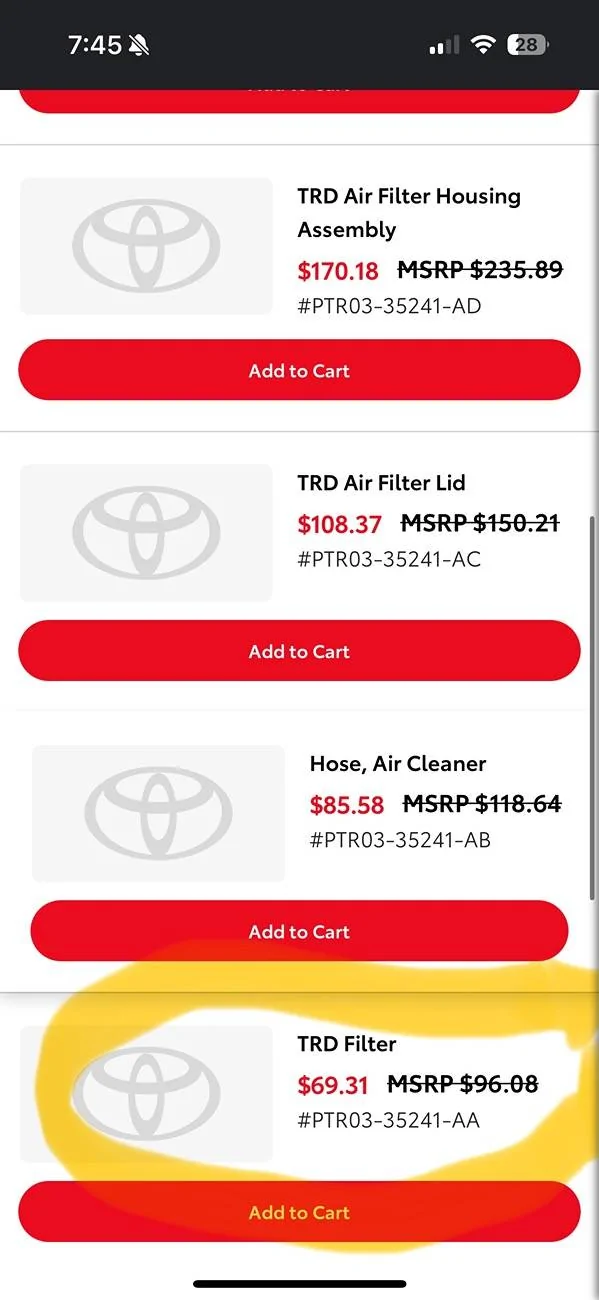

This filter is so strangely shaped, the air box is a complete pain in the ass to pull out filter and close on a Pro, clips buried way down.
..anyway, ordered a spare "K&N looking" filter from closest Toyota dealer I could during online Black Friday sale.... and... it's still not in. WTH!? Are they one offs only in Mexican factory (seemingly :sunglasses:).
I'd like to see aFe make a dry version... well, anybody to make a version at this point.
..anyway, ordered a spare "K&N looking" filter from closest Toyota dealer i could during online Black Friday sale.... and... it's still not in. WTH!? Are they one offs only in Mexican factory (seemingly :sunglasses:).
You need to unclip the MAS wire - opens up easy
