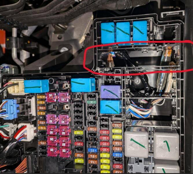

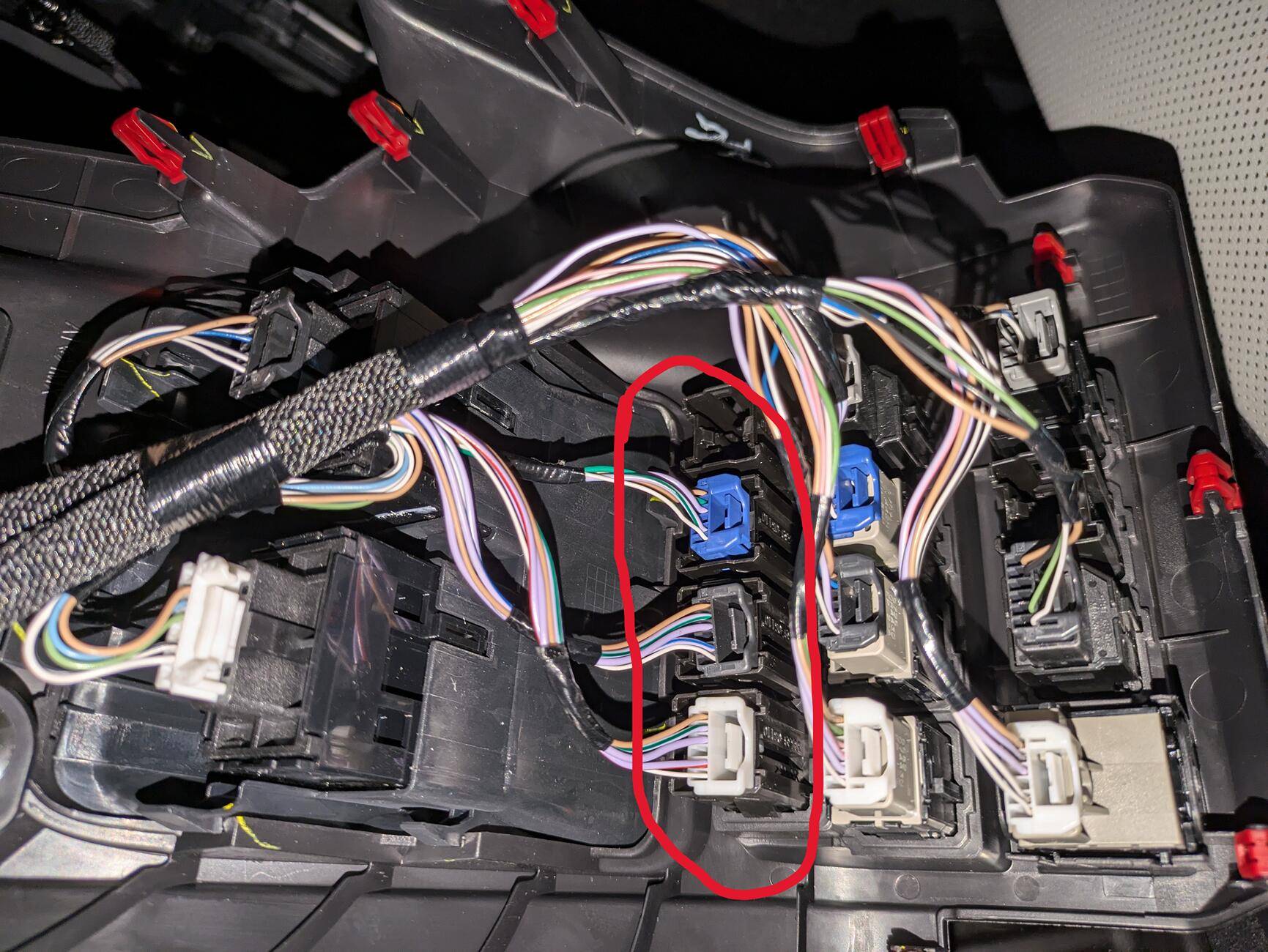

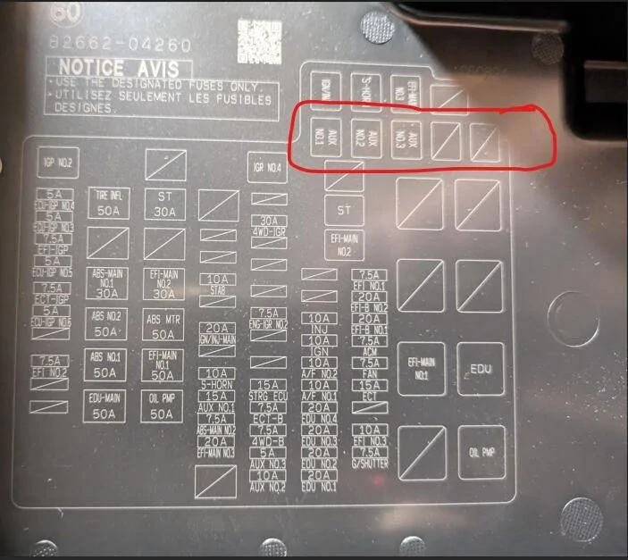

Can you post some photos to help illustrate? It appears that various vehicles are shipping in various partial support setups and I'm curious (as I am certain others are) at what point things exist or not and can be tapped into.
For my Limited Hybrid, no aux switches, but the wires to the plugs are in place, yet the fuses and fuse row are absent in the engine driver's box.
2024 Tacoma Trucks without factory aux switches 1728326475573-zq
2024 Tacoma Trucks without factory aux switches 1728326744741-w4
2024 Tacoma Trucks without factory aux switches 1728326837975-x
