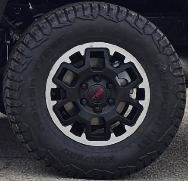

For those interested...
I did a tire swap at dealership at time of purchase. They gave me $500 for oem tires.
I had them install Nokian Outpost nAT
255 75 R17 onto oem wheels AND the spare wheel. Convenience spare was 245 75 so getting the new tire to fit on spare wheel wasn't an issue.

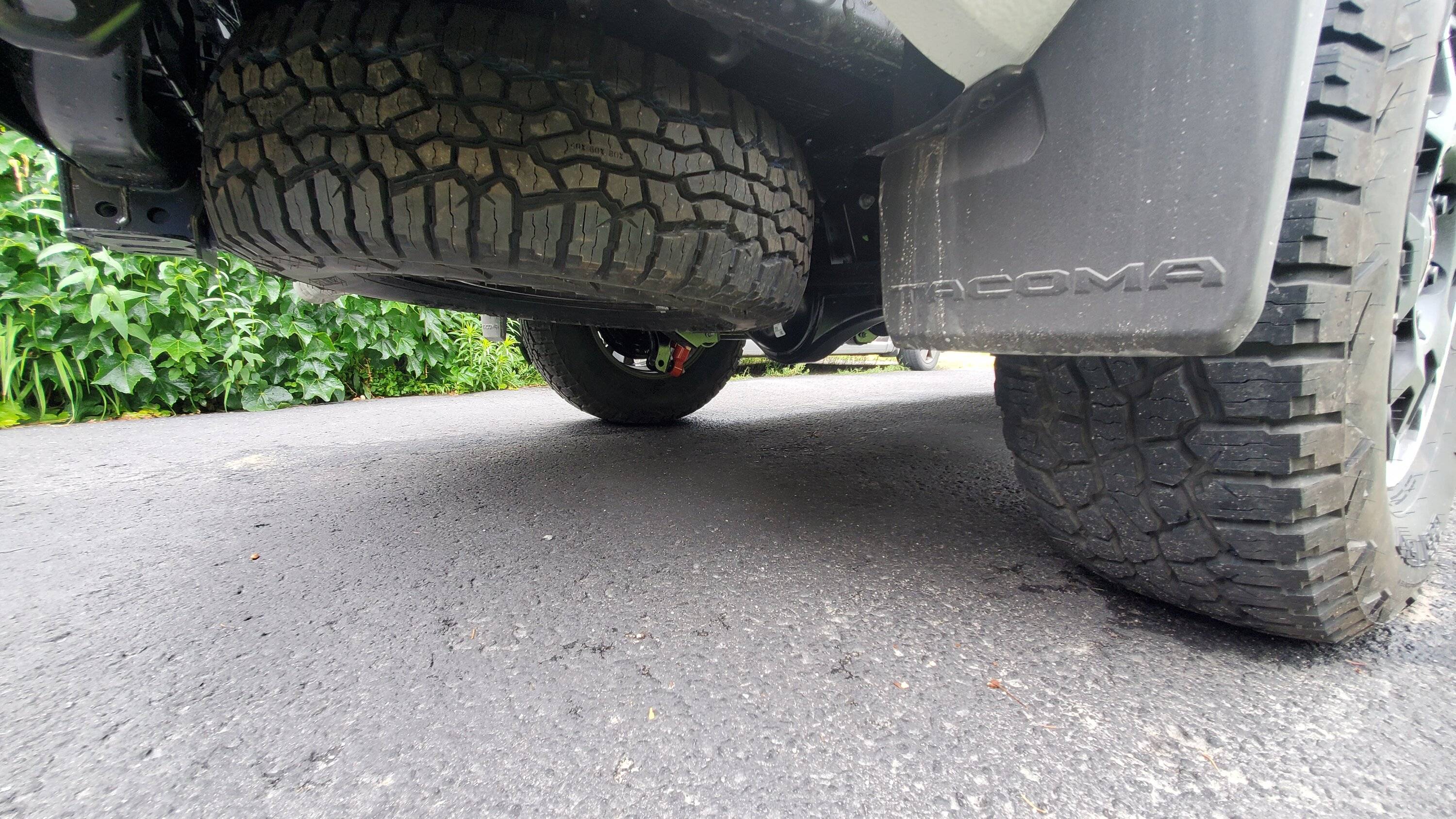

Had I gone with the popular 285 70..it wouldn't have fit the spare wheel (tire too wide) plus mounting to spare location would have impacted ground clearance quite a bit more than my pizza cutter.
This tire size is a tad larger diameter than factory tire about 1/2"..also known as a true 32" whereas factory tires 265 70 17 measures closer to 31.5".
Image of spare. Sits close to tow hitch receiver level and well above rear diff.
Is ground clearance affected..i think a little yes but it sure is nice to have a proper full size spare that I can trust vs that convenience spare crapola
