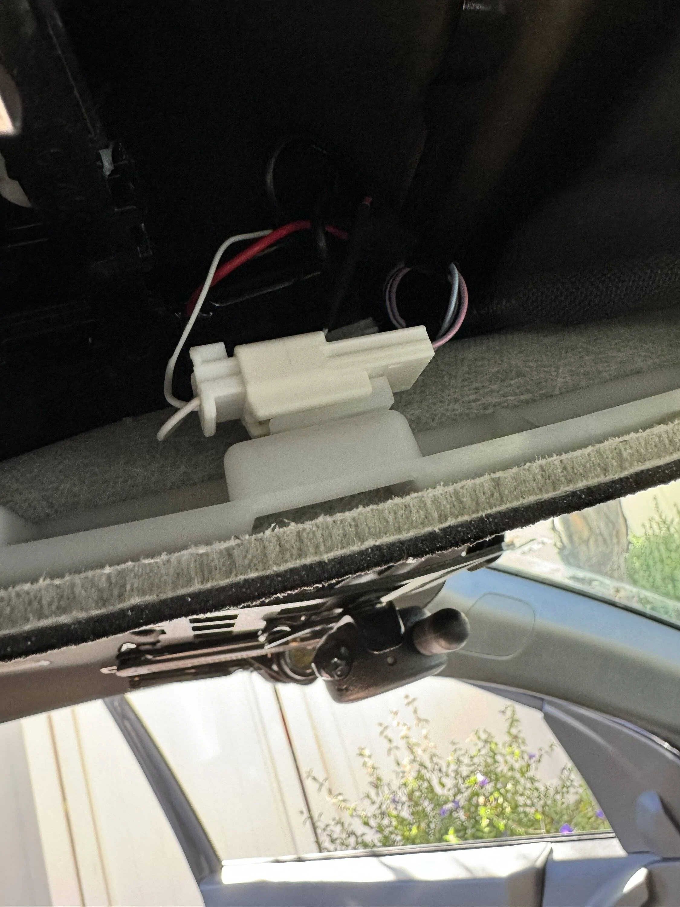

I know https://dongar.tech/ makes a solution but I wanted to make my own for less because I’m cool like that….
While I was waiting for my truck to arrive at the dealer, started doing some research. I wanted to find a dash cam hardwire solution. I found the new 4th GEN trucks are pre-wired with a pigtail to connect the OEM dash cam sold as an option for $500.
I ordered one part from AliExpress and another from Amazon.
I successfully hardwired my Viofo dash cam. Came out super clean.
2024 Tacoma Installed dash cam using factory pigtail connector IMG_3688
