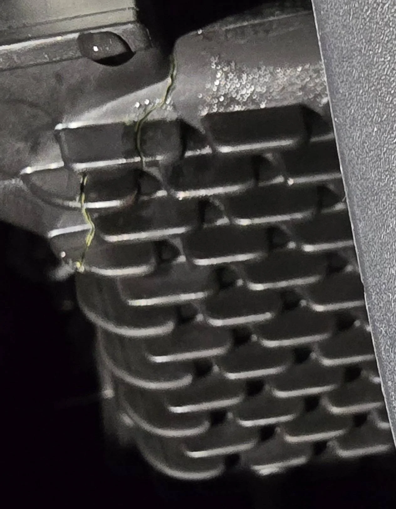

I appreciate the encouragement and maybe it will pan out well. And to think I came from a Jeep. At this point I don’t even know when this going to take place. They are waiting for TAS to tell them what to do and give them authorization to order the part. No idea how I drove for a week and it was fine and just develops a crack.
Ahhh that’s the problem you’re used to owning a Jeep 😂. Could have been a overtightened screw/bolt, stress crack, something not installed o lined up correctly… mass produced truck, promise it WILL BE BETTER than any Jeep‼

I mean that was the hope haha ….that being said I never had any issues with my Jeep 🤷‍♂️. They did show me a crack down the side of it where it was leaking. I’m not sure what is happening right now though. I have messaged a lot of people above service because I kind of have issue with this whole thing a week in. Likely this truck had this crack when it was sold to me so my issue is having to deal with a ripped apart dash on a truck that likely had this from the beginning. It’s just not a good way start so I was told they are looking at options whatever that means. Right now I am just waiting to see what happens in this situation.

Yikes..if that’s the air conditioning box on the drivers side behind the dash then the fix is to pull the entire dash off to replace the part. They had showed me a video of mine at the time where they stuck a camera up there but I don’t remember the exact way it looked at this point. I know they had to open up a case and I was told that mine was the first one they had seen that on. They opened up a case with Toyota to get approval to order the part and last I had heard about 2 weeks ago they had still not started pulling apart yet because they didn’t have the part yet.
