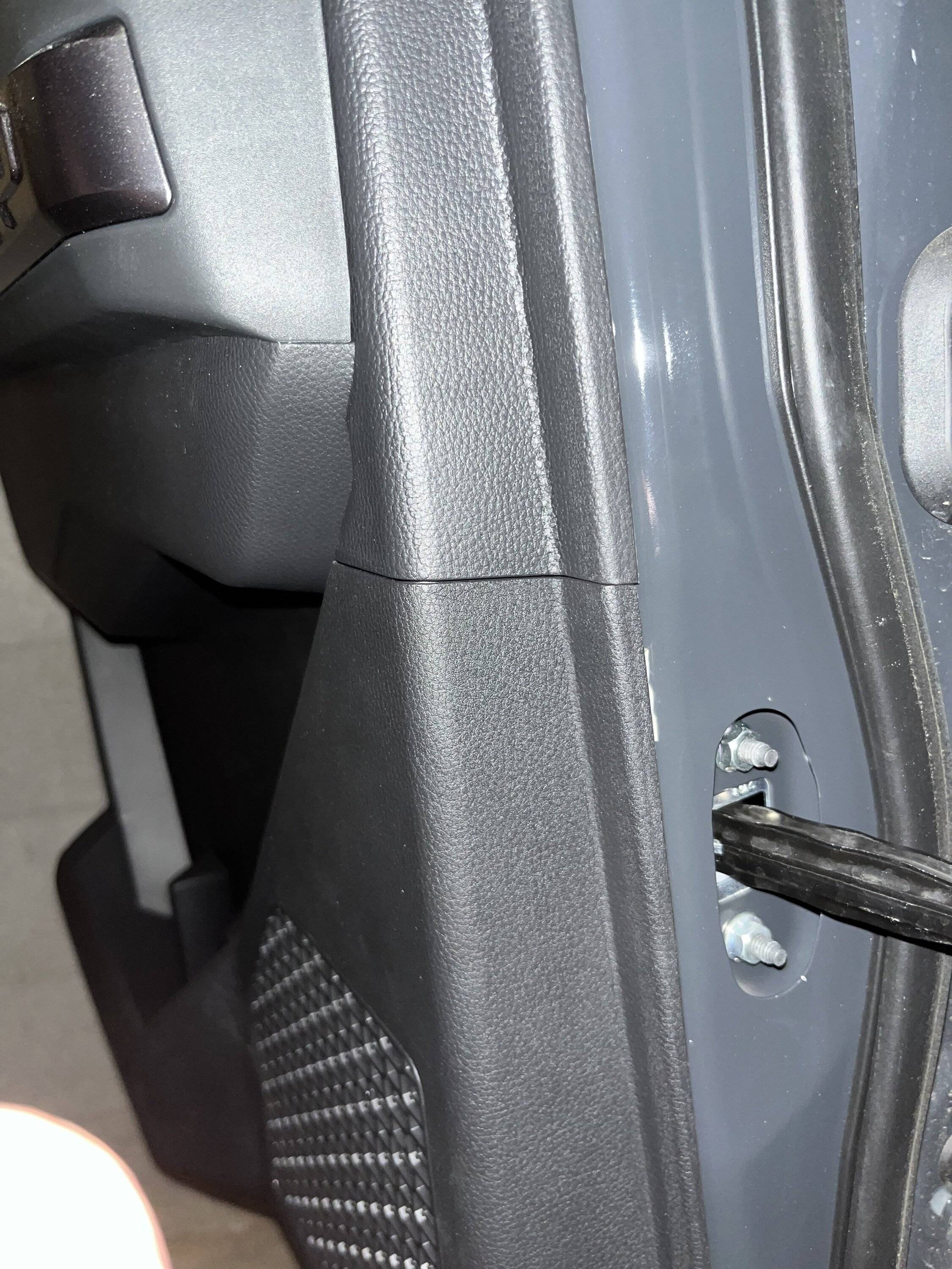

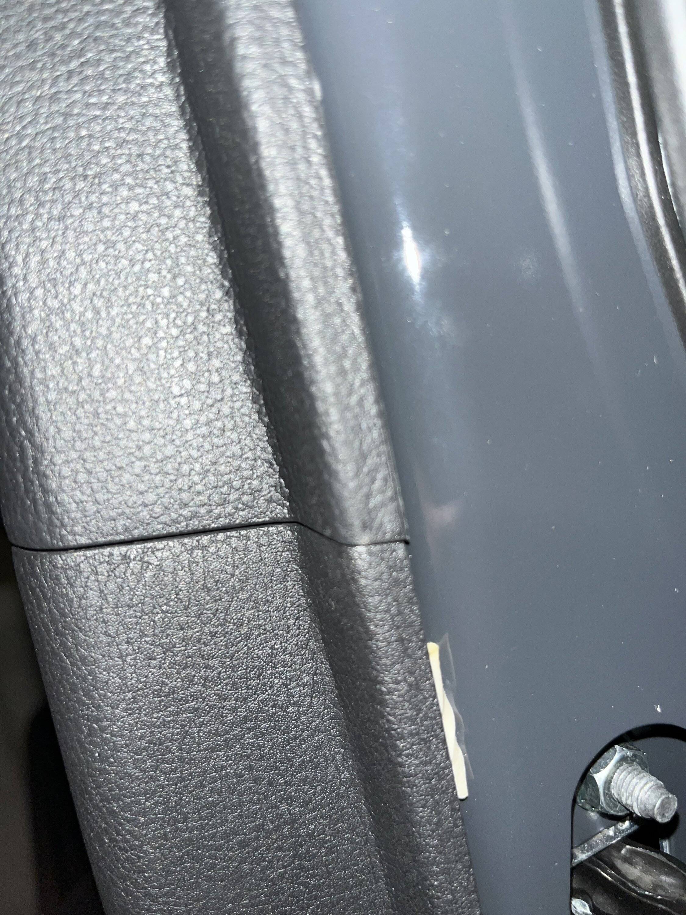

This is the precise location. Hope this helps.
Yes thank you for the pics. That’s the exact area and it stopped with cloth so I’ll be looking for something to put there permanent. Glad I could sort that out.
