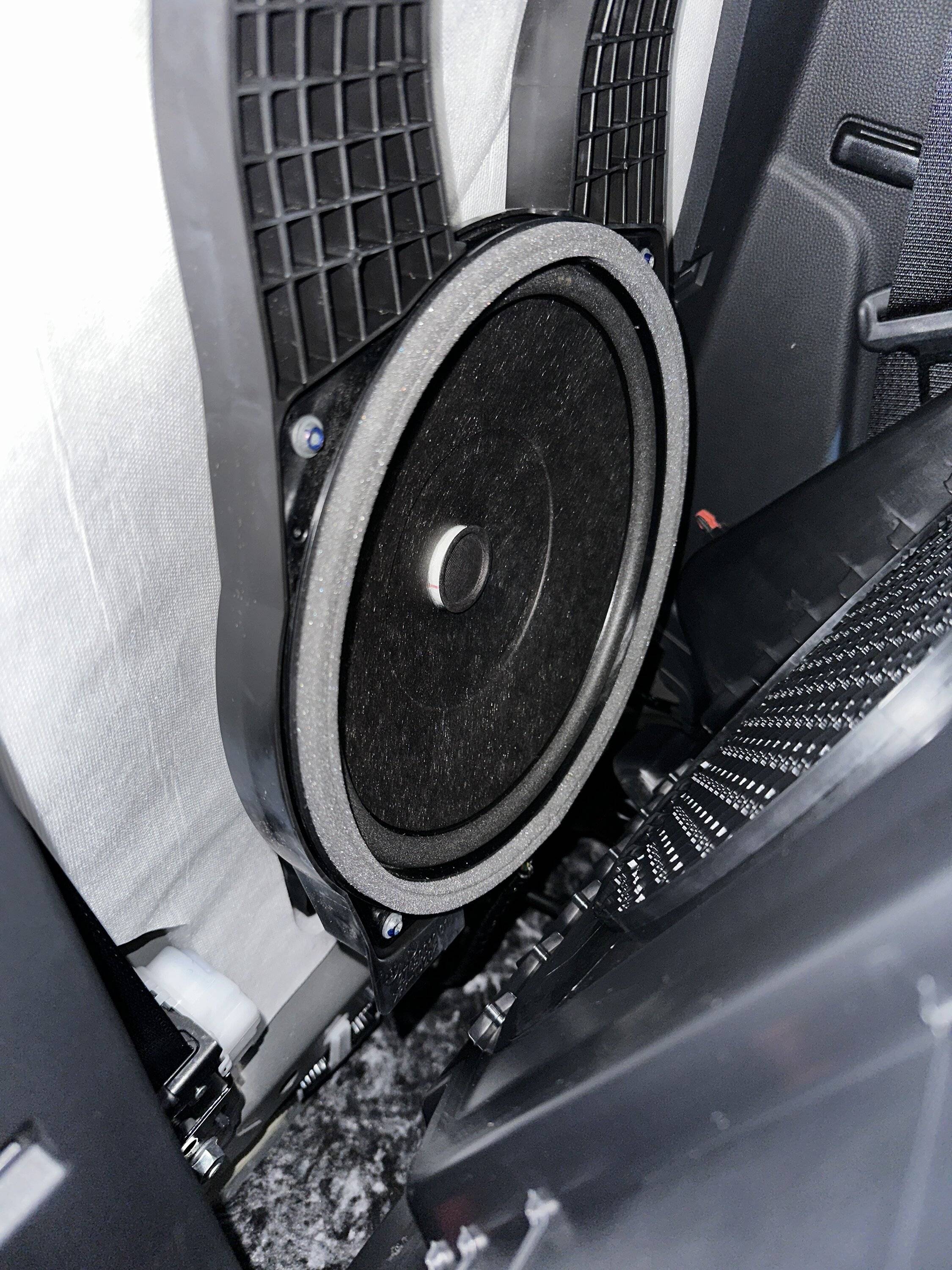

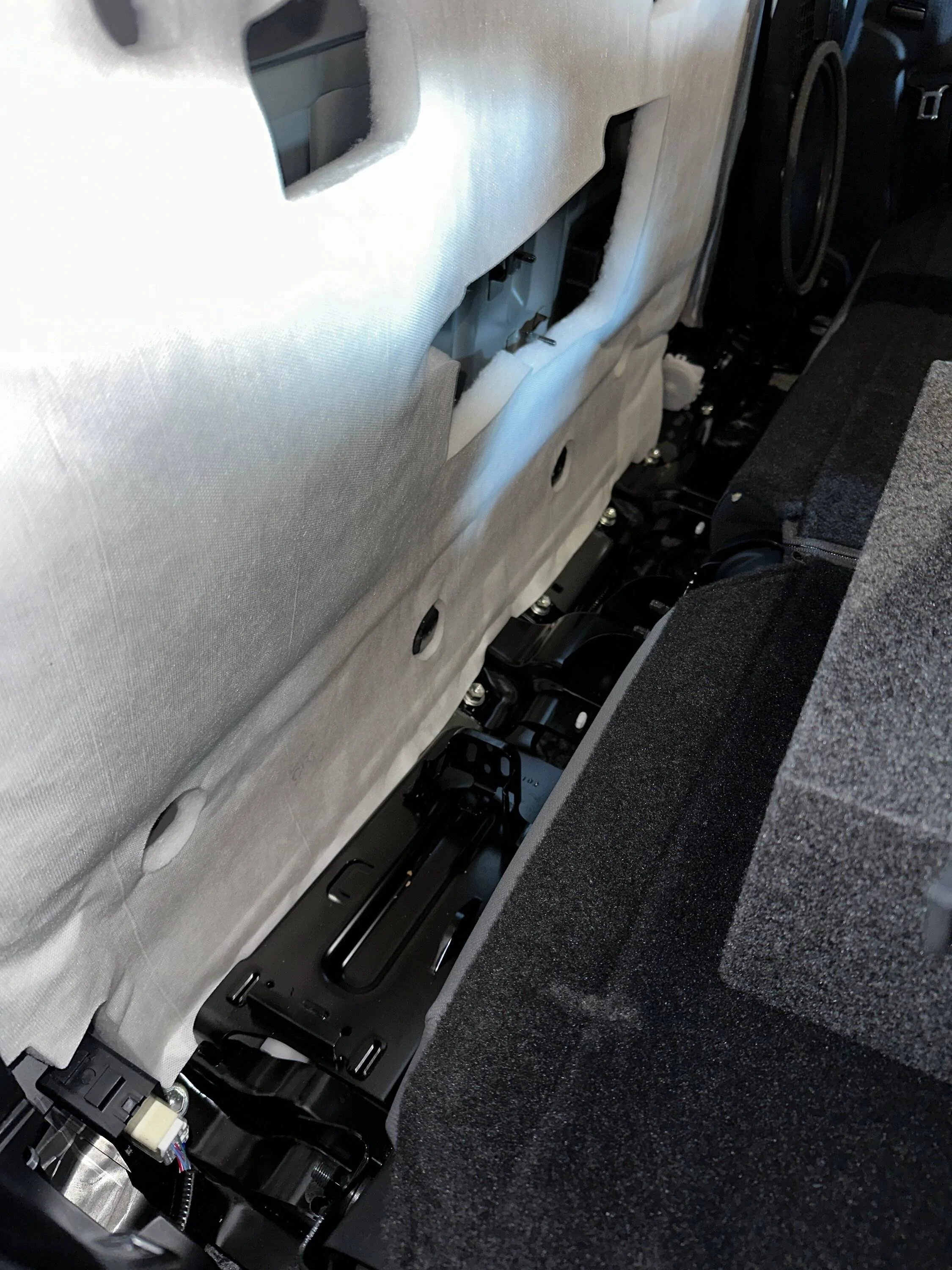

Before I even took delivery of my tacoma, I had plans on installing a 8" shallow mount subwoofer. In the previous 3rd gen tacoma, it looked like it was fairly easy to install a shallow subwoofer behind the rear passenger seat.
Unfortunately, that's not the case with the 4th gen. The bottle jack mount is welded to the seat mount and doesn't have much room for a shallow mount 8" box.
I'm disappointed with the factory JBL subwoofer enclosure. The enclosure has basically no volume to it. Looks like i'll have to find a shop to make me a custom enclosure to replace the factory JBL 10" subwoofer. Any other thoughts/recommendations?
