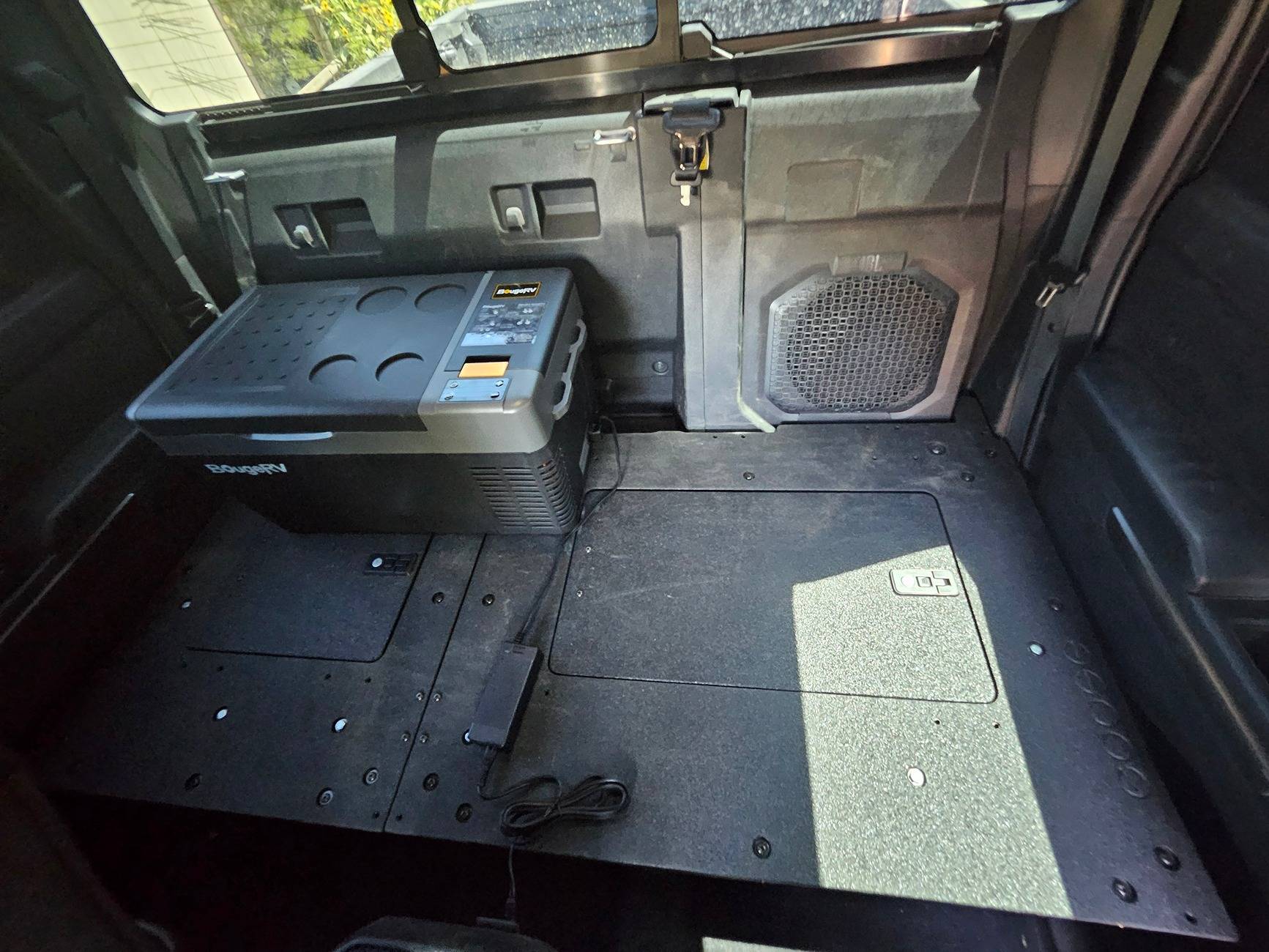

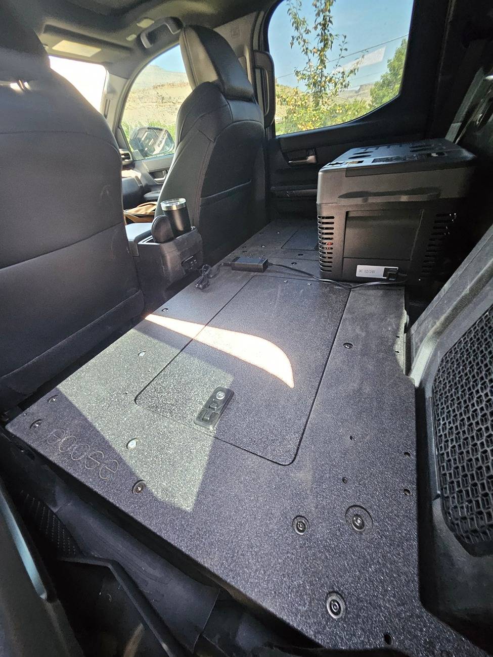

One of the big reasons I chose nonhybrid was for increased cab storage. This unit in my truck is preproduction. I would have ordered an extended cab but this is better. There is massive volume under those hatches and I now feel that I dont need a bed cover or drawer system because everything fits inside. The tubs were left in the truck and there is one internal devider if you only wanted to delete one side.

The company Goose Gear will be releasing these at some point. They still have some cool tricks up their sleeve to try out. When the sun gives me a break I will get some below deck pics.
