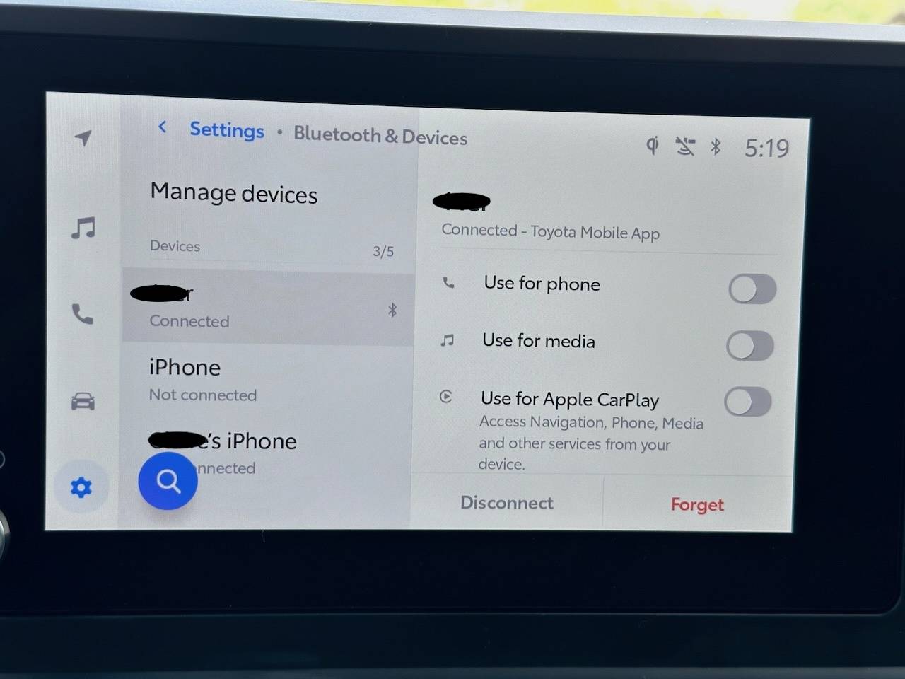

I’m constantly having problems with my phone connecting to the truck. Every other day I need to “forget” my phone from the truck and then re-pair the both. When the phone wont automatically connect to the truck, even using the cable also will not let me use CarPlay.
Also when I remote start the truck, my phone will not connect to the truck once I get in the car and I will have to “forget” and then pair truck and phone again.
Am I doing something wrong? Are there any settings I need to change in my phone? I’m coming from a 2011 Tacoma with manual windows and locks and I had to use an AUX cord to listen to my phone, so this is all new to me lol.

mine wont let me do this. The slider will immediately jump back.
Watch that screen that will list your phone and might say it is not connected. If an iPhone be mindful of WiFi enabled.
Removing some of the phones that were set up seems to improve this but reality is this vehicle firmware really shows signs if an update needed. Beyond my experience already noted, my business unit in the enterprise has around 200 mobile deployed and is makes it really clear what they connect to makes a difference. CarPlay in our VW is not perfect but better. A lot with that car improved after a firmware update.

Earlier here or Tacomaworld or both I documented and other agreed there's a problem where you have to go into bluetooth settings and re-enable CarPlay.
My testing was different versions of phones and OS. Same careful methods used in my day job. Most of the time you don't have to delete and re-add devices. You have to go into the vehicle bluetooth settings for your phone and touch the slider button.
that’s what I have to do after remote starting from the app. Seems to change the settings on the saved phone for some reason.
