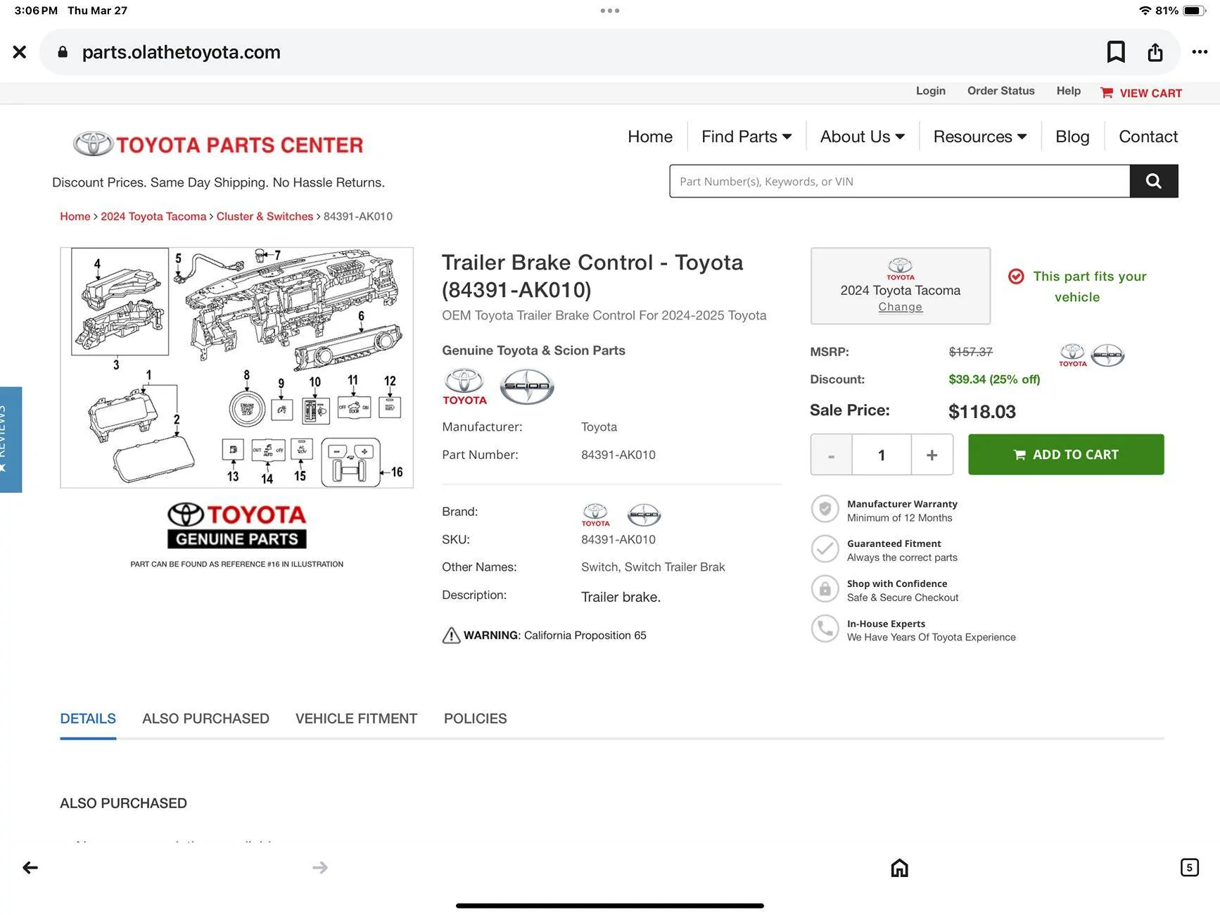

Thankfully the lightly used 2024 Tacoma I bought had the trailer brake controller in the package, otherwise I would have been subject to the same level of frustration that you guys are experiencing.
However… I was just thinking, what are the chances that, assuming your truck has the 7/4-pin plugs in the back, that you could buy the trailer brake controller itself and install it in the lower instrument panel AND that the wiring is there to plug it into? It looks like the part is readily available and only $118 from Olathe Toyota. I don’t know if the wiring is behind the panel, but if I was in y’all’s position, I’d be taking a look. If it is, just buy the OE Toyota controller and call it a day.
This #16 in the diagram below.

Wiring is not behind the panel. Spent 2 hours at Texas Trailers this morning with them hunting everywhere for the wiring. They finally found the blue brake controller wire (goes to the 7 way) dead ended at the fuses. Everything would have to be rewired which would probably void our warranty.

From what I see this is just the part not the wiring.
