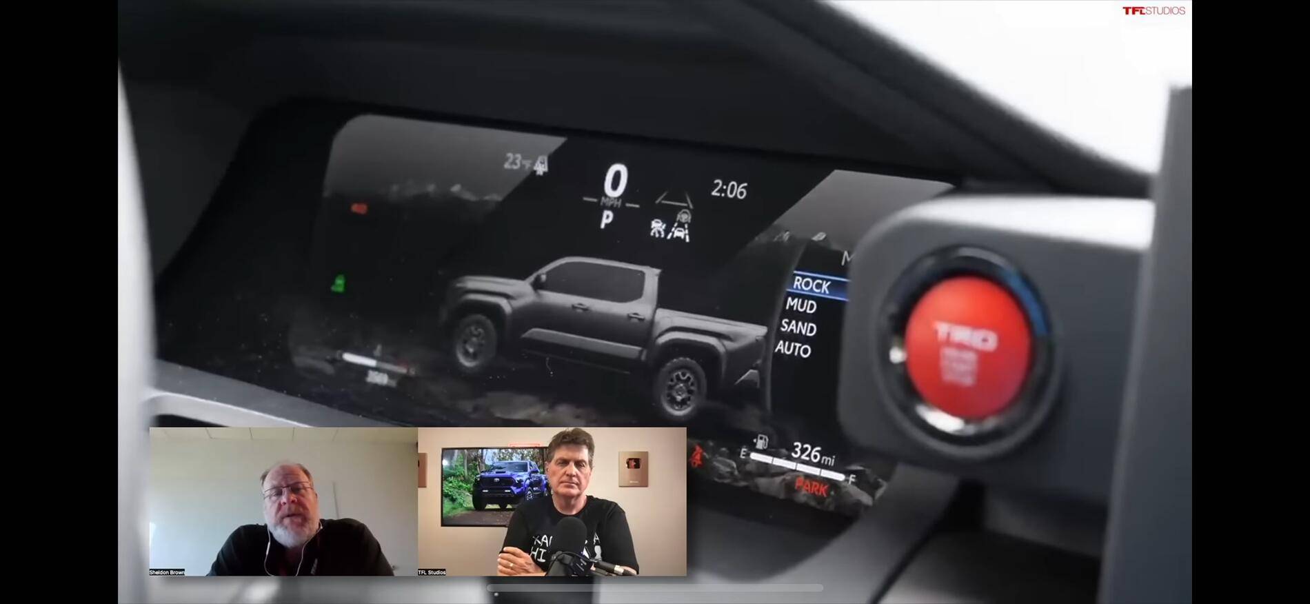

Well that’s not it. TFL’s pickup didn’t have MTS deep snow available while in 4-lo. OP said he was in deep snow the whole time, I’m guessing but it probably kicked out of deep snow when he went from 4-hi to 4-lo?? They did say ALL hybrids rolled out with the software update.
Screen shot from their video.

Great catch. I wish I could go hop in and check if it had it available… now I’m not so certain. If it did kick, what to- auto?
