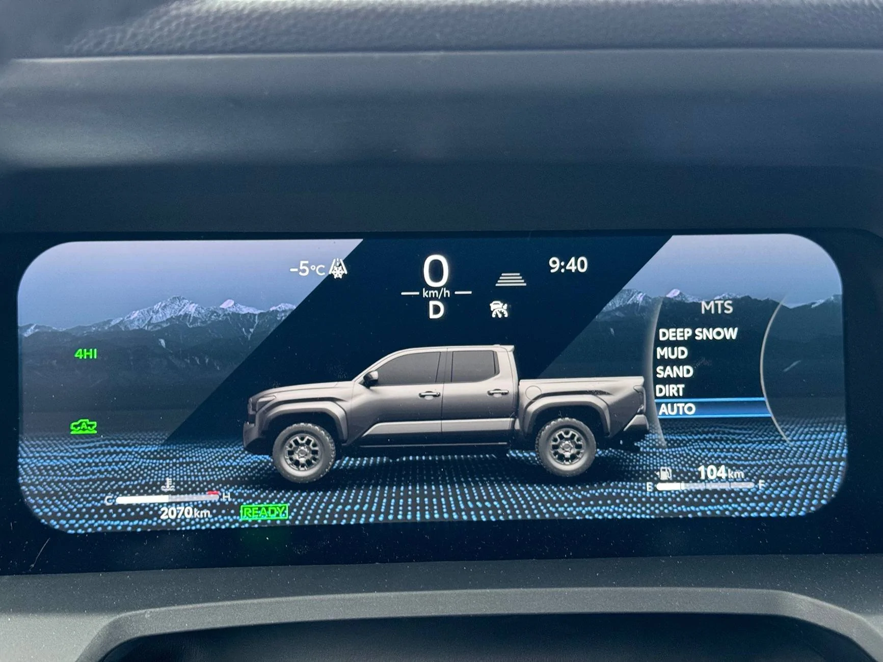

To bring this back up… my 2025 has deep snow as an option on MTS, I thought it was removed?
2024 Tacoma BROKE MY TRUCK (ADD? Same issue as TFL?) IMG_4758
