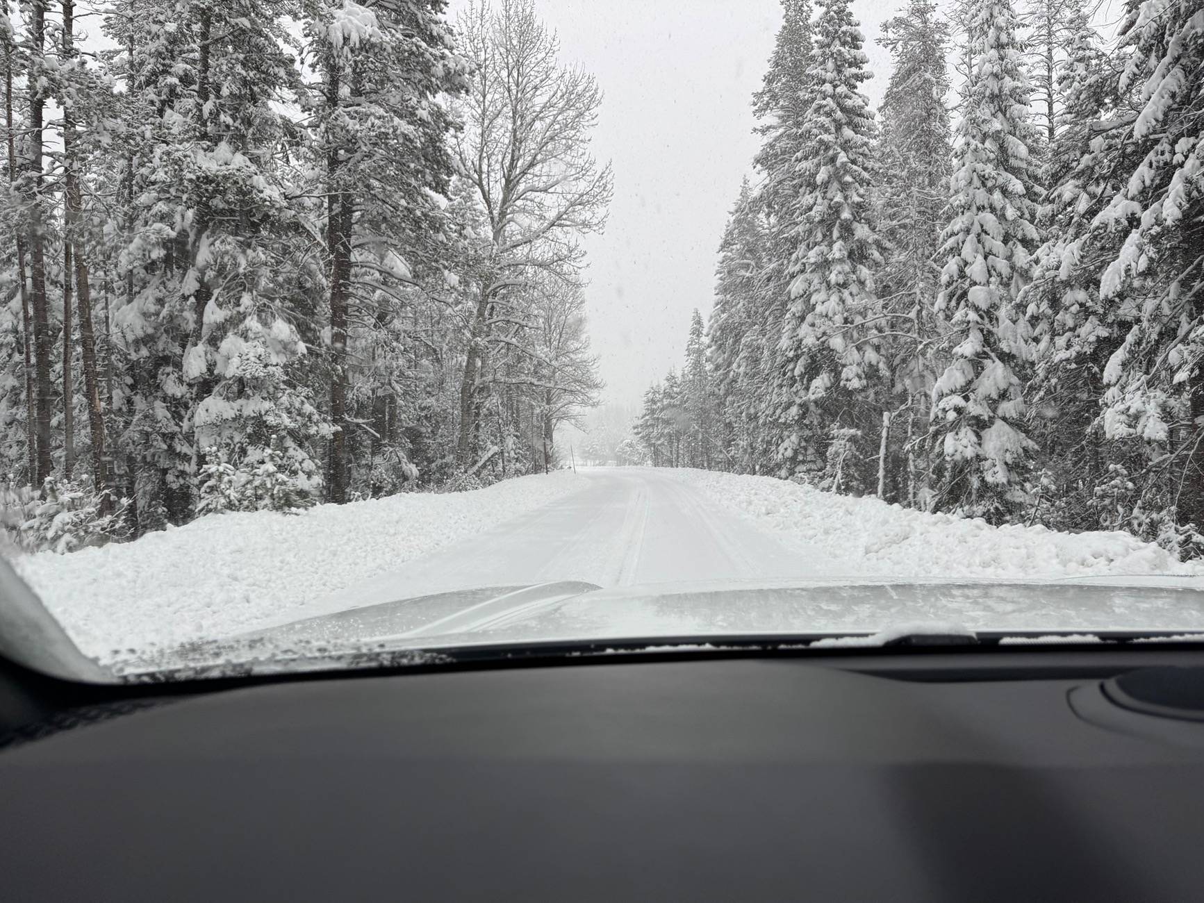

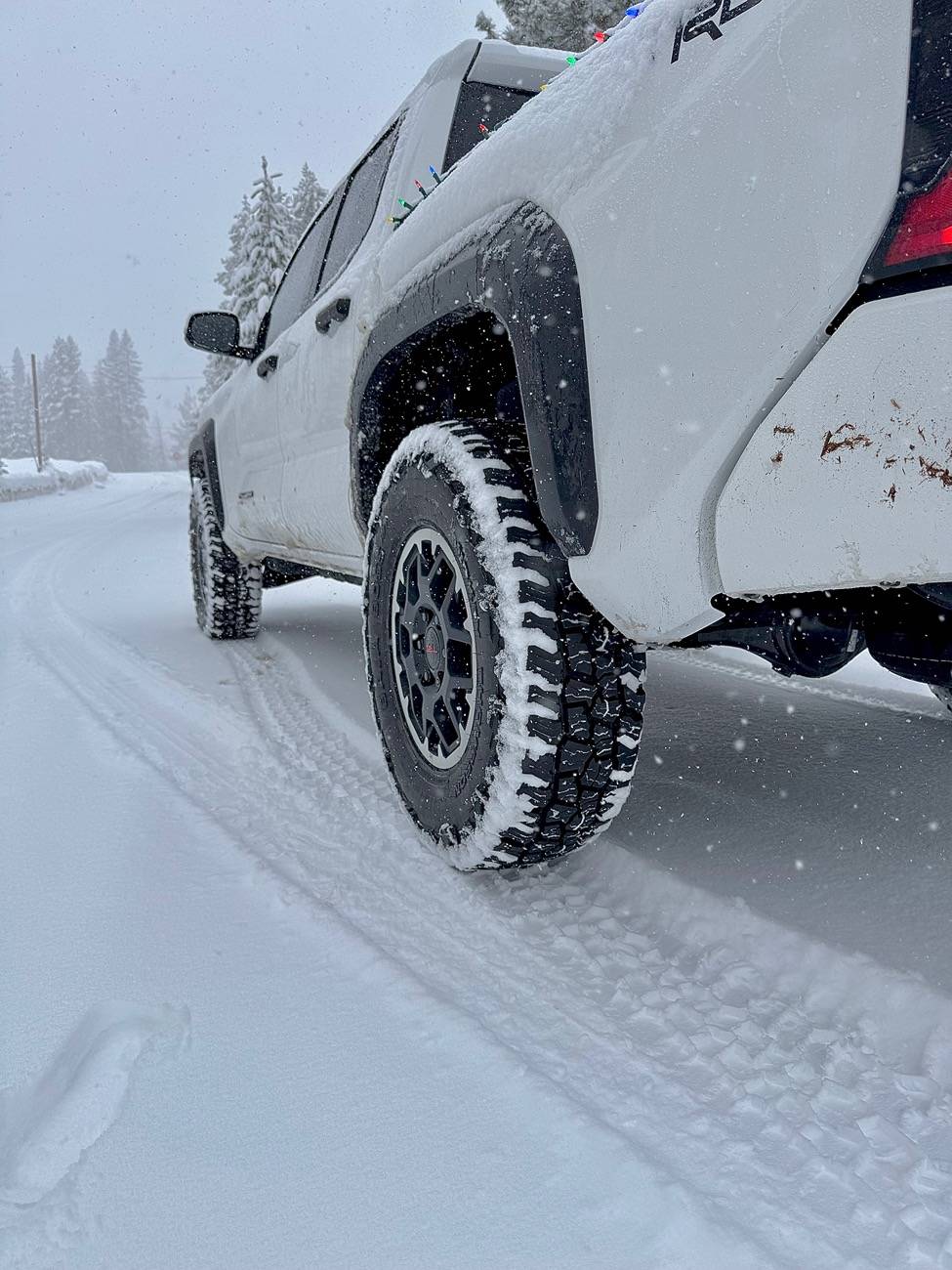

So you can drive over 60mph in 4wd? I always get on the on ramp and turn it off when I get on the highway.... I always thought over 60mph would damage something? The highway where I live gets super icy sometimes but I always turn it off
Absolutely fine. I was in Lake Tahoe a few weeks ago during a crazy snow storm. Had it in 4hi through the mountains at speeds Well over 60mph. I wouldn’t even think twice about trying to do that in 2wd. This was what some of the roads looked like:
