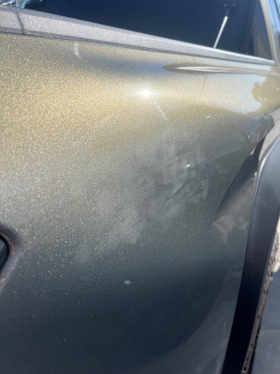

I used a rubber wheel to remove the OffRoad decals from the sides of the truck but there is some noticeable discoloration now if the sun hits it just right.
Trying to figure out if there is some residue left that I need to take off or if I stripped some of the exterior protection and just need to apply some wax.
Thanks

Try a mild compound (mild!) with a light cutting pad (orange), and a dual action polisher on medium speed. That should remove anything remaining, just keep in mind it cuts the clearcoat a tiny but.

It is either a bit of residue left, or the clear coat is cloudy from over heating (friction from the rubber wheel)
I would try some adhesive remover first, just in case it is residue.
If that doesn't work, then go with MustardTiger's suggestion.
I always like to start with the least invasive method.

I would go with @MustardTiger's suggestion, but doing what @max911 suggests can't hurt anything and would clean off any debris from the rubber wheel.
You just have to hope that is damage to the clear coat and not areas where it is gone. Good luck and let us know what happens.

I used some GooGone but it didnā€™t make much of a difference. Iā€™ll go with @MustardTiger suggestion. Worst case scenario, Iā€™ll just put new stickers back and pretend like nothing happened :)

My body and fender guy says he doesn't use a buffing wheel on new Toyota's anymore. The heat can eat thru the water based clearcoat and thin paint to bare metal in 30 seconds. Be careful. (He also knows I'm more like a bull in a china shop than an artist.)

I removed mine with just my thumb and some bug and tar remover after seeing multiple accounts of people hit it too hard with a rubber wheel.

Hitting it with the DA with mild compound and an orange pad seemed to do the trick. Thanks all. Likely wonā€™t be doing this again in the future with the rubber wheel.
This is a couple hours after I cleaned up that section.

All is well looks good. I got lucky. Day one let sit in the sun. Peeled right off in 2 minutes no residue left but a little white piece my thumb rumbling got it up.

yeah that leave it out in summer sun works well for the badges as well but use some fishing line between the paint & badges , the fishing line cuts the adhesive like a cheeze cutter šŸ˜Ž

I was impatient and after a week of no sunny days, I decided to take matters into my own hands. Learned my lesson.
