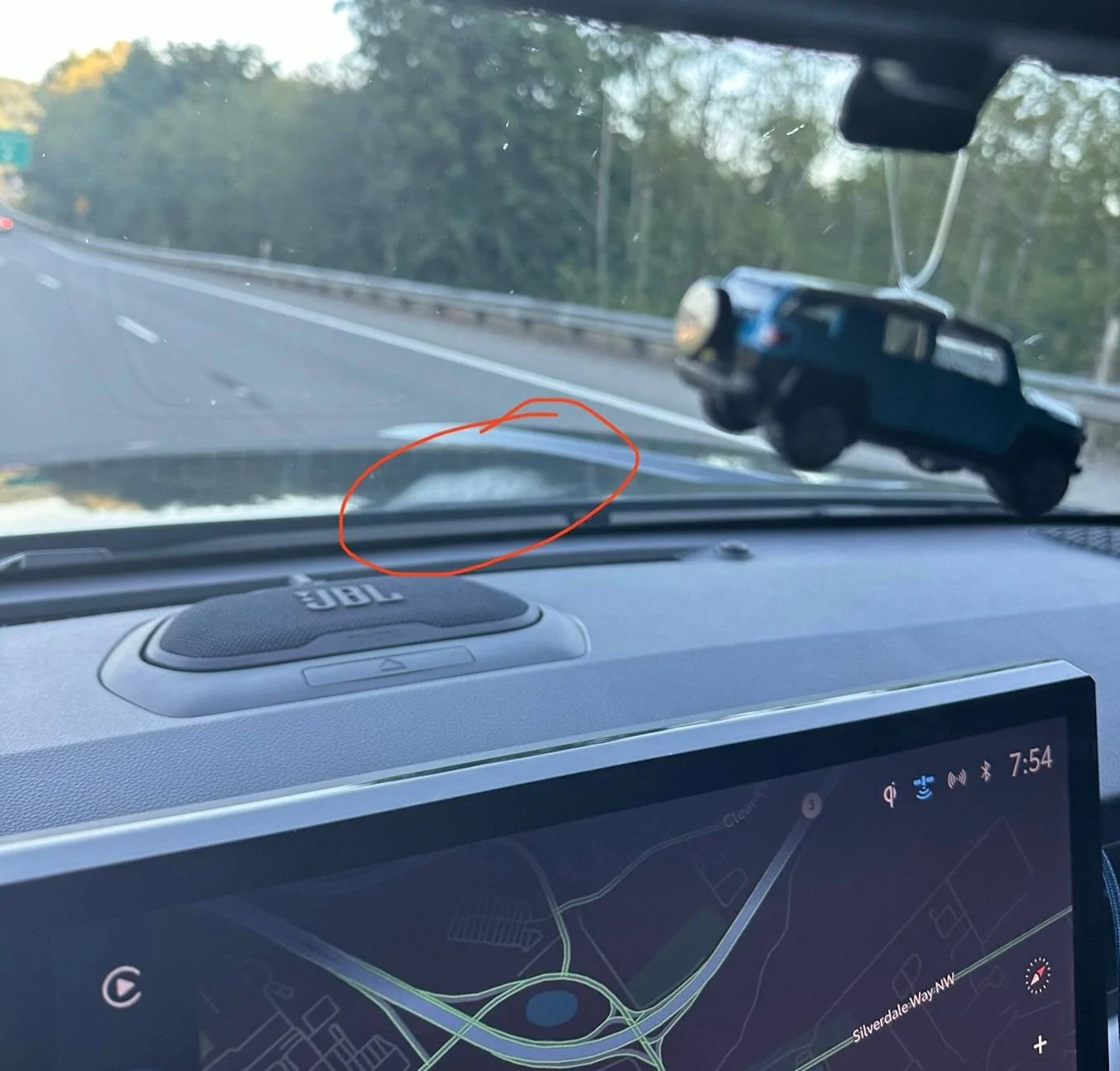

My defect is exactly in the same spot and the condensation is how I was made aware of it. Happened at around 3100 miles.

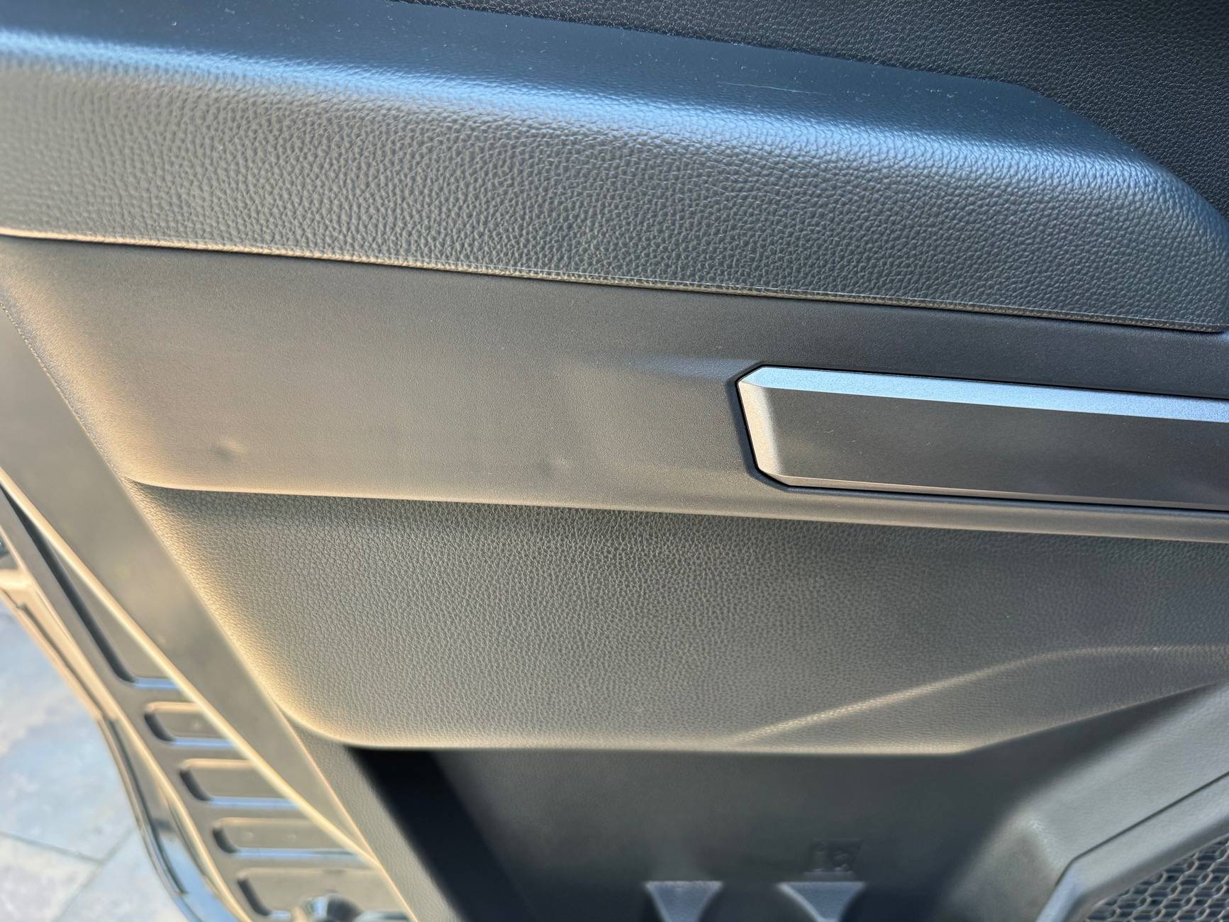

Rear door panels injection molding dimples
Glad Iā€™m not the only one. But sucks - I hate having the dealership messing around trying to fix things. It usually opens up a wormhole. šŸ˜‚
Seems they are all raising up off windshield in that exact spot. I just wish I noticed that rear door window seal at the same time because I have to call the dealership for the second time this week. I am patient and will let the warranty cover everything. Love the truck so much and like you hope this is a ONE TIME replacing defective parts and done deal.

It seems obvious it has moisture in there and that is not a minor issue IMO.

But itā€™s not solely esthetic- I get condensation on the outside of windshield exactly where my defect is. This pic was taken midday at 75 degrees. Not too hot not too cold. Happens every day.
I have the same problem with condensation in that spot of the lower windshield.My truck is sitting at the dealer for 3 weeks and counting for the cracked evaporator box issue.
Mine started lifting up in the same area. I have to agree that I think it's mostly cosmetic although I guess maybe a tad bit of engine heat could be escaping? I used some trim tools and got that area lifted up, then put a thick application of clear silicone under it. Wiped the excess and then sat a couple 10lb dumbbells against it for 24hrs. Nice and flush again for now. Haven't had any odd condensation either before or after.
While I had the strip lifted up, I found that the plastic underneath sits very tightly against the windshield, that's why I'm also kind of voting cosmetic but I really have no idea.
Edit to add that dumbbells also fixed my rear bed caps coming up at the front. A 25lb on top of each for 24hrs got them flush against the bed. Over 2 weeks now and they haven't budged, fingers crossed it stays that way.
This was my exact thought process and plan b if the dealership told me it was cosmetic and not to worry. The technician that called Toyota to confirm warranty replacement was told it was a known issue and advised to order new windshield cowl. Now I will say this if it raises up again on the new cowl I might be doing a lil silicone and dumbbells in my own bat cave. Nice work and great tips with the dumbbells as weights.
