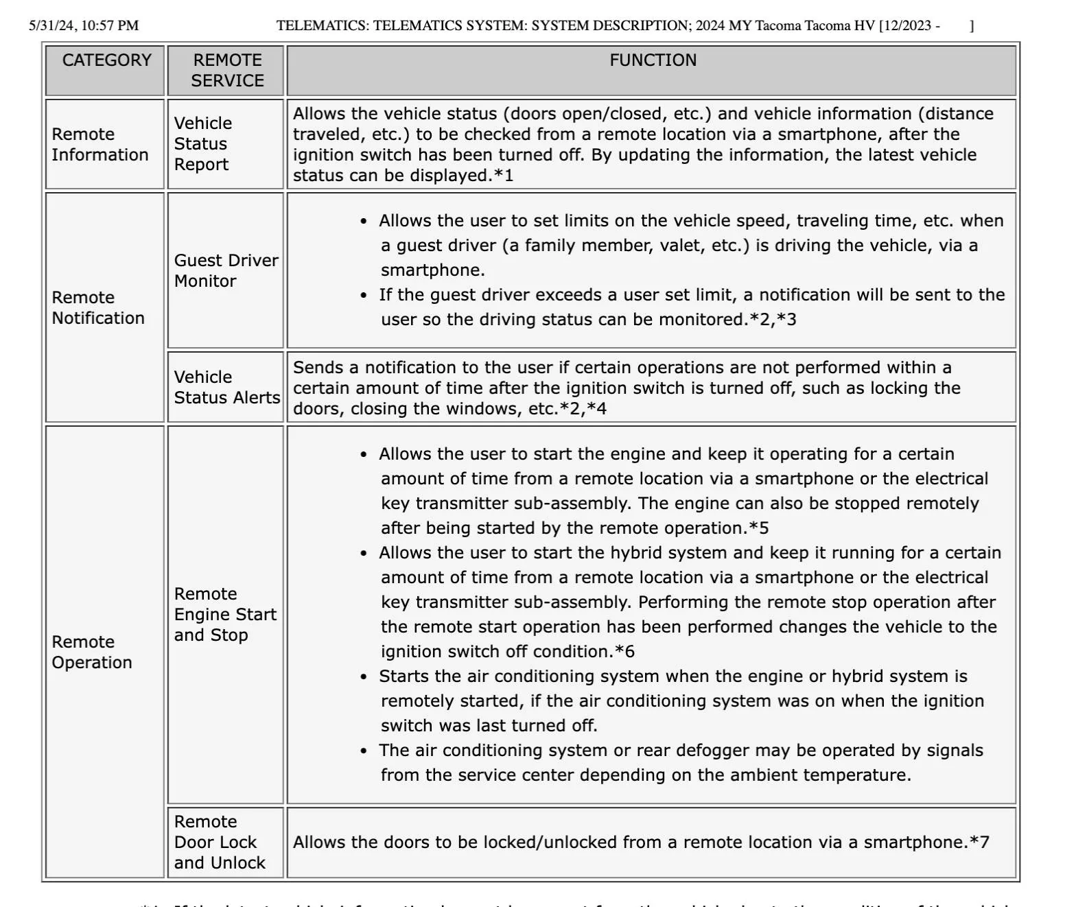

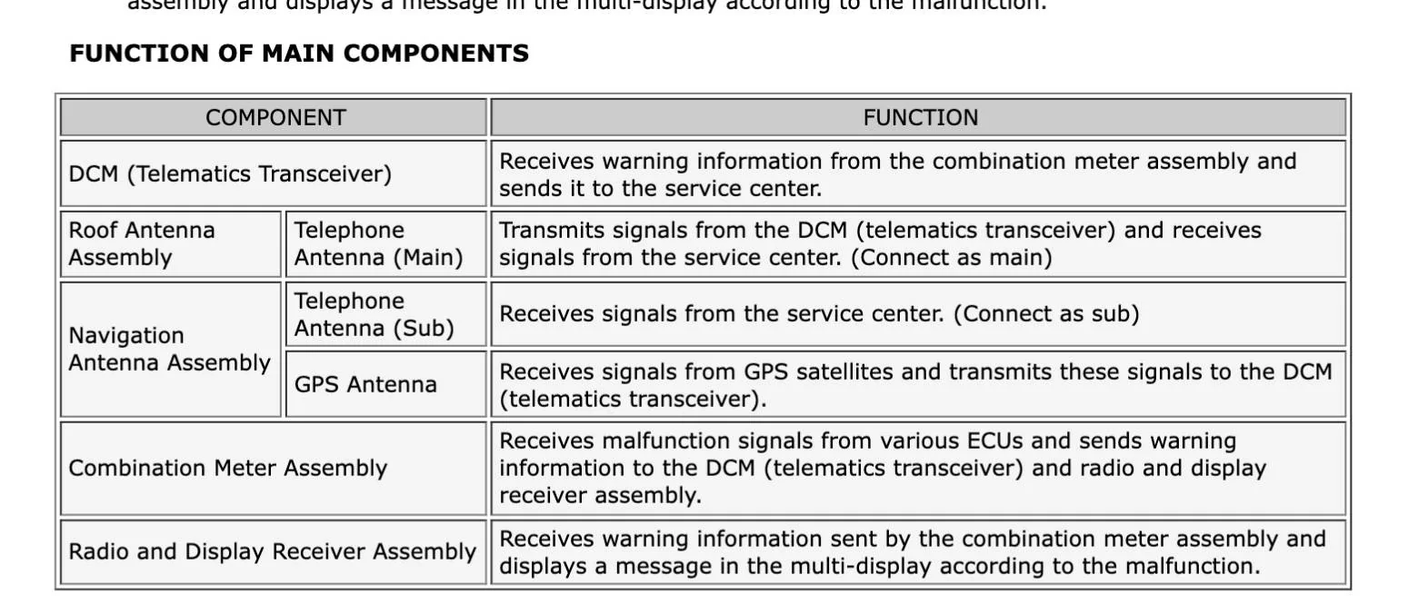

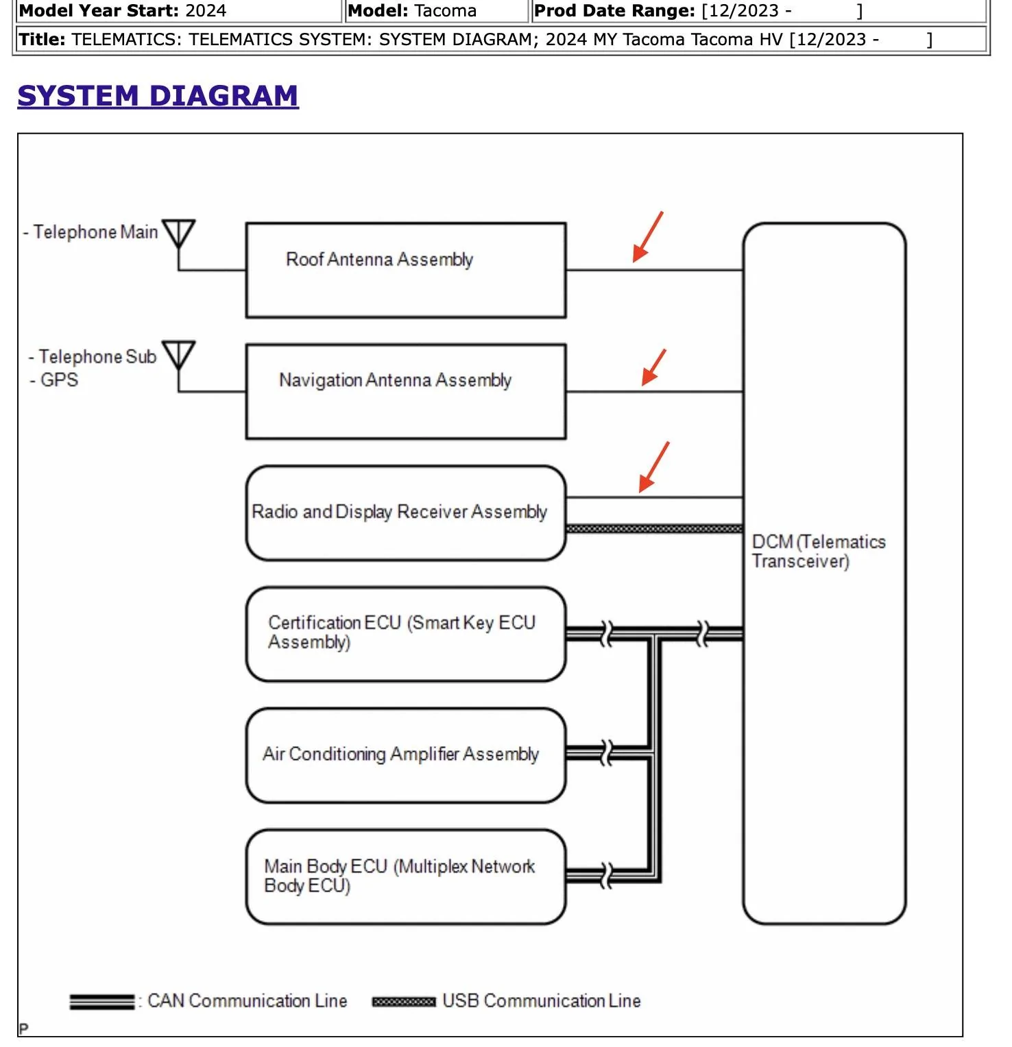

I Refer you to the 2024 service manual where it says:
2024 Tacoma disabling DCM / telematics in 2025 Taco aaaa
2024 Tacoma disabling DCM / telematics in 2025 Taco bbbb

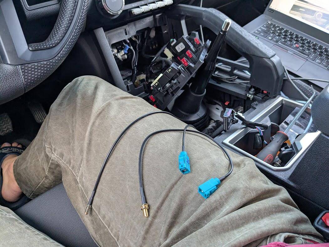

I purchased three 'Fakra Z Female to SMA Female Vehicle Antenna Adapter cables' and some 50-ohm SMA terminators off Amazon. The square Fakra Z shells on the jumper cables need to be removed leaving just the inner coax connector, becuase the Fakra shells are are too Fakrin' wide to fit into the Toyota DCM. Do this carefully so as not to damage or bend the inner coax connector fins.

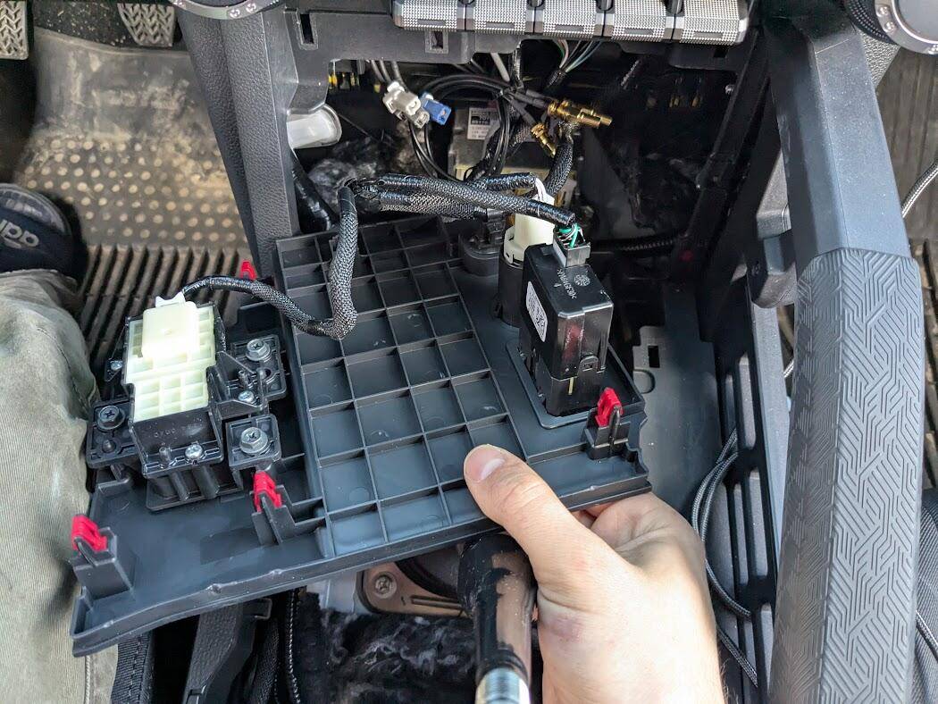

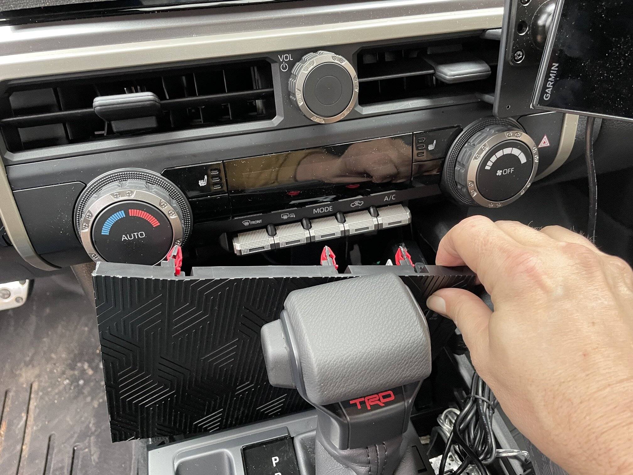

Accessing the DCM is easy; the panel holding the phone shelf/Qi charger basially pops forward and unclips. Once loose it can be pivoted to the right allowing acess to guts of the console. The DCM is front and center.

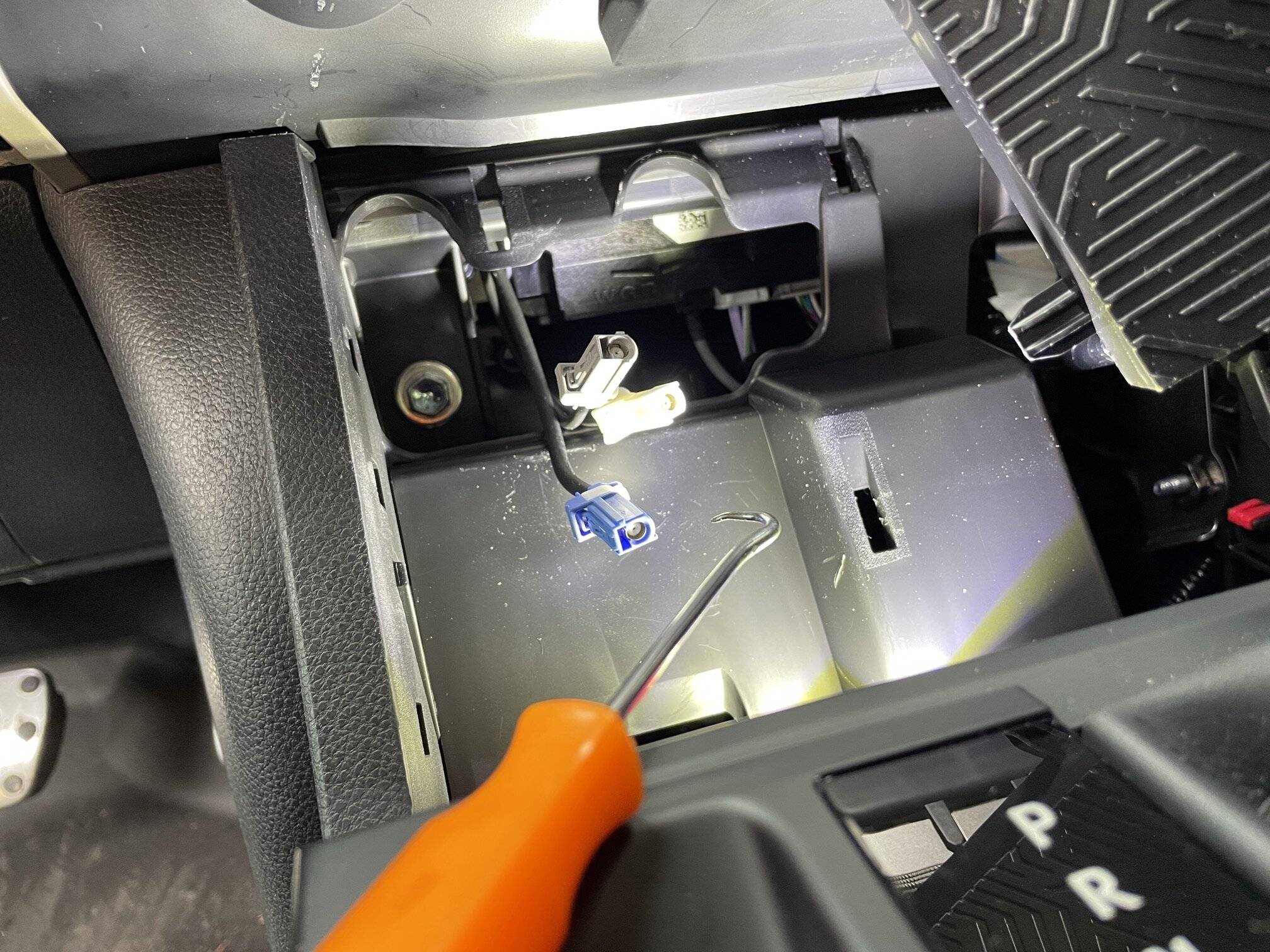

The antenna leads are on the left:
2024 Tacoma disabling DCM / telematics in 2025 Taco ant
The latches for the connectors are at the front. I suggest using a right-angle tool such as a pick to push the latches inwards while tugging gently on the cables. They pop out easily.

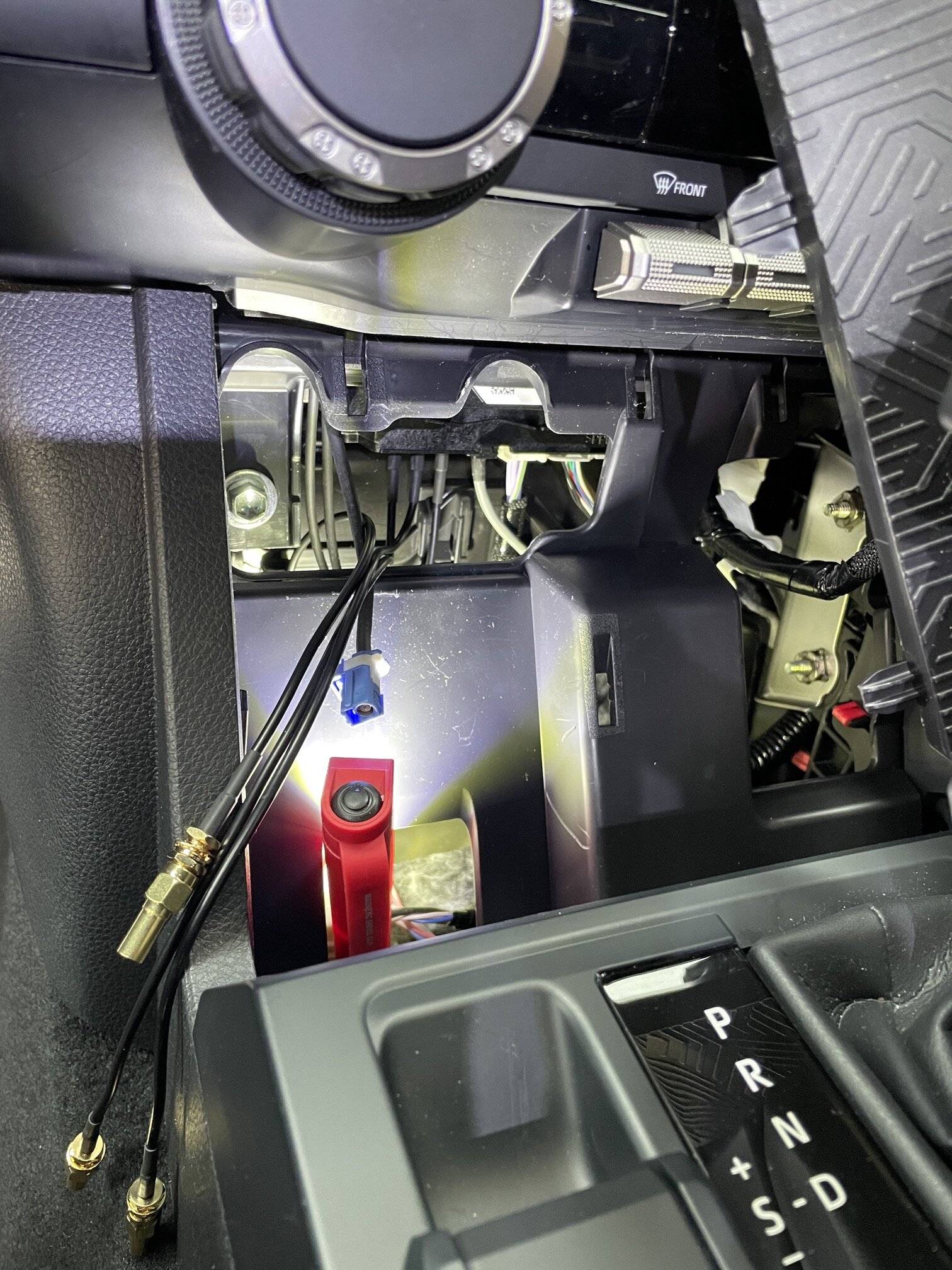

Install the terminated jumpers into the three DCM sockets you just freed up. The connectors have a slight interference fit so they won't easily fall out.
2024 Tacoma disabling DCM / telematics in 2025 Taco 8_IMG_8368.JPG

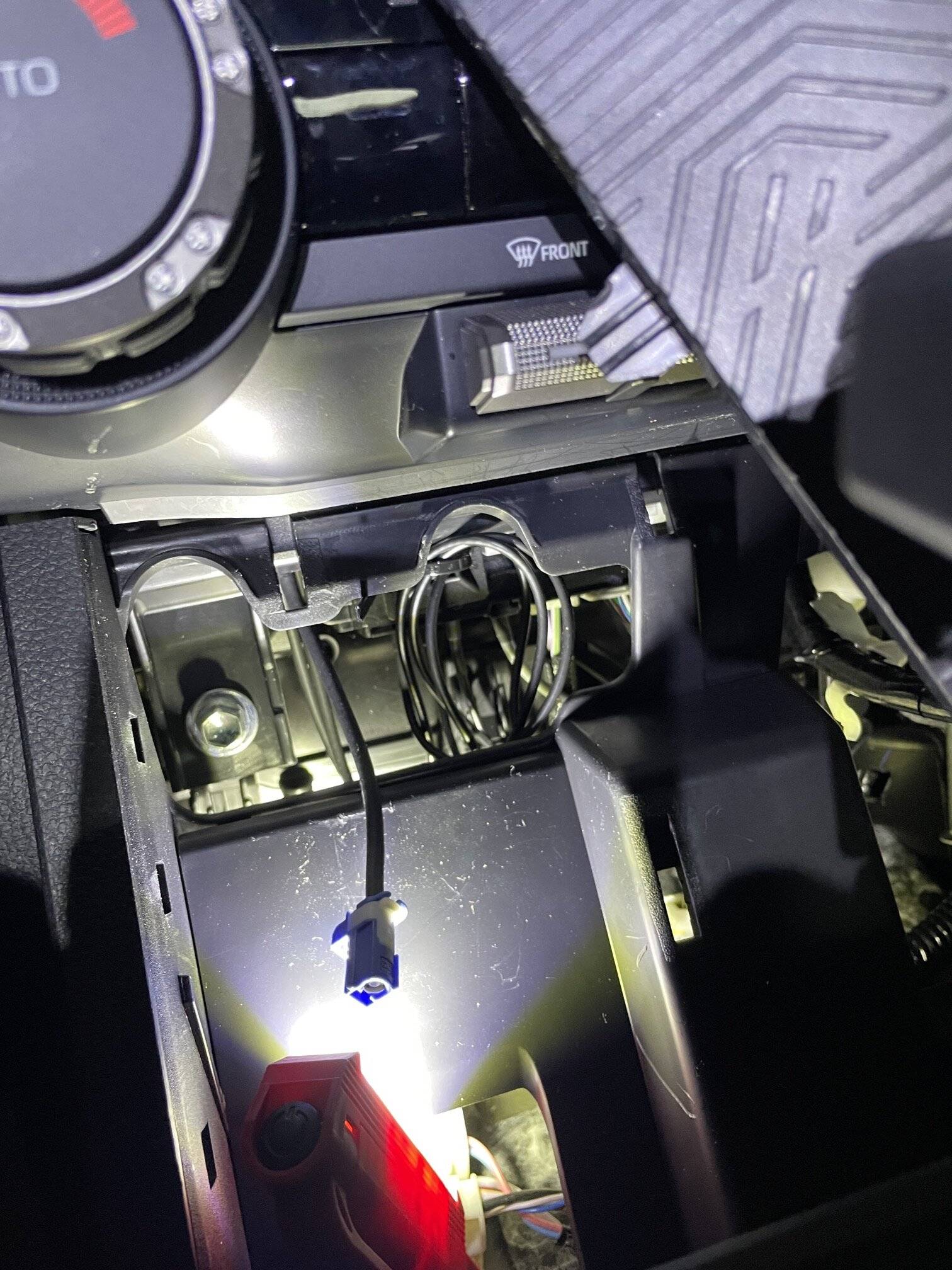

You could probably? just let the jumpers dangle in the dash area but i wanted to take their weight off the interference-fit coax connectors at the DCM side. So I used an ahdesive-backed zip-tie mount and a zip tie stuck right to the front of the DCM, through wich i looped the three new jumper cables. Now there is no weight pulling down on the connectors landed in the DCM.
2024 Tacoma disabling DCM / telematics in 2025 Taco 9_final
I Pushed the three OEM cables back into the dash and let them dangle.

Reinstall the phone shelf/carger plate in reverse sequence. Start the bottom with the vertical fin connectors.

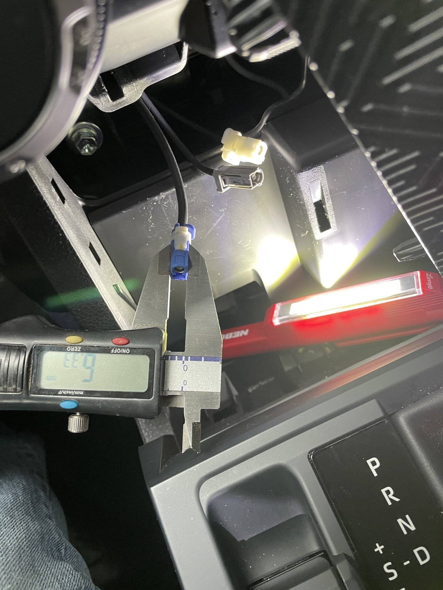

Do we expect the modules to be located differently in any way on a MT car? I have the parking brake bezel that goes over half the surface the panels on a AT car cover
