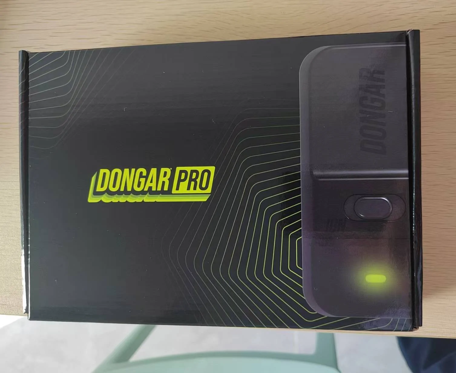

PS, more teasers of the new box and some graphics :sunglasses: ....Guys this is THE most over-engineered car USB adapter on the market :sunglasses:
