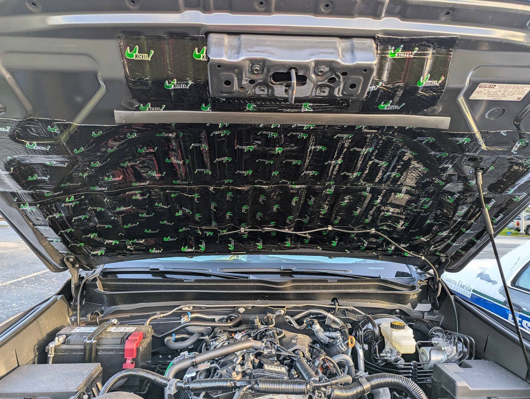

Hey yeah my salesman took his parts manager and they went out on their lot and checked various TRD Sports. Some had the insulation, some did not. He said they used my VIN and searched their system which showed that my truck was built without one on purpose. He said that from what they could determine it was something that was primarily installed on any premium models. My truck is a TRD Sport 4X4 with the Sport upgrade+the 14"screen and moon roof. But not a "Premium ", I guess.

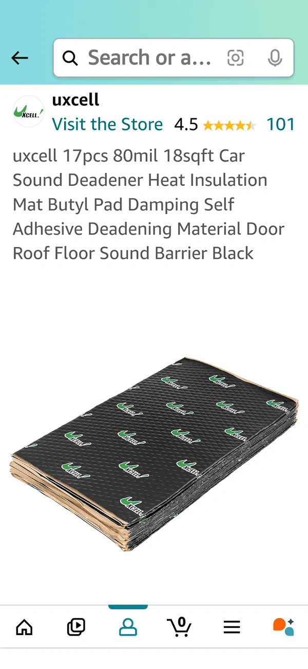

My salesman said just go to your local dealer (I live in Florida but bought the truck from a dealership in Pennsylvania and had it shipped) and give them your VIN and they can order it for you. At $474.00, I was not going pay that so I ordered some adhesive foil backed butylene heat/sound deading insulation off Amazon for $41.00 and installed it on the underside of the hood.
On a kind of side note, I used pipe insulation cut into various sizes and forced it into the spaces between the hoods sheet metal. I noticed that there was some vibration of the hood in front of the windshield at interstate speeds. After stuffing the gaps with the pipe insulation, I installed the butylene sheets.
There is no more vibration and less engine noise. The hood weighs significantly more now which just "feels" way more solid.

any chance you’d be willing to post a couple pictures?
