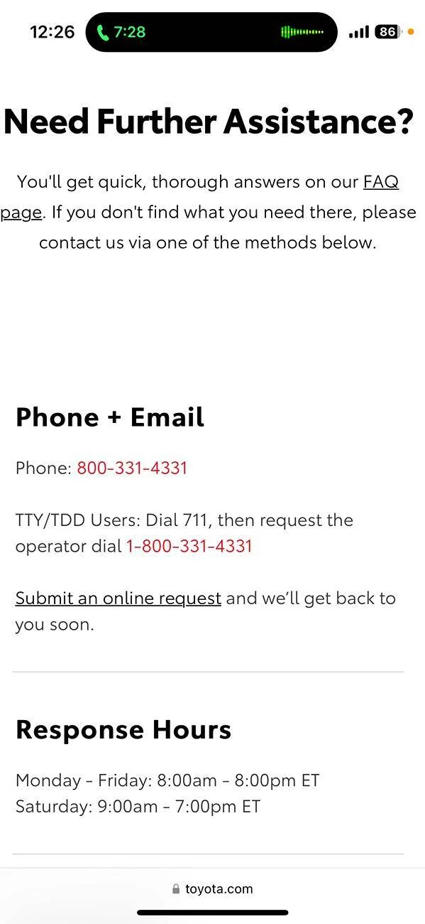

I wish you all would call Toyota corporate and voice your concerns, I already have
