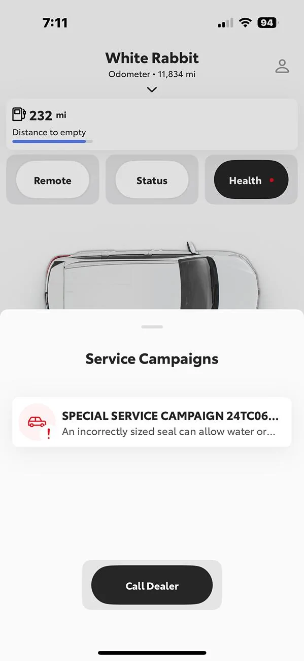

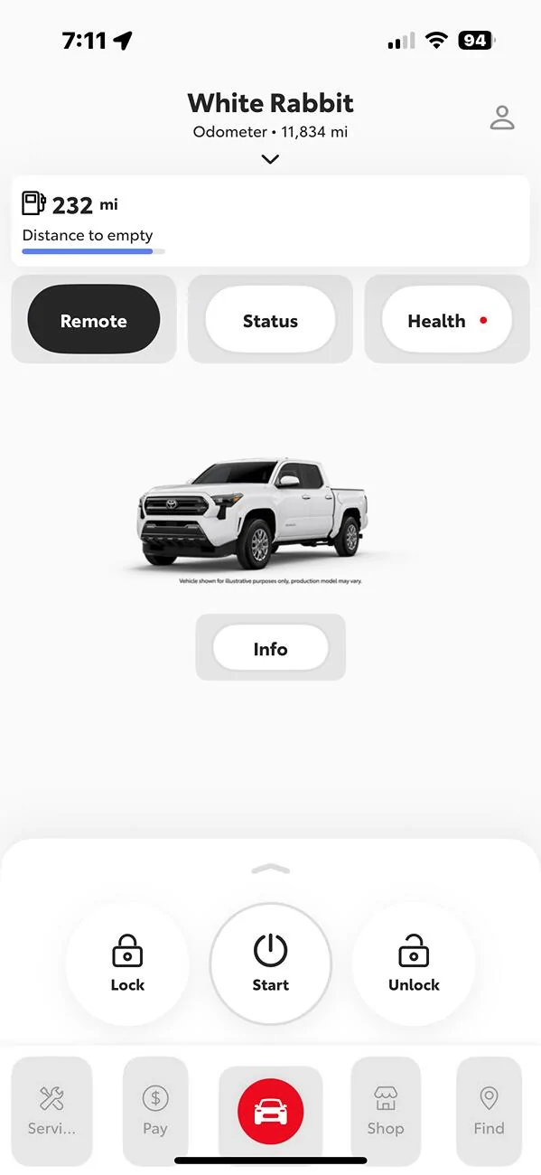

So I received a service campaign today stating that the dealership will inspect and if necessary replace the electric connection to the active grill shutter and the shutter assembly itself if necessary free of charge I was waiting for this to come out hopefully everything is fine with mine either way I hope they put a new connection in to be on the safe side.

So update I took the truck in today for the service campaign and sure enough I had water intrusion into the connection and the tech said there is corrosion in the connection. They ordered a new grill shutter assembly and the wiring harness that plugs into it. Should be in next week and it was free of charge. I’m glad Toyota is trying to make things right with the customers
