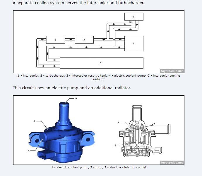

Here is a diagram of the turbo cooling system
This diagram is accurate for a liquid cooled intercooler. Are you stating that the Tacoma utilizes a liquid cooled intercooler?
I’m ignorant on how turbo systems are typically cooled (both the compressed air being routed to the engine and the turbo itself). Is this setup typical? Inter cooler plus separate radiator? Pros/ cons to it?
Unrelated- is the trans fluid cooled by the engine’s radiator?
I believe some some variants of this engine use a liquid intercooler, but on this truck-the intercooler is air to air- like a radiator with no liquid in it. The turbo may have a coolant line, but I have not looked underneath the passenger side of the engine to confirm this. The turbo will definitely have an oil lubrication feed line.
My guess is that people here are mistaking, is that the idea behind letting the engine idle briefly after driving, is to cool the turbo… I would bet good money that the intent of idling, is to allow the turbo CHRA/impellers- to slow to their slowest spinning speed before shutting the engine off. The transmission oil cooler is a heat sink looking thing near the engine oil filter. I am no fan of it, but this type of design has been used by various automotive manufacturers for a while. Personally, I will install a trans oil cooler with a fan and temp sensor/fan switch. I will mount the oil cooler under the driver’s side of the truck since there is lots of room since I have no hybrid motor to contend with/non hybrid truck.
