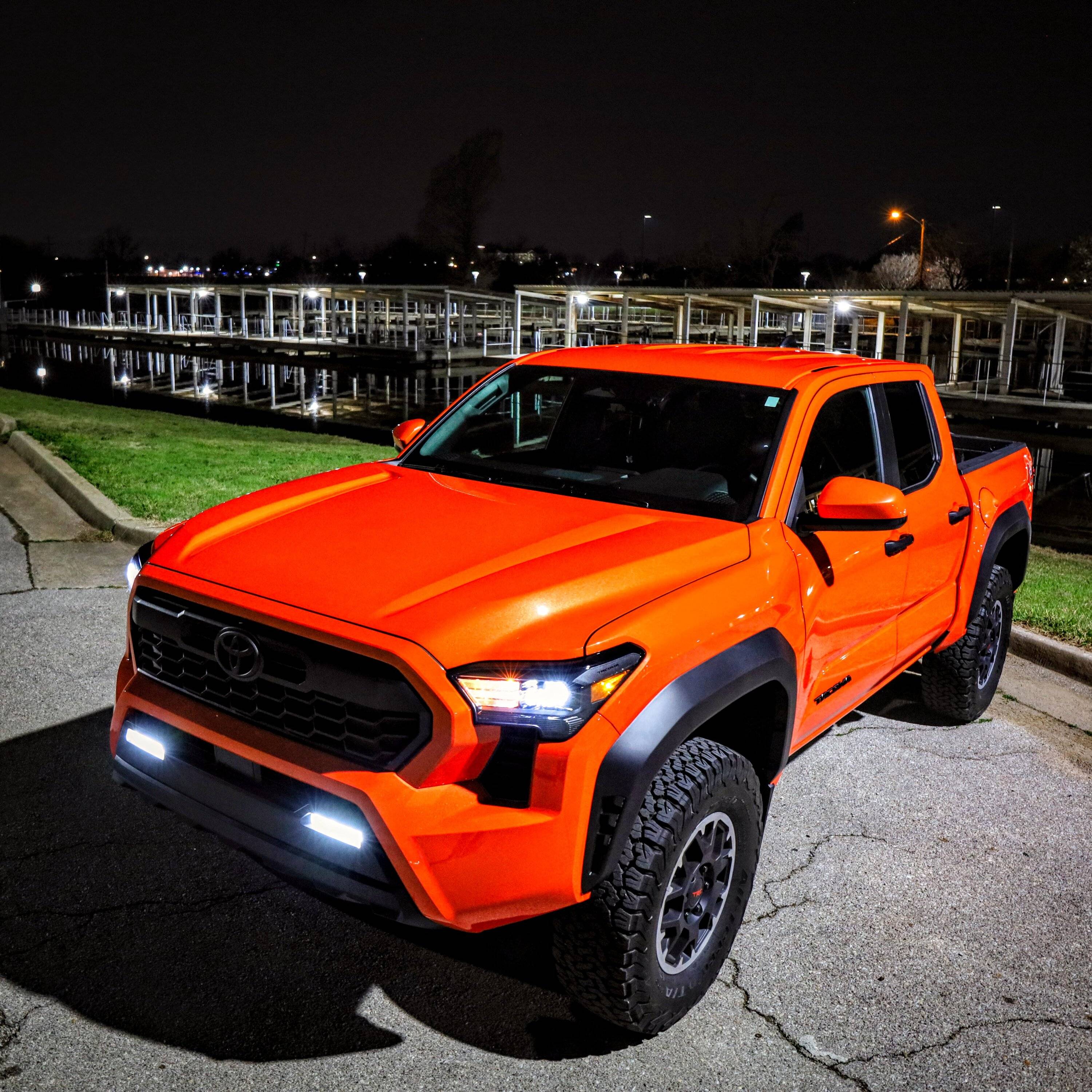

just installed the 1.5” readylift leveling kit. All stock besides leveling kit. Looks great to me. Still a slight rake which I prefer and now it doesn’t look slammed in the front like before. Install was easy but a bit annoying to trim the OE strut top mount bolts. All in it was maybe 40 minutes, but I’ve installed a lot of these kits before.

Did you have to get an alignment after the install?
Yes...
The dealer installed my level kit before I arrived to pick it up, and they did the alignment. I was their first 2024 Tacoma, so they had to calibrate the machine.
I once put a gussted idler arm on my 85 2wd on my own, never did the alignment before the trip to Arizona (Parker 400) and it chewed up my Mud's from Wisconsin.
2024 Tacoma ReadyLift 1.5" leveling kit for 2024 4th gen Tacoma now available thumbnail_20240317_074333
