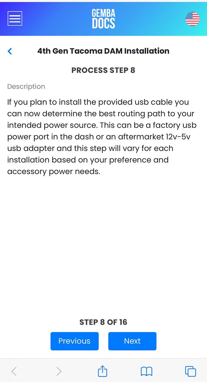

So I’m looking at this from victory and like the idea of having some mounting points behind the screen
https://www.victory4x4.com/product/...VyXPEuT15EG0WxHh_8dshMYzO6JGvabBKEaPKowHQA3sX
It comes with a dual usb cable and was wondering if any way to run that under that dash section for power or they’re just plugging it into the side of the screen? Would love to have power up there with a clean install

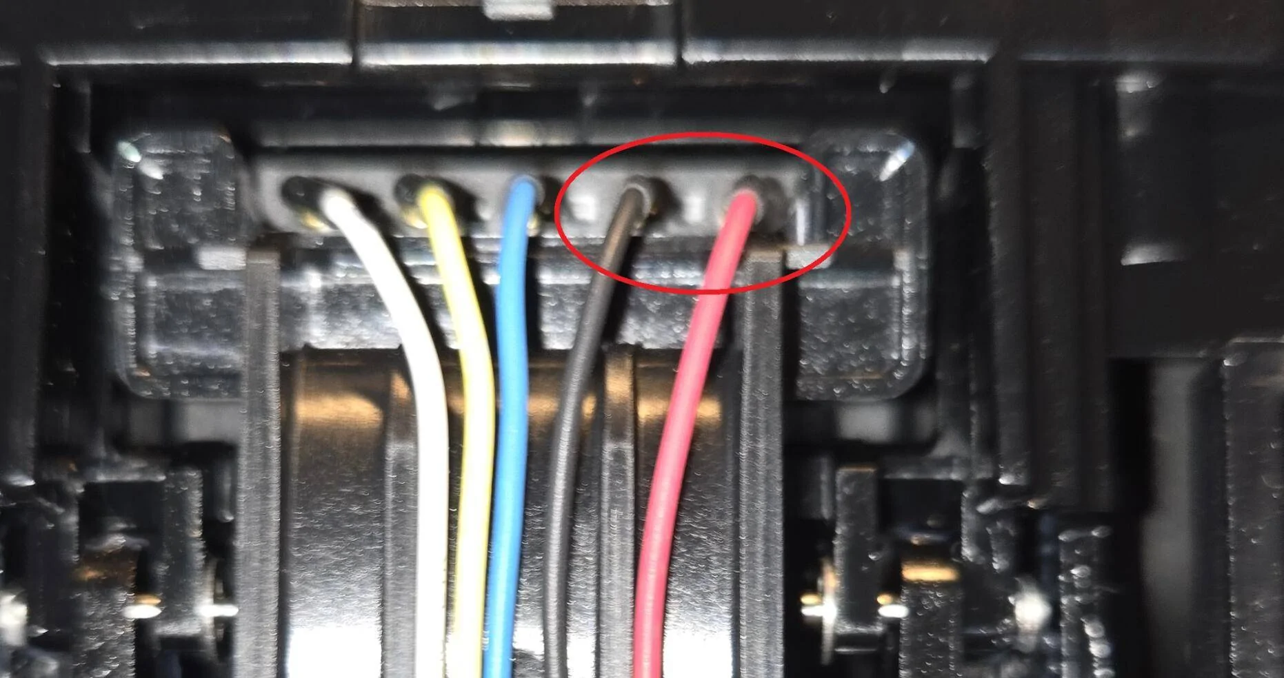

You could also pull the power, ground from the JBL removable dash speaker charge wiring and make it really easy.
