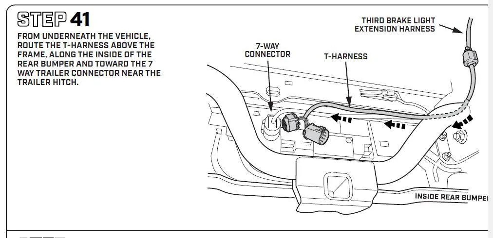

Still waiting for my harness but the instructions show it plugging into the trailer connector.
Do you know off-hand if Smart Cap waiting for this from Toyota or an aftermarket supplier? I'm guessing if you get pulled over for this it's basically a warning after explaining you're awaiting parts?
It's definitely a Smartcap part, not something from Toyota. Once the hole is drilled in the bed, it's a five-minute plug-and-play.

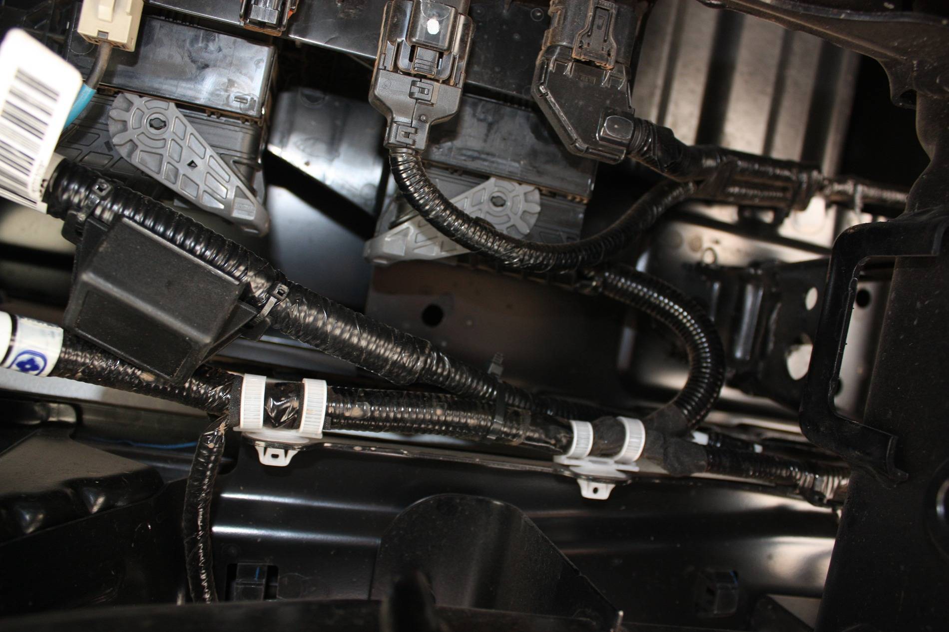

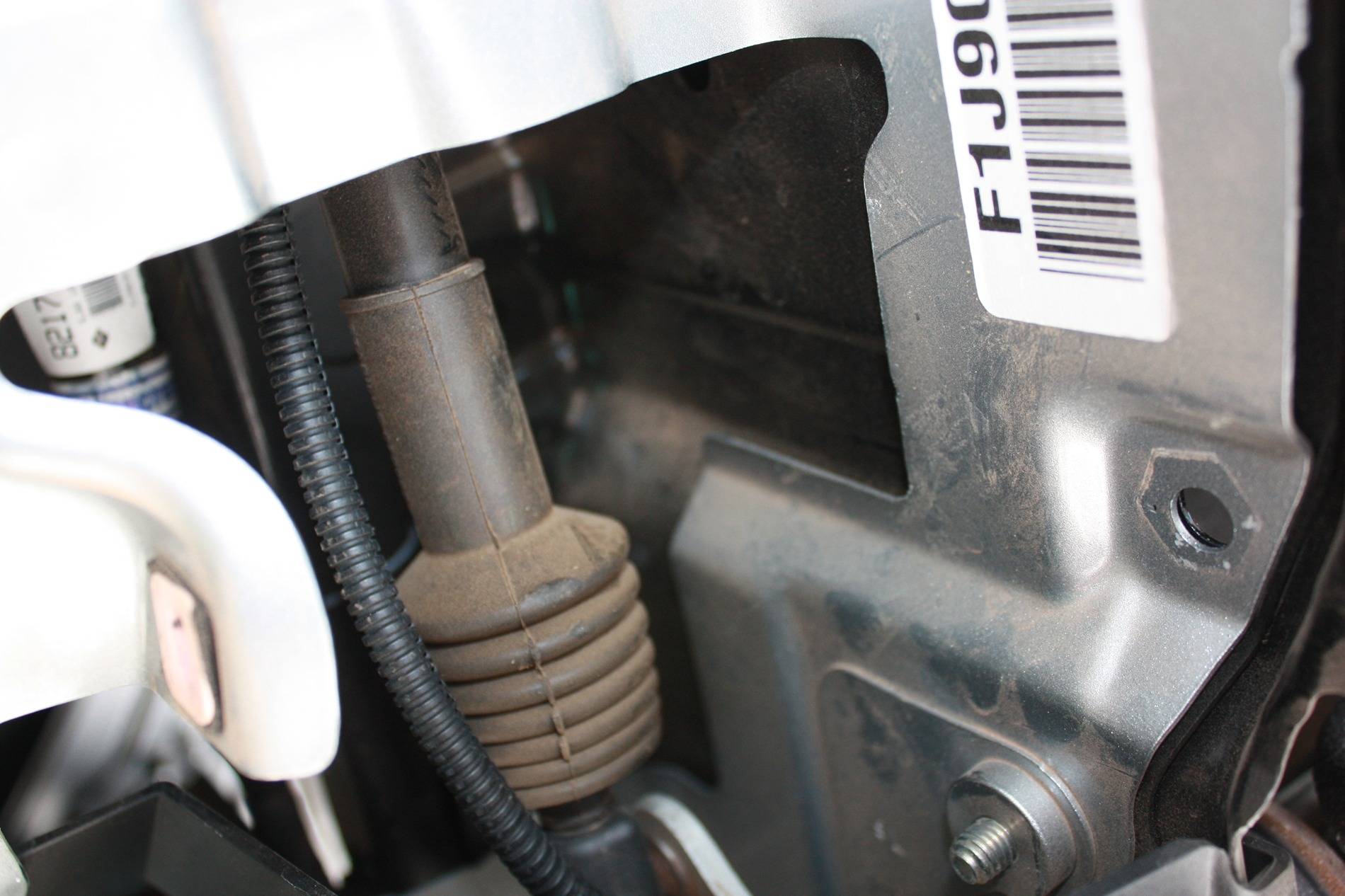

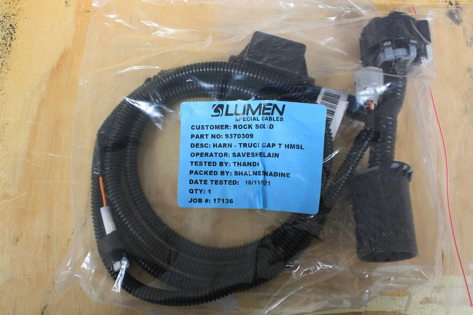

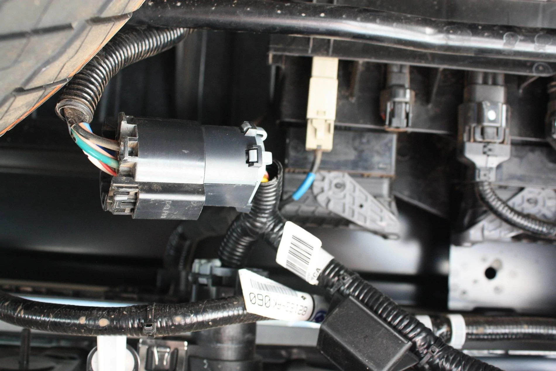

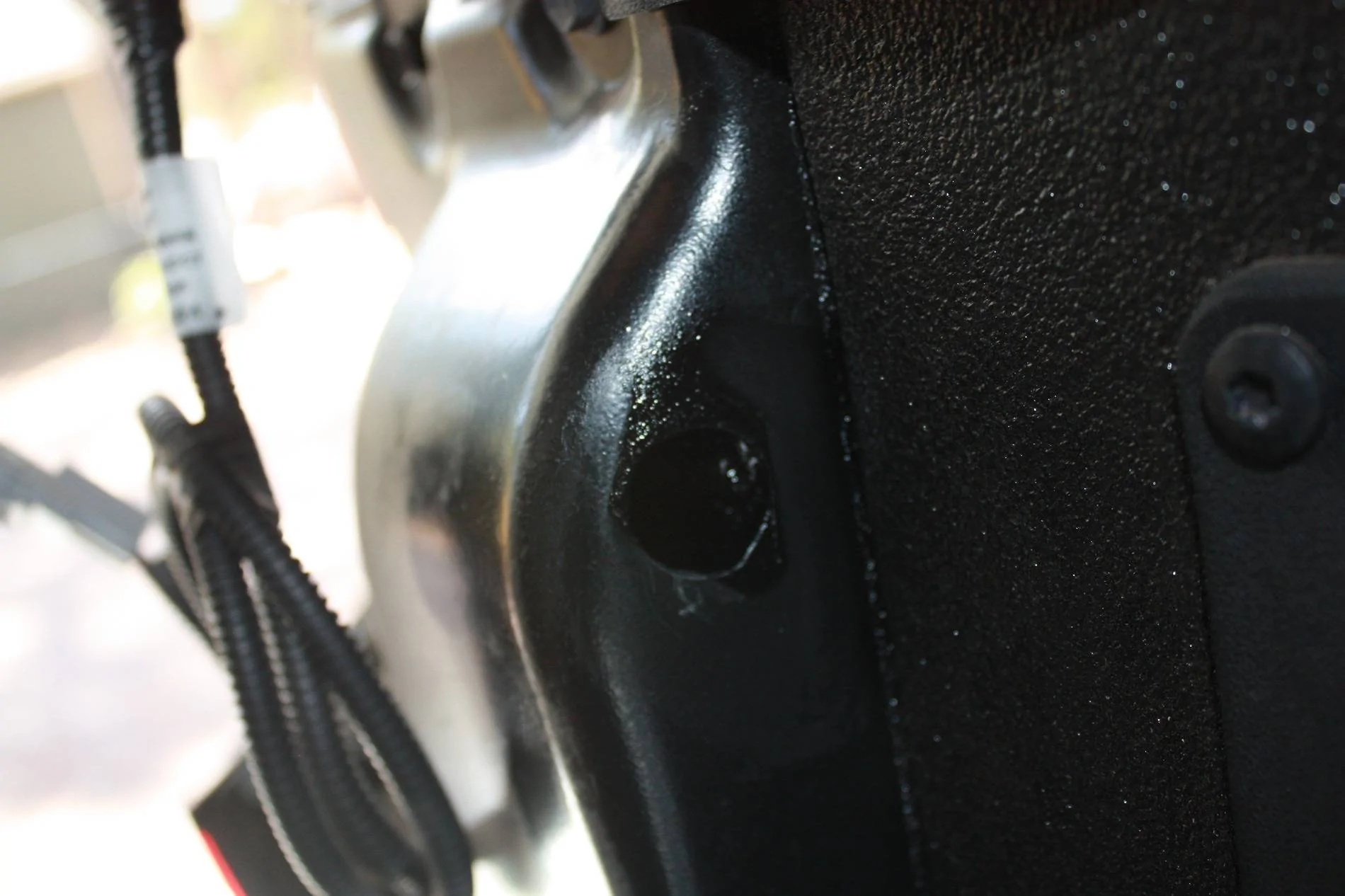

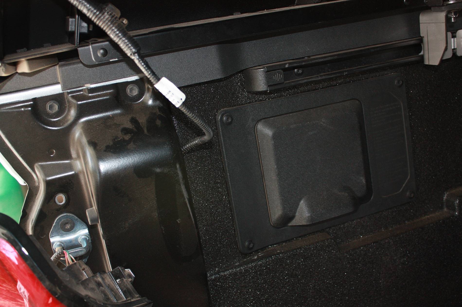

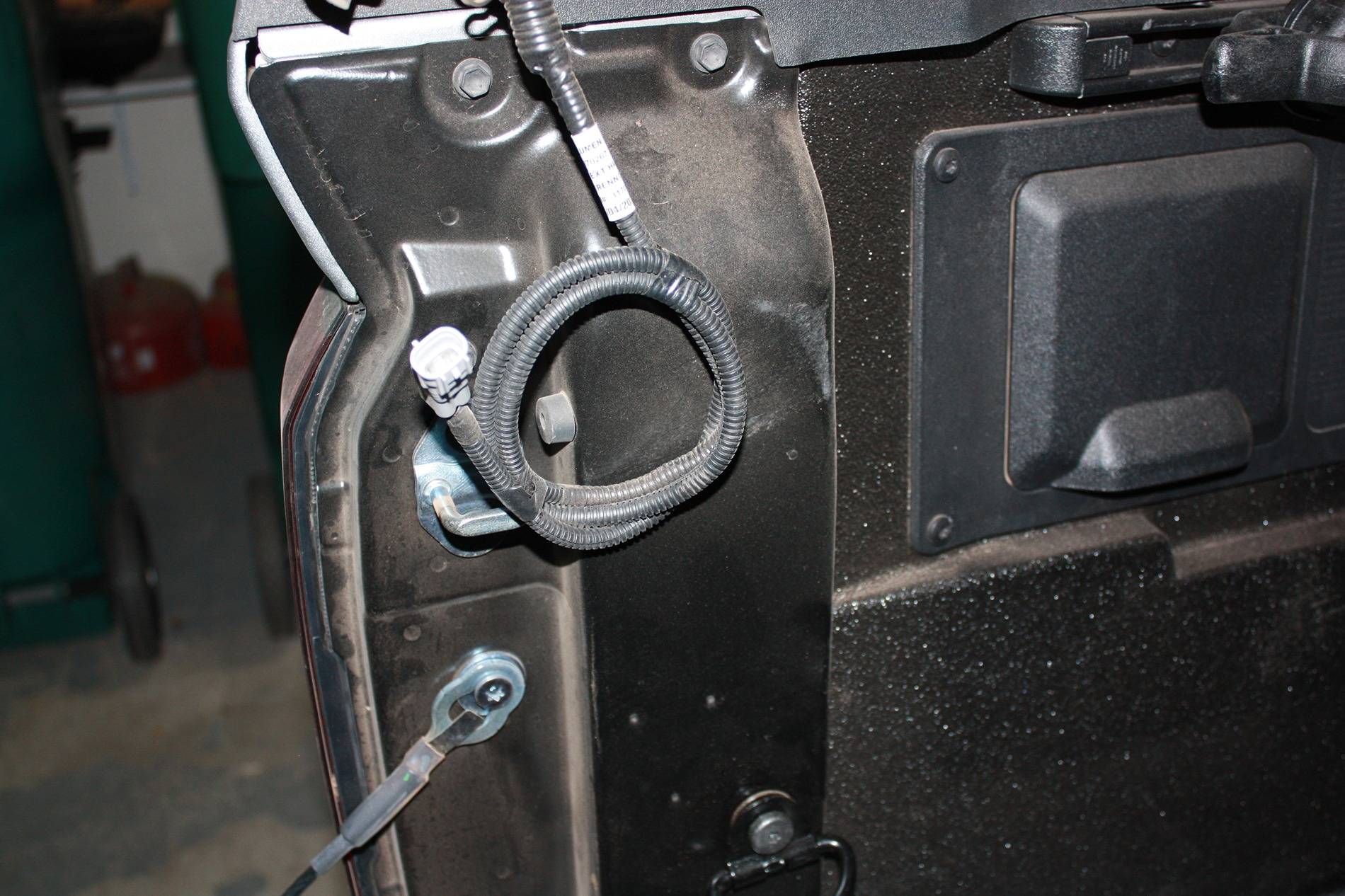

Wiring harness came in.
It's from a 3rd-party manufacturer in South Africa.
Comments on the installation below.
2024 Tacoma SmartCap Adventure Topper Installed IMG_20241017_125752440

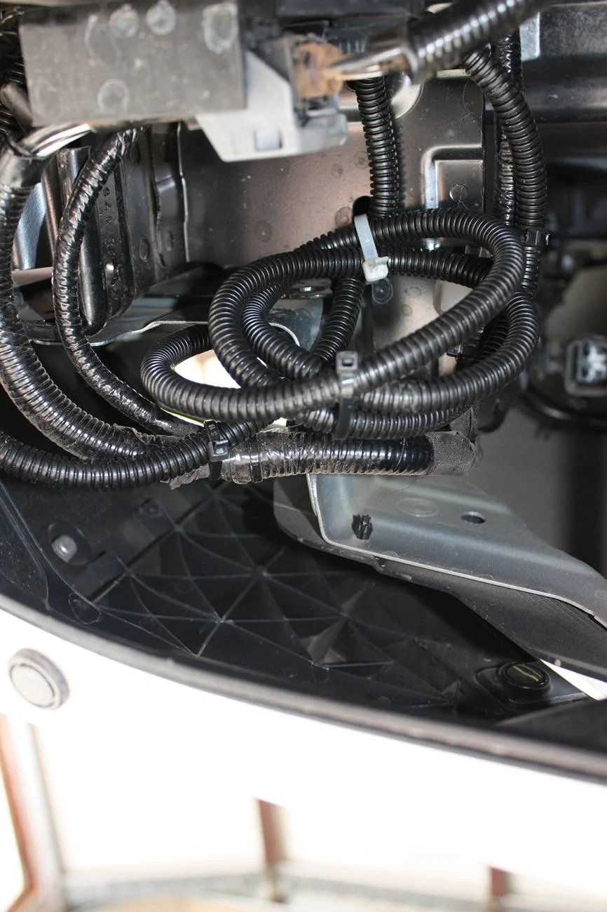

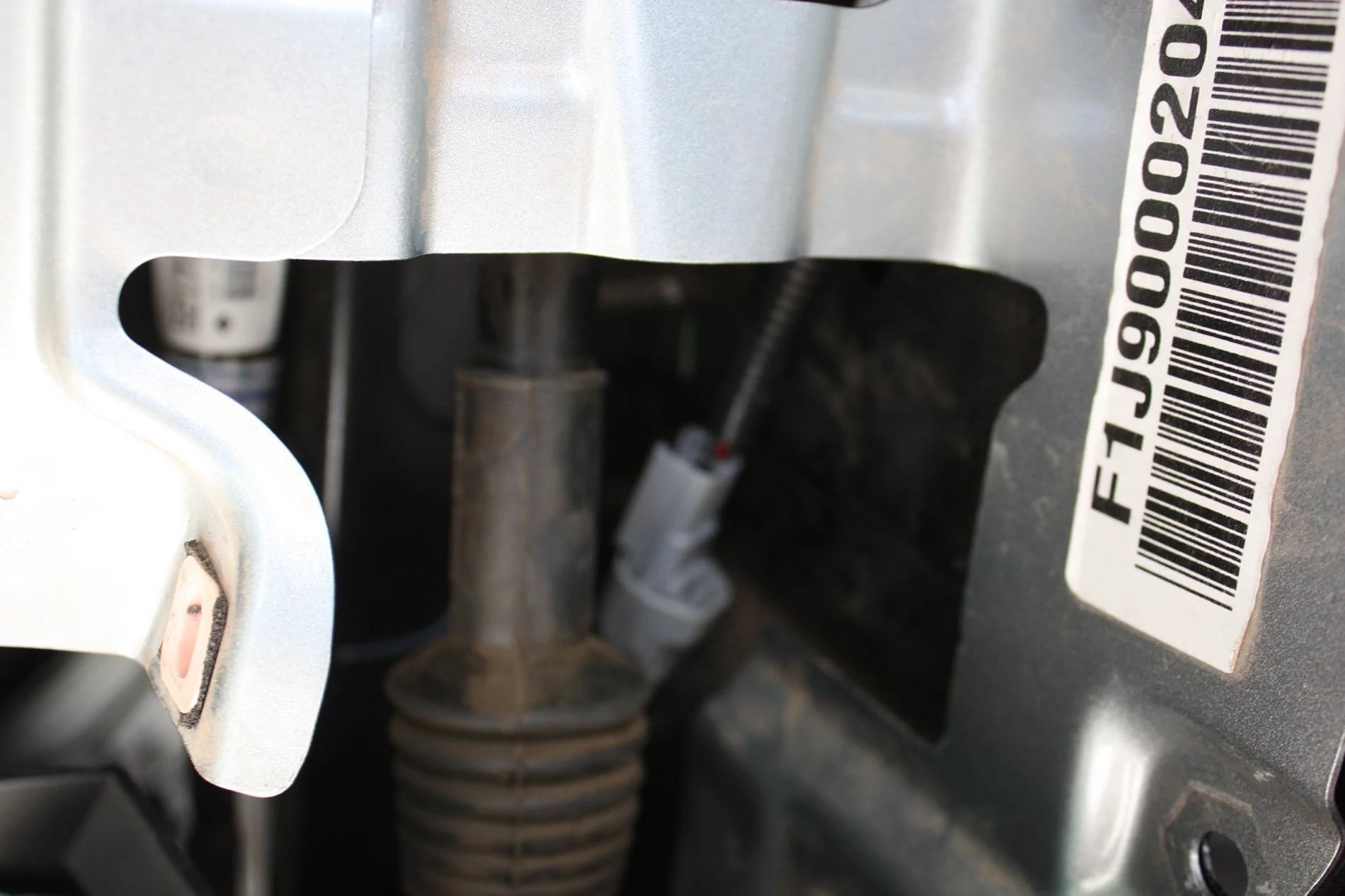

Biggest pain was drilling the hole. Metal is thin there so the bit wants to grab and deform the surface.
2nd biggest pain was that the t-cable was soooo long. Ended up rolling it up and tying underneath instead of trying to cram it alongside the soft-opening strut for the tailgate.
Next was something I found disconcerting. After I did the initial hookup I propped a weight on the brake pedal, and no light! Turns out it only works when the engine switch is on.
Lastly, no grommet included for the hole. Naturally, I didn't have a 3/4 grommet in my boxes and boxes of stuff, so, a trip to the parts store and now I have 3 spares.
Am happy it's all done though.
