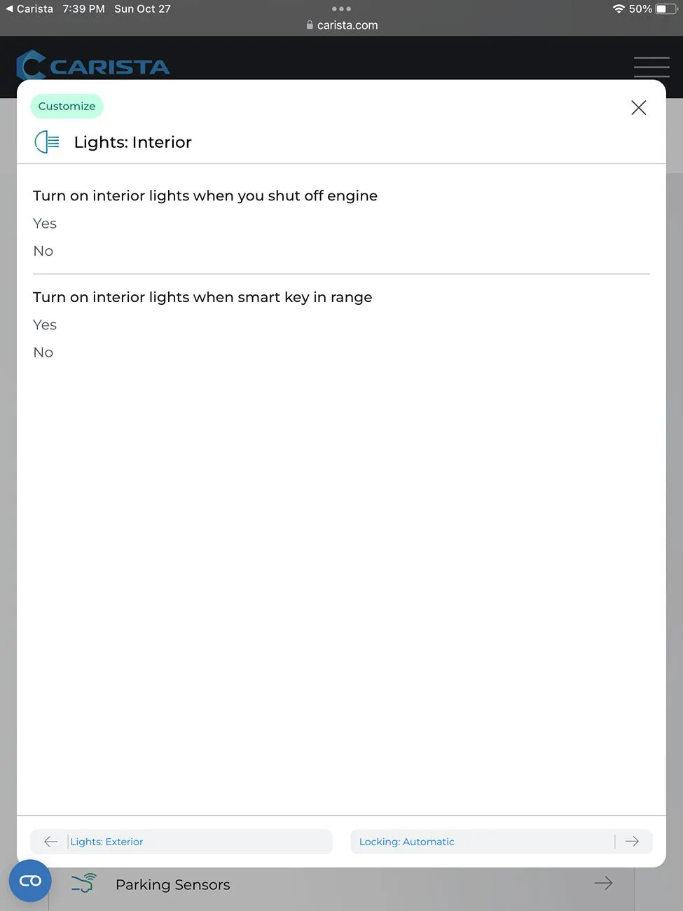

Carista will do that I think. I have not tested it.
2024 Tacoma Sure wish there was a "tactical" lighting mode IMG_0816

yep that works great 👆🏼No need to Carista the shit out of your truck. Just turn your main interior light switch to OFF. You can still turn on individual doom lights at will. Same for the bed scene/ door lights: turn that switch to OFF as well.

Besides, if he’s truly in tactical/burglar/thief mode, he’s gonna want to Carista the shit out of the truck and kill all of the chimes and beeps.

yea fair enough. The footwell light(s) stay on. They're the lesser of the lumen tho - the instrument cluster is the brightest thing to contend with (altho in accessory or power off, I think* it only illuminates when doors open at that point). If Carista can nix that, I might even buy it for super-tuned generator mode camping
