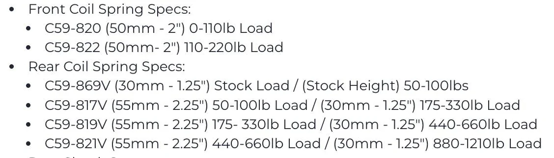

For the Dobinson, you may have to take a little gamble depending on what you want. Below is a screenshot for the rear spring options showing potential lift/load. Keep in mind these lift numbers are for an SR5 or TRD Sport / Off-Road truck, not the Trailhunter. Supposedly we have a 1" lift in the rear already and I think that is a spring lift so you would need to subtract 1" from the lift numbers for what will actually be achieved against the stock Trailhunter. My suggestion would be either the 869 or the 817 depending on if you want .25" of lift or 1.25" of lift. If adding the Peak 1" lift, I would definitely go with the 817 (personally). All this assumes stock load.

Got it. So the 817 gets me the greatest extension / lift with the lowest spring rate, correct? And our OME shocks have that much additional travel? Would you say the 817 is a similar spring rate / tightness to OEM spring?

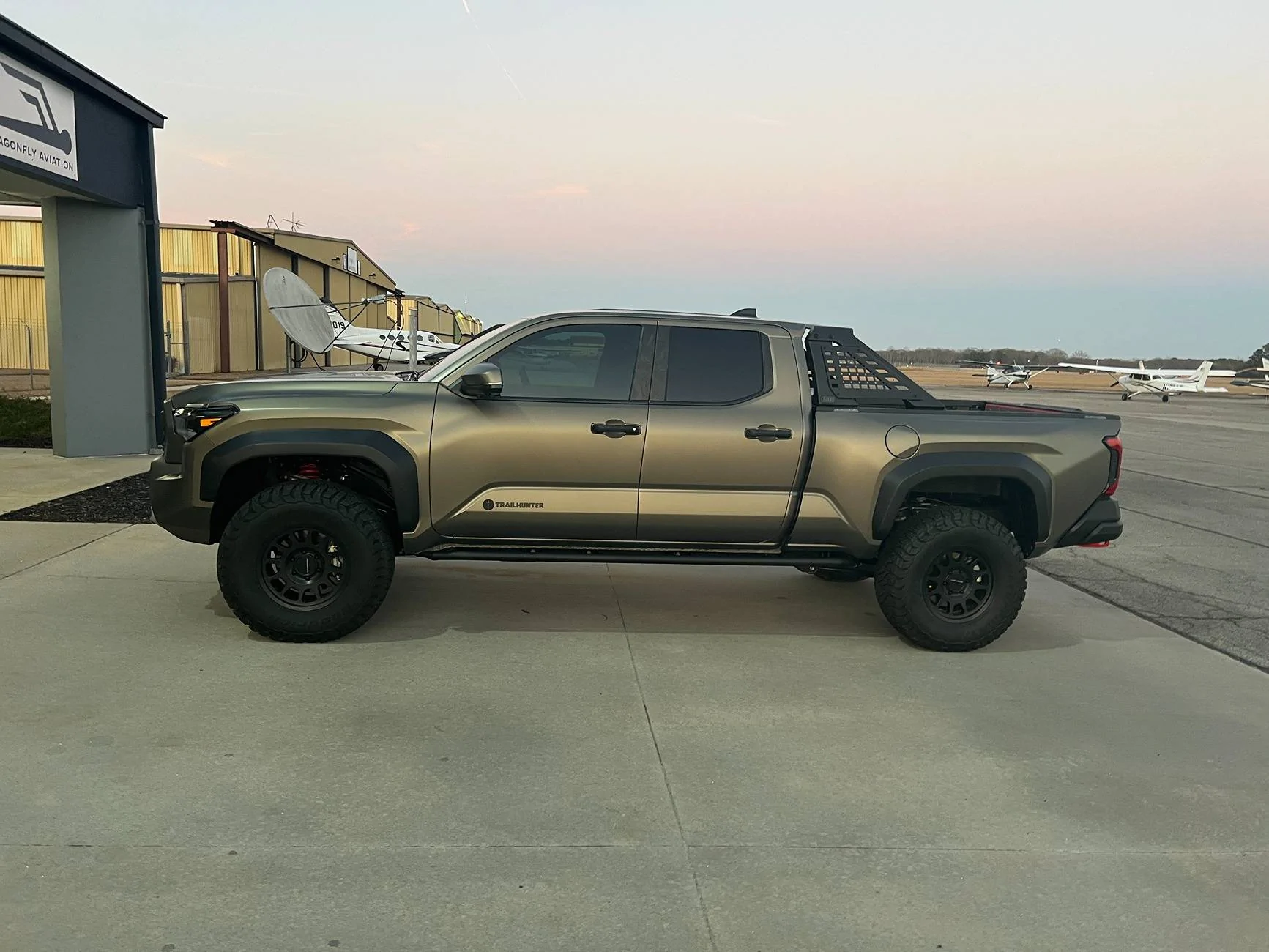

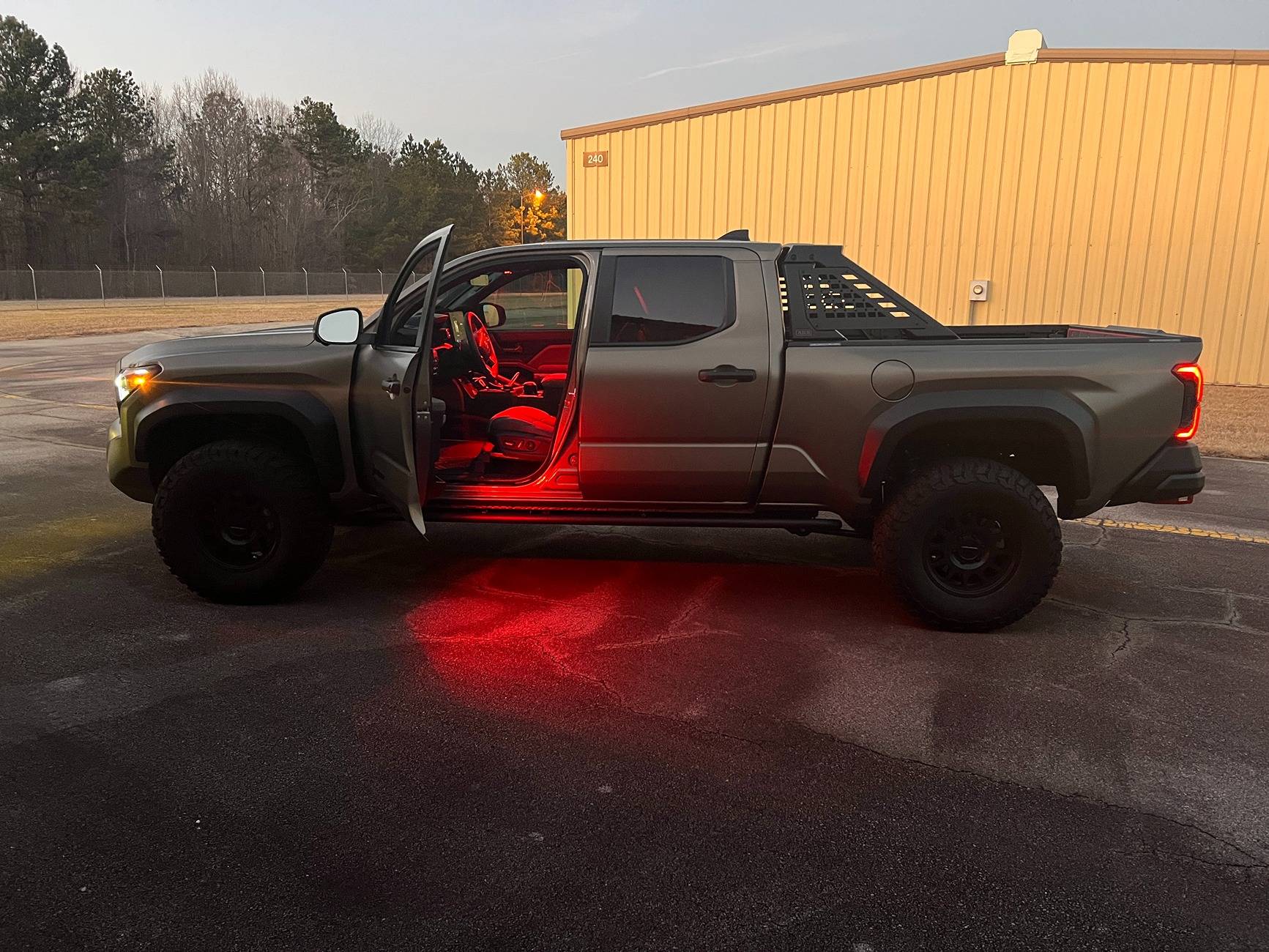

I did. 820s in the front. There are some pics above.

Oops - now I see the pictures. Great stance on your truck. It's crazy to me that we have that much travel to play with in the shocks. Does this mean you have more compression stroke but less rebound? Sorry for the dumb question. And for the 820 in the front, what would be equivalent to the 817 in the front in terms of spring rate?
