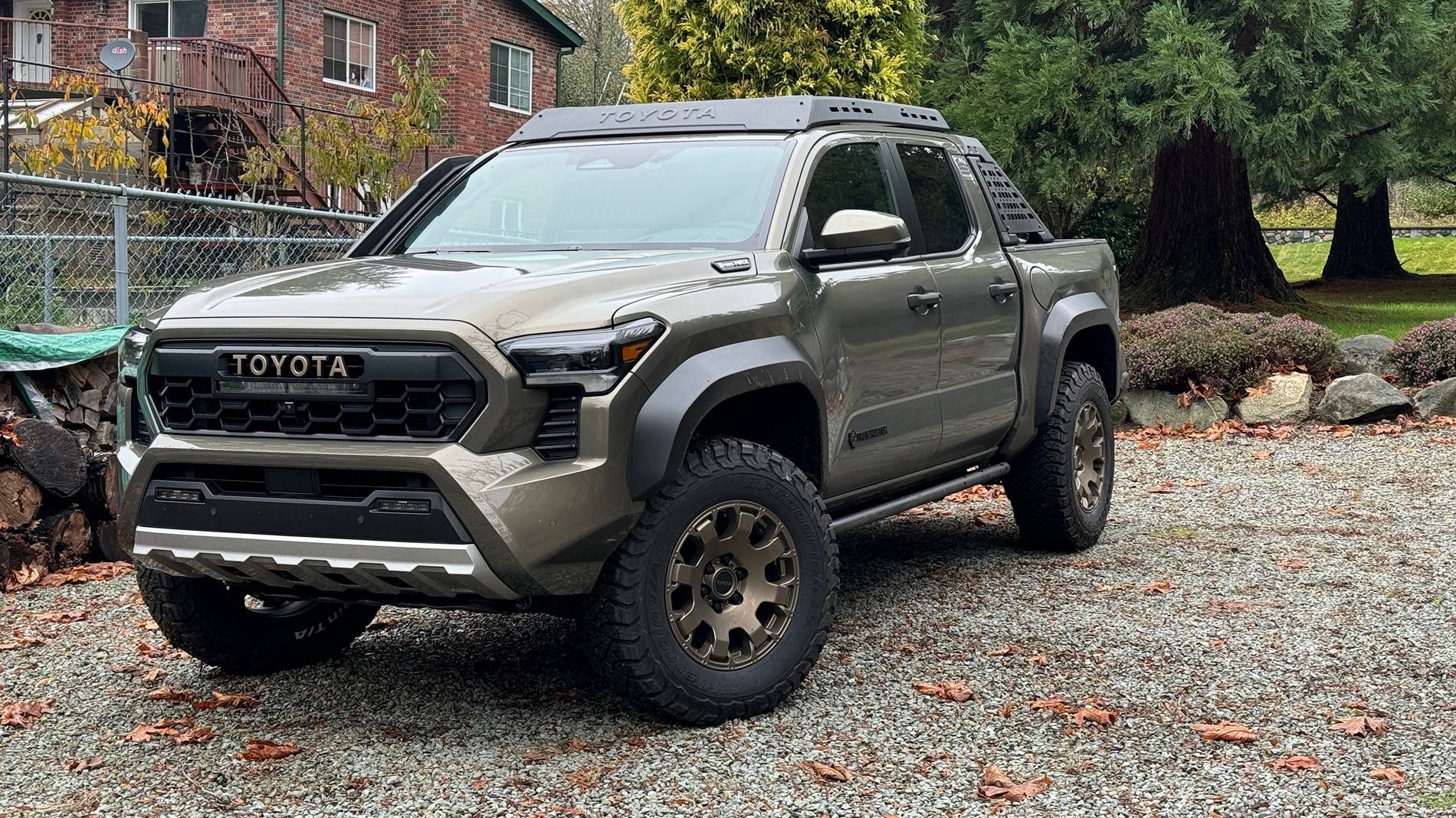

I believe it’s on one side. I didn’t ask them to, but they installed it with the white on the inside. Kinda wish it was on the outside tho

That looks good. Does it use turbo more heavily at highway cruising speeds?

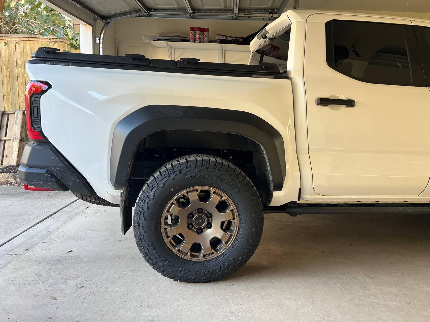

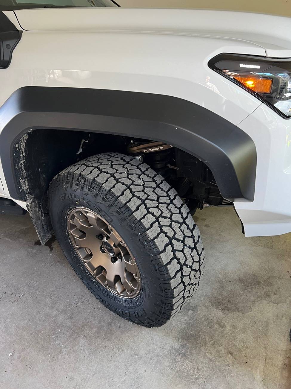

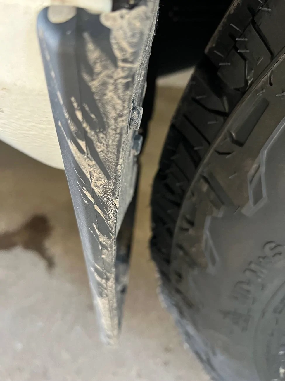

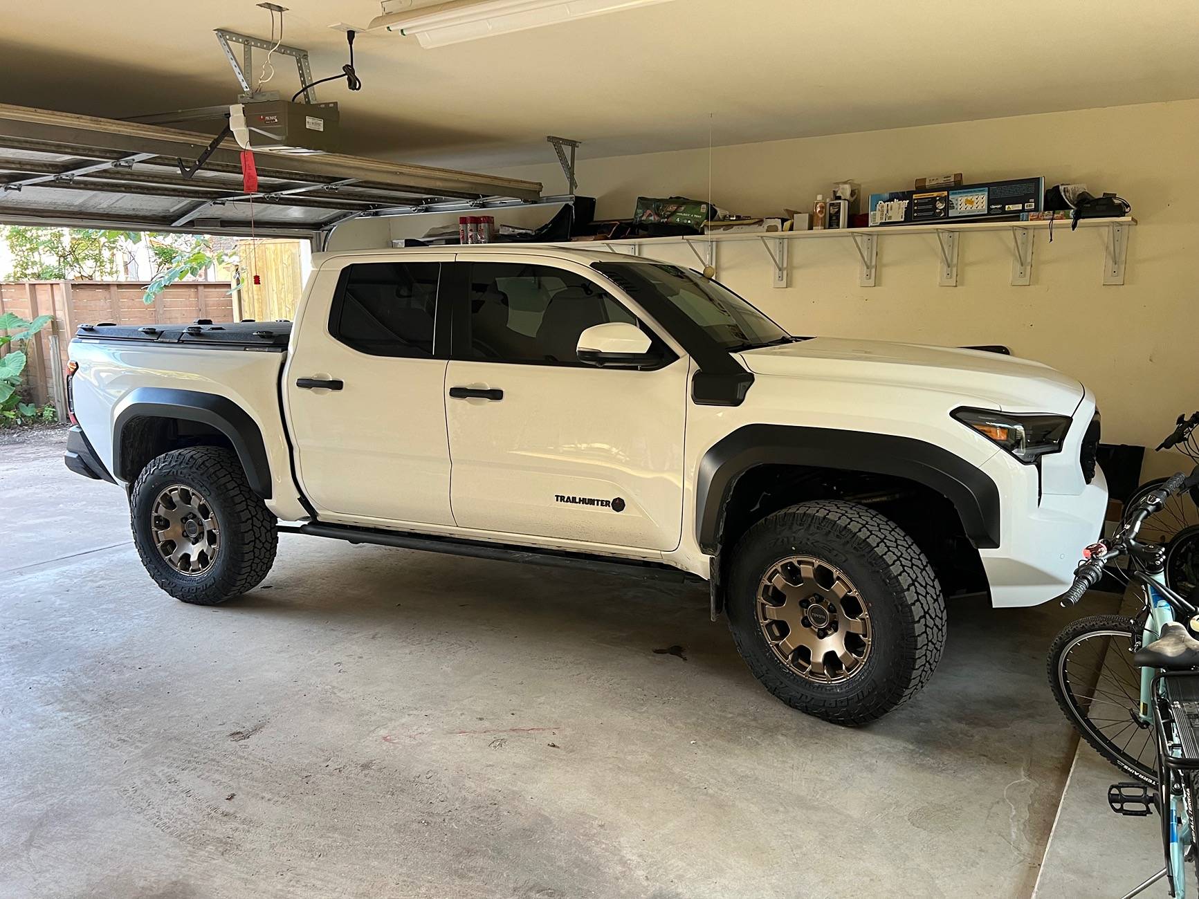

Went with the Falken Wildpeak AT4W in 275/70/18. For my setup at least, this is as big as I can go before I hit rubbing. And the size looks appropriate and plenty meaty. They ride very smooth. Shockingly smooth for an E load but still firmer than OEM. I will play with the PSI to see if I can smooth it out. Currently at 40. Falken said to run 39. I may try 37 given the fact that 39 is rated for over 2,000 pounds and I don't need that.
I can certainly feel the extra rotational weight. I think acceleration is where I feel it the most. But for the off-road toughness and extra size, it's worth it for me. The tires are about 0.8" taller than the old ones when inflated. The old ones sagged because they are so soft. Ground clearance is up by 0.4" and I can tell.

They look awesome, good choice. Really fills out the space better.
