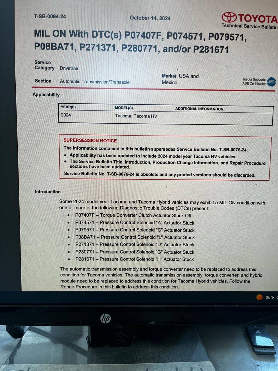

That’s the one thing about that tsb Toyota put out that pissed me off, they gave zero info on what issues customers might expierence in relation with the dtc codes that get stored in the computer.
That is true. I get the feeling that a solenoid does not throw a code until it won't work at all, which is why the transmission stop shifting into some gears. But you have to wonder if your weird shifts aren't just a sign that they are damaged. Then you have to wonder if that is all that will happen or if they will get worse in time.

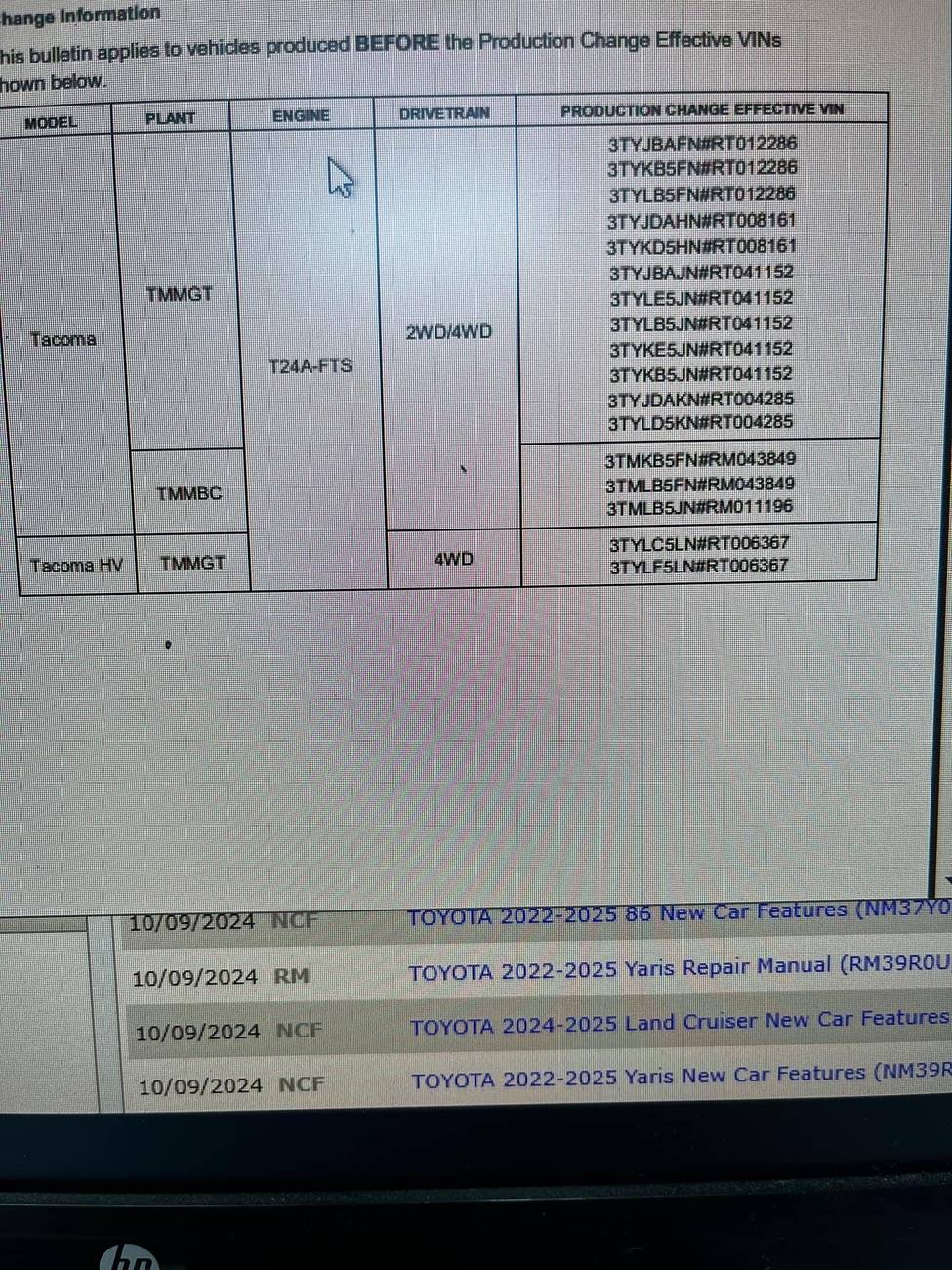

Yup and I’m hoping they come out with an updated bulletin on the matter to clear the air. The fact that pro models and trail hunter models have failed as well is concerning because they aren’t even listed on the tsb sheet.
Yeah I wondered about the halos. My truck is not in any of the ranges but I don't know if the ones that failed are or aren't. It would be helpful to know that too.

Mine has an 08 build month, and just falls in the TSB, 40592 lol
