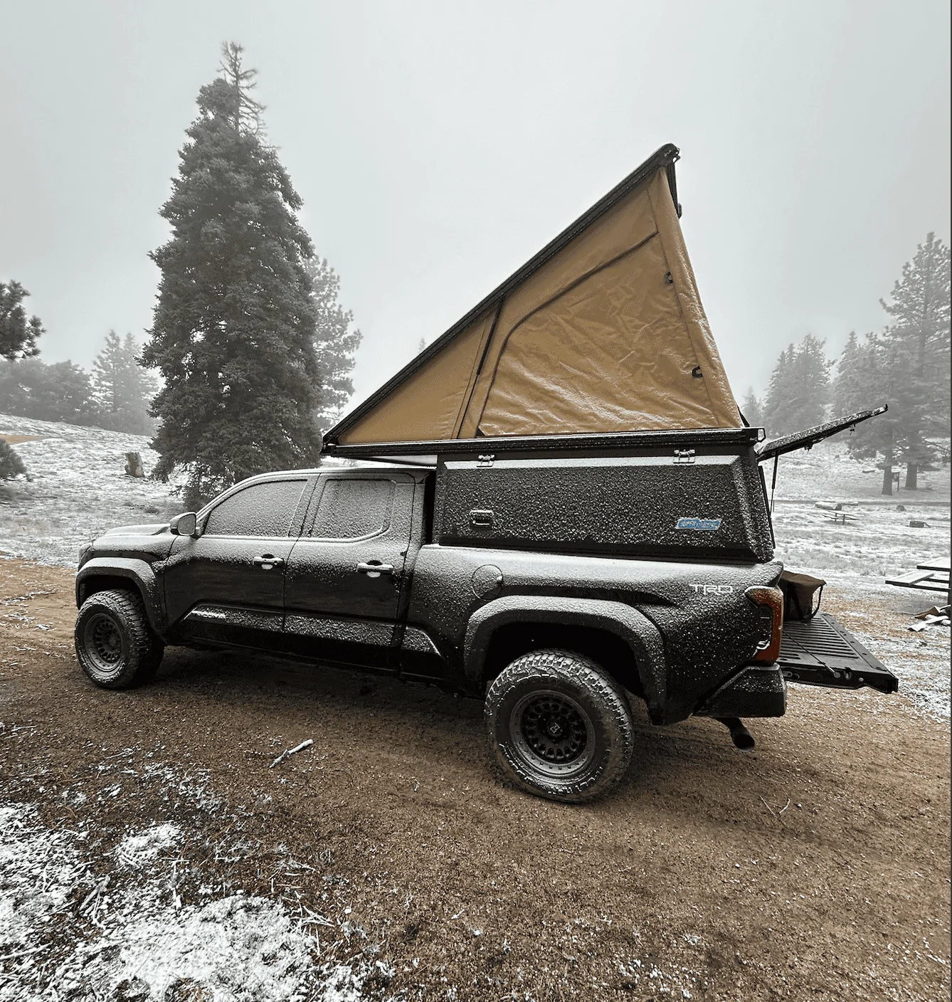

I currently am running a Super Pacific Camper Shell which adds 350lbs, and then when I throw in all my camping gear I'm at about 450lbs if additional weight and it squats a decent amount.

From that pic it certainly doesn't look like it's squatting.

I added the westcott spacer to just the rear of the truck and that brought it back to level with the camper. However, once I start adding in gear to the back it starts to squat again.
I think upgraded springs are the solution since I will be under a constant load of around 400lbs.

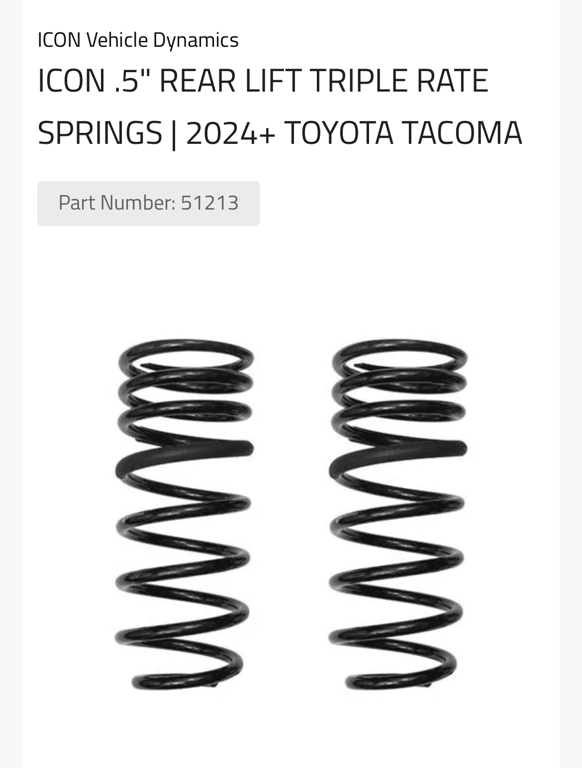

The Icon springs are actually softer than stock, according to the folks over there. I'm also interested in stiffer rear springs / sumo / bags for towing purposes, and had asked them what the spring rate is, as they advertise them as "triple rate", so I guess they're progressive?
Anyways, they replied back and told me the spring rates are a "proprietary design" and can't share that information..... But mentioned they were softer than stock. So if anyone is looking at this thread considering these to increase your rear load, I guess we'll have to wait for other options.
