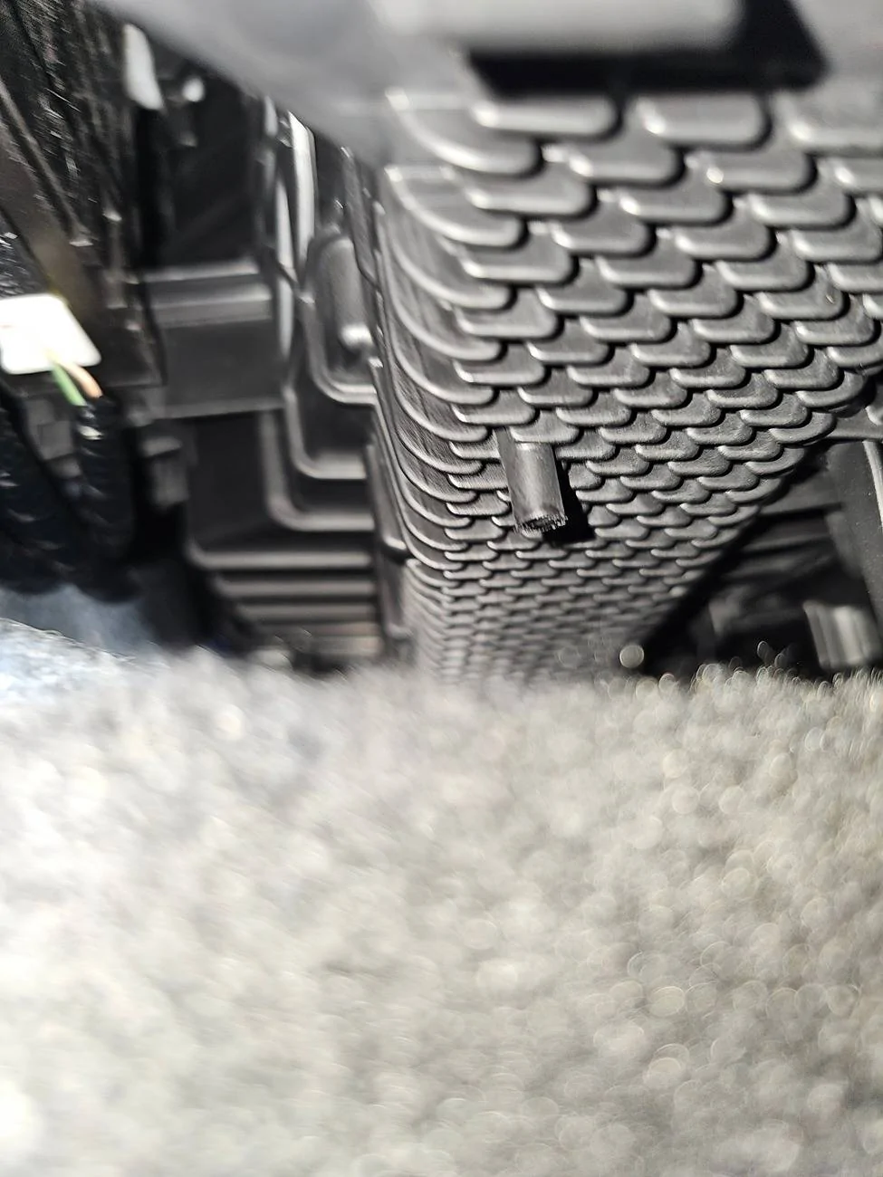

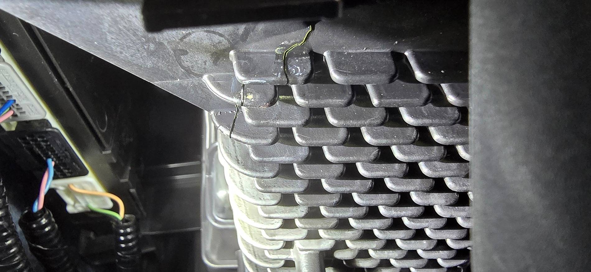

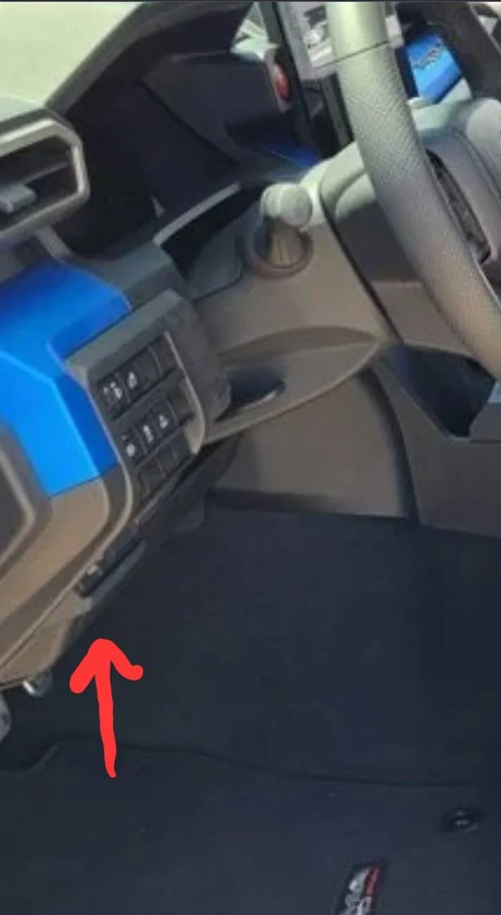

If this is the same issue the rest of us are having look up under dash with your phone camera to the right of the gas peddle and take a photo (1st photo). If you see a crack on the piece that has the fins on it like in the photo then yes it is probably the same issue. (2nd photo)
hoping it stays looking good. I got a 3ty :/
