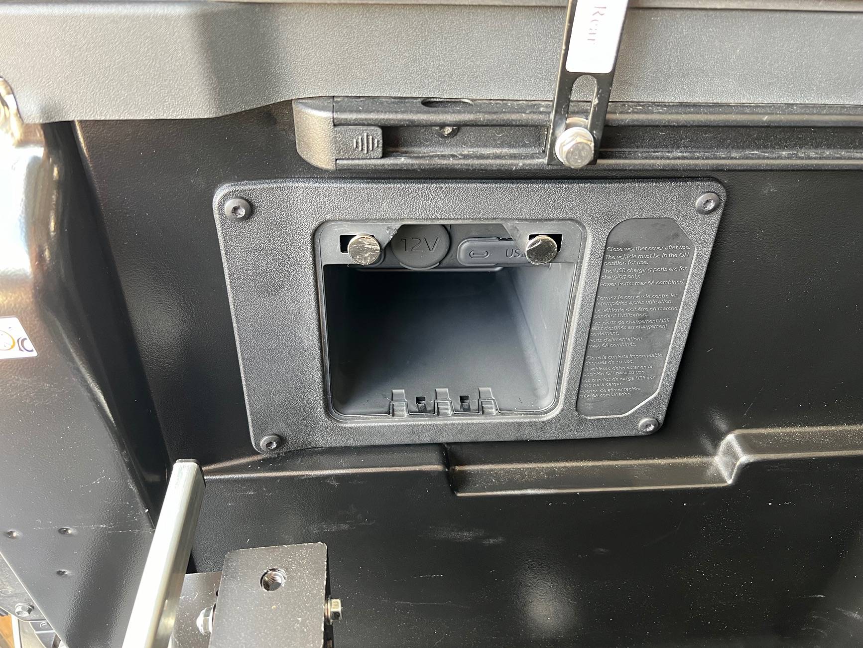

This is specifically for the 24 Tacoma with Power Bed Accessory. The instructions included have you buy some magnets and glue to modify the cover to the USB ports so I can access them. The deck has a cut-out on the right side so the plug door can open freely with no issue or modification.
I read Decked's instructions for modifying the USB port, and it looks relatively simple, but I won't know until I start taking everything apart. I'll capture some photos and post my thoughts.

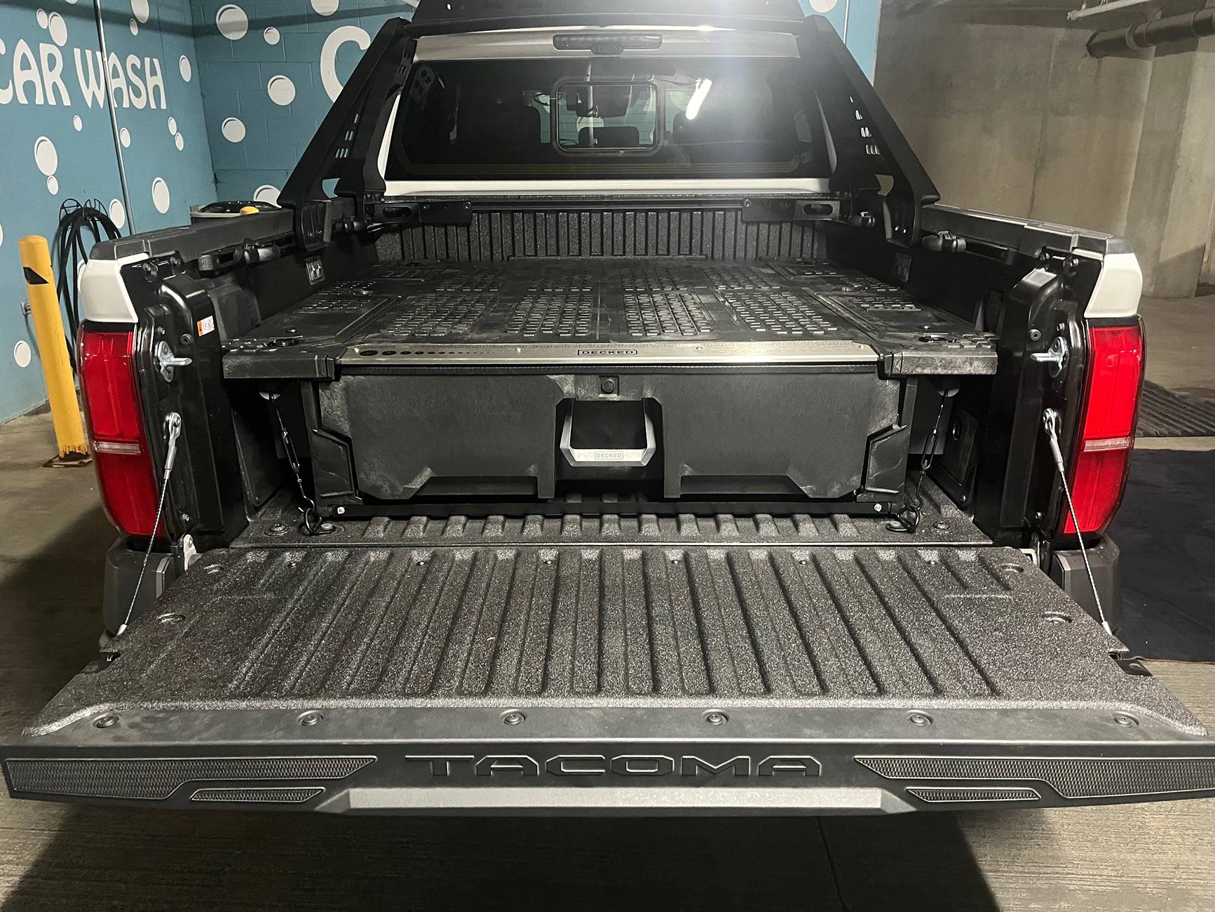

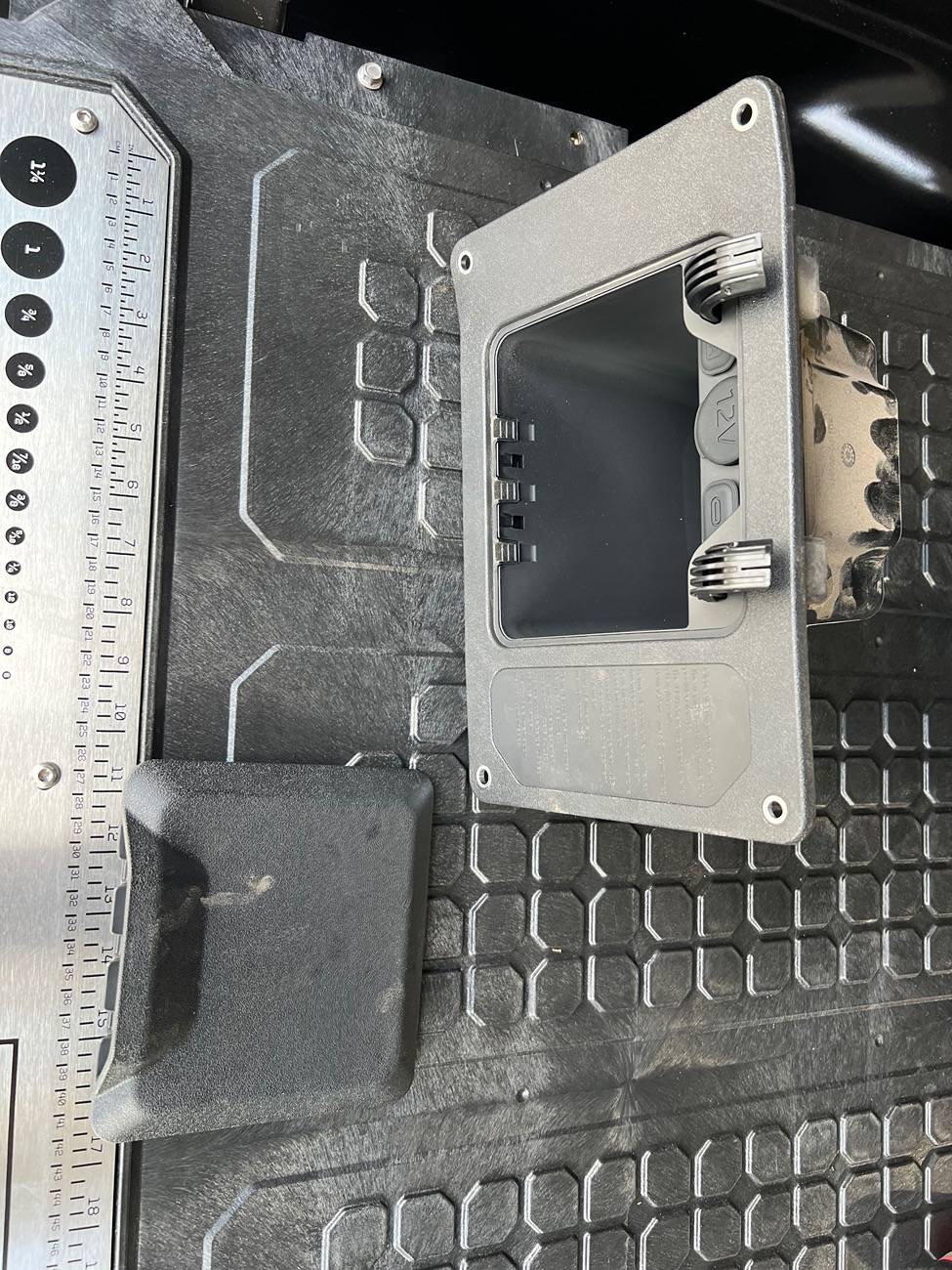

Hi all, Happy 4th! I hope you're having a good one.
I completed the USB/12V charger cover mod for the Decked system and wanted to just share some pictures. Overall pretty simple and straight forward process. I used a small hack saw to cut the cover, but think a Dremel Wheel would be a better tool. I also used 4 magnets on the cover instead of the 3 recommended by the instructions. Finally, I swapped out the D-ring tie downs with the Charvonia Designs ones, and swapped the handle on the drawer to black, to keep my "blacked out" theme going.

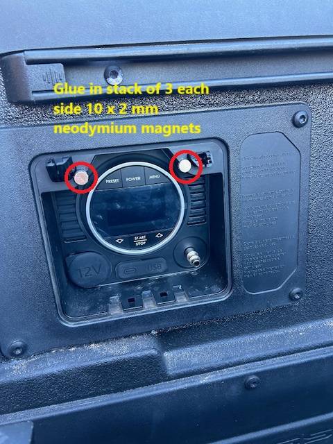

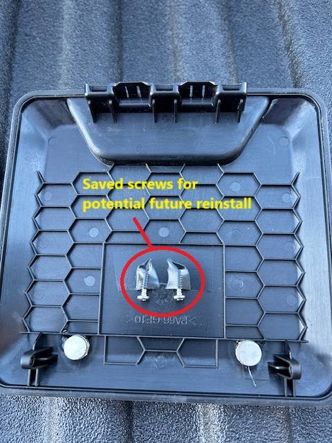

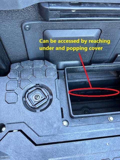

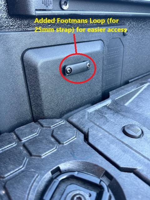

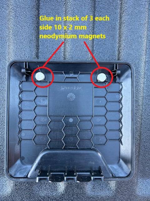

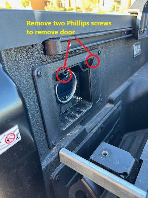

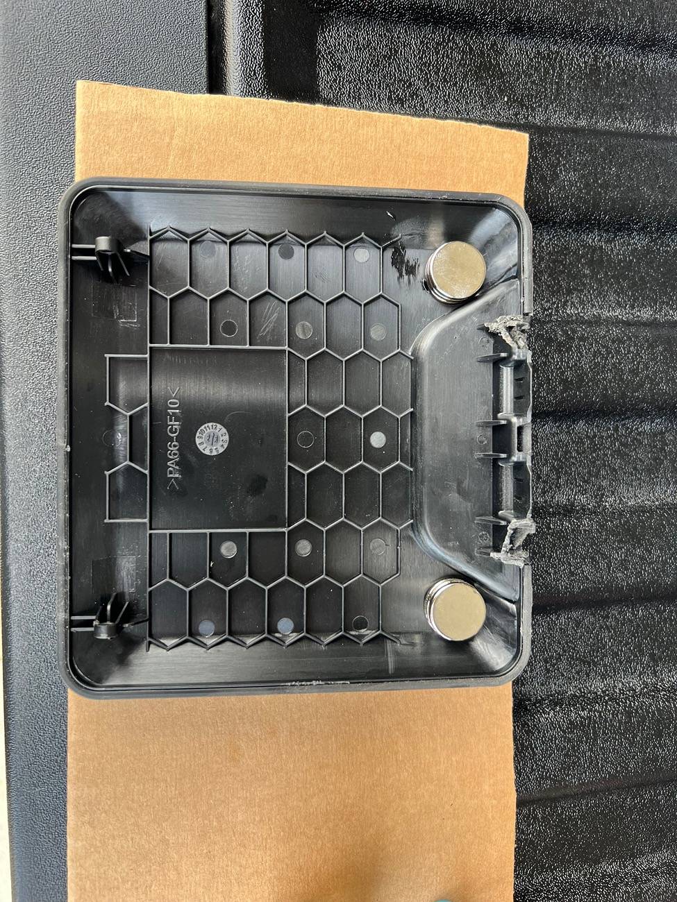

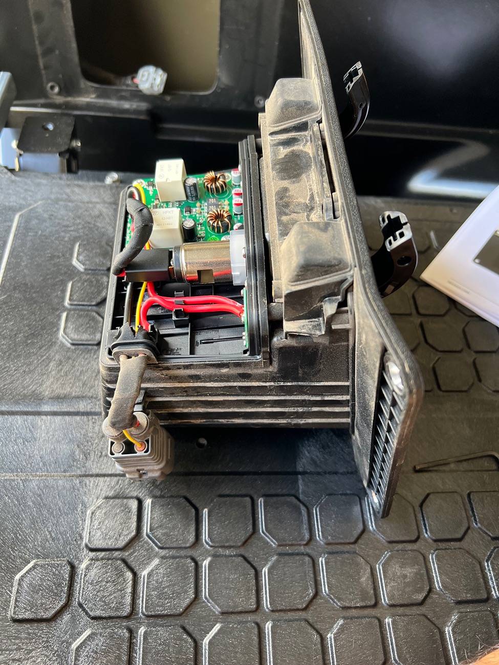

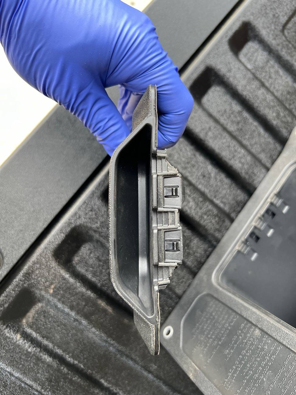

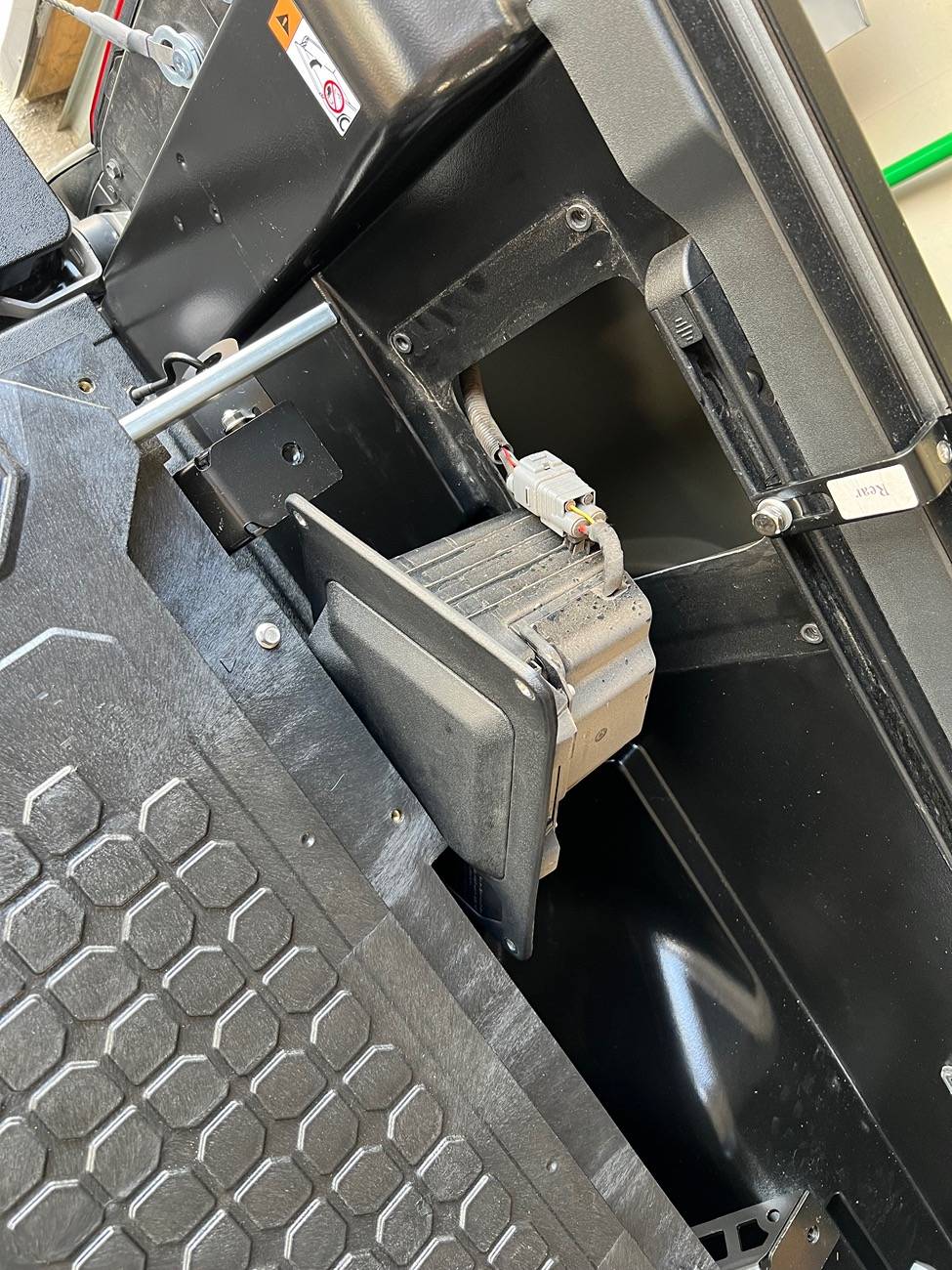

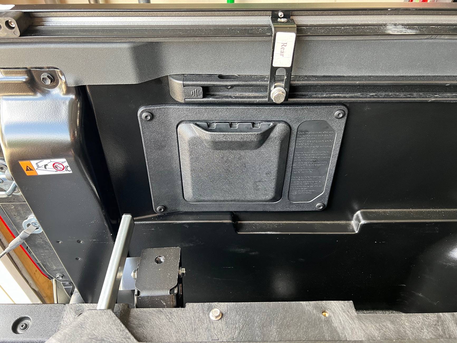

The lid flipping that came with the Decked instructions felt a little too invasive for my taste, did this instead:

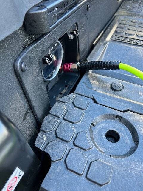

hey there- appreciate all the info youā€™ve posted.
Curious on how well the air hose cleared or if you had to further mod to get good clearance.

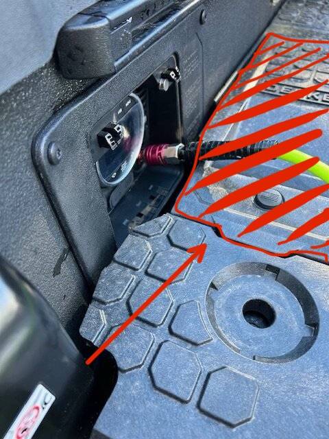

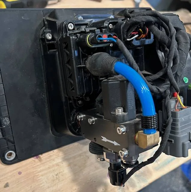

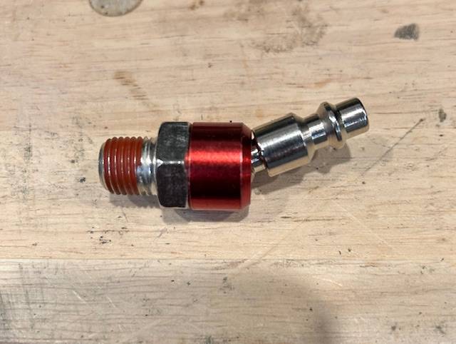

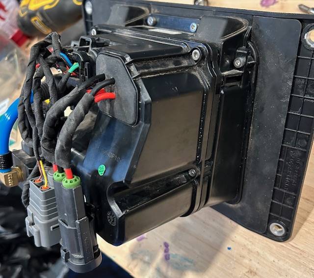

The air hose did not clear, the angle interfered with the connector. removing and altering the factory box to accommodate a swivel connector was a pretty extensive mod. The instructions that came with the Decked system for flipping the lid works for a power accessory configuration but absolutely does not take into account the Trailhunter compressor setup, it is a lot more complex. I posted a series of photos on TW, but here's a couple to give you an idea:

I like your swivel fix. Looks like it works well enough to get by.
Iā€™m just curious ā€¦ this plate looks like itā€™s removable ā€¦ is the access to the connector manageable enough with this cover removed? Like, could you use a regular unmodified airhose connector if you went through the trouble of removing that cover Every time you needed it?
iā€™m pretty much ready to pull the trigger on a decked drawer but this is truly my only hangup. Iā€™m grappling with the total lack of storage in this truck and other than this one issue a decked system solves it for me.

With the hoses and connectors I had, no, couldn't get the connector to engage even with the stash bin cover off. That being said, you may be able to find a shorter connector, or as someone else had mentioned get a swivel female end and it might work. I started down the rabbit hole with putting the male swivel connector on and just kept going until I made it work and I'm happy with the result, but can't say I'd do it again given what I know now.
