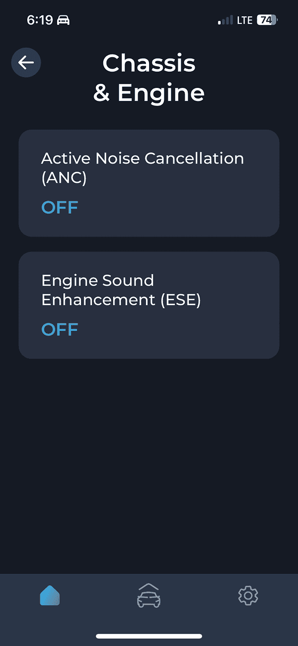

So I just connected Carista and “disabled” the “fake” engine noise. After that I drove a few miles to see if I could tell a difference…I can’t. It sounds exactly the same to me. Maybe others are hearing or not hearing something I’m missing? The option is there to disable engine sound enhancement and separately ANC. I only disabled the engine sound enhancement.
My wife has a BMW and I have used Bimmercode to change numerous settings in her car but I have found a few that even though I changed them in the app they did not change in her car. Maybe the 4th gen Tacoma is the same way in that regard.

I noticed that before turning it off, the fake noise was like a slight grunt in acceleration. It's quite constant and different than the clacking, fan, and turbo air sound.

After more driving and listening I do seem to here what your talking about. The grunt or deepening of the sound is under normal acceleration especially from a stop. It's almost like it adds bass to the engine note under low rpm load. That being said it is not a pleasent "grunt". I think I will leave mine off.

It was the Active Noise Cancellation (ANC) that was interfering with the new subwoofer. I also disabled the engine noise enhancement (ENE) . I really didn’t notice much of a change. The seatbelt chimes are history!!
