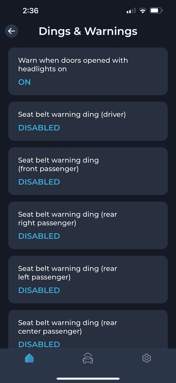

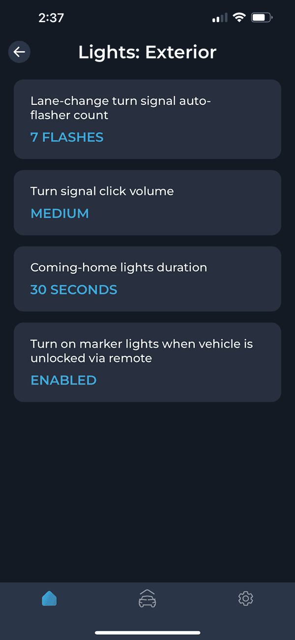

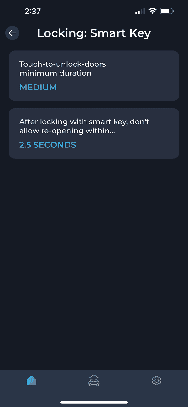

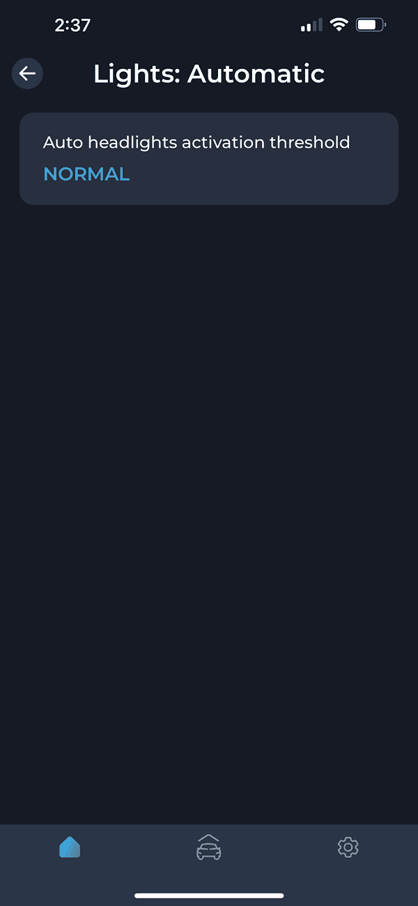

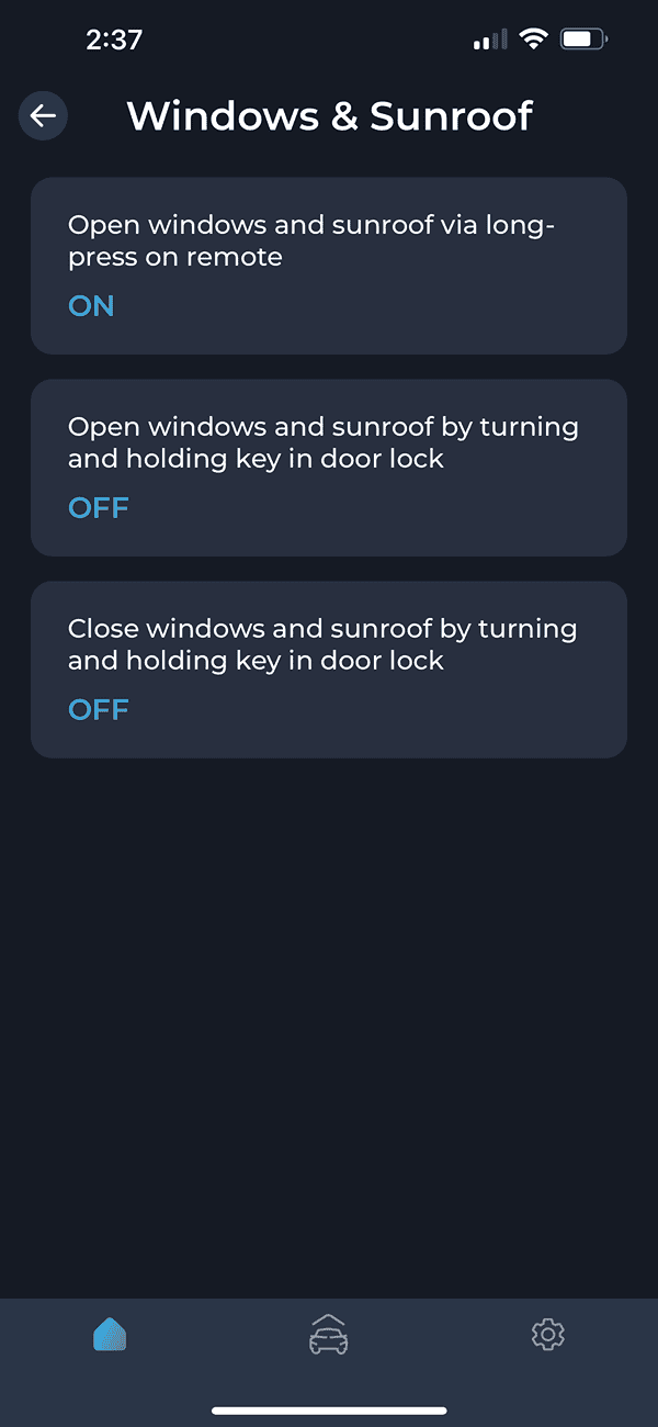

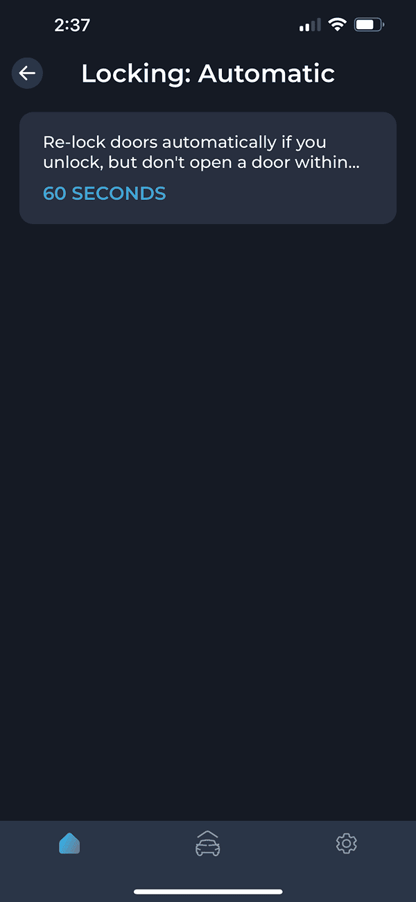

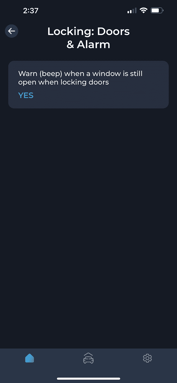

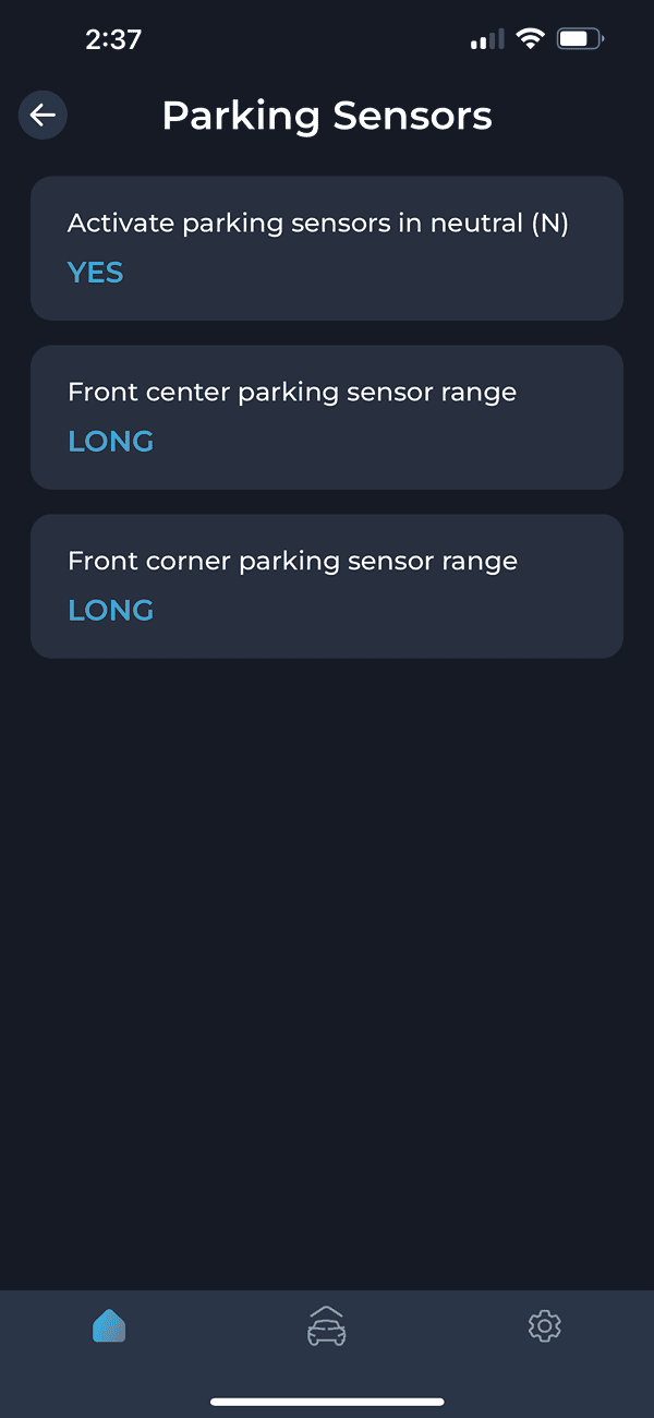

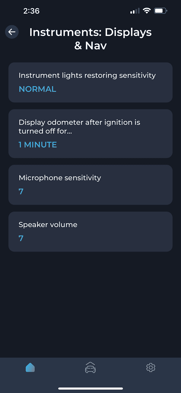

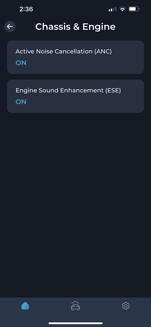

I finally got a chance to use my Carista. $9.99 subscription which I canceled immediately was totally worth it for these three things:
1) Change my blinker tap to 7 flashes instead of Toyota’s standard of 3 flashes. Since I only use tap on the highway, 7 flashes is perfect for changing lanes at highway speeds. If I’m turning in town, I’m not tapping the blinker, it’s a full-on engage at that point.
2) Auto-down of all windows with the keyfob
3) Remove the annoying-ass seatbelt chimes!

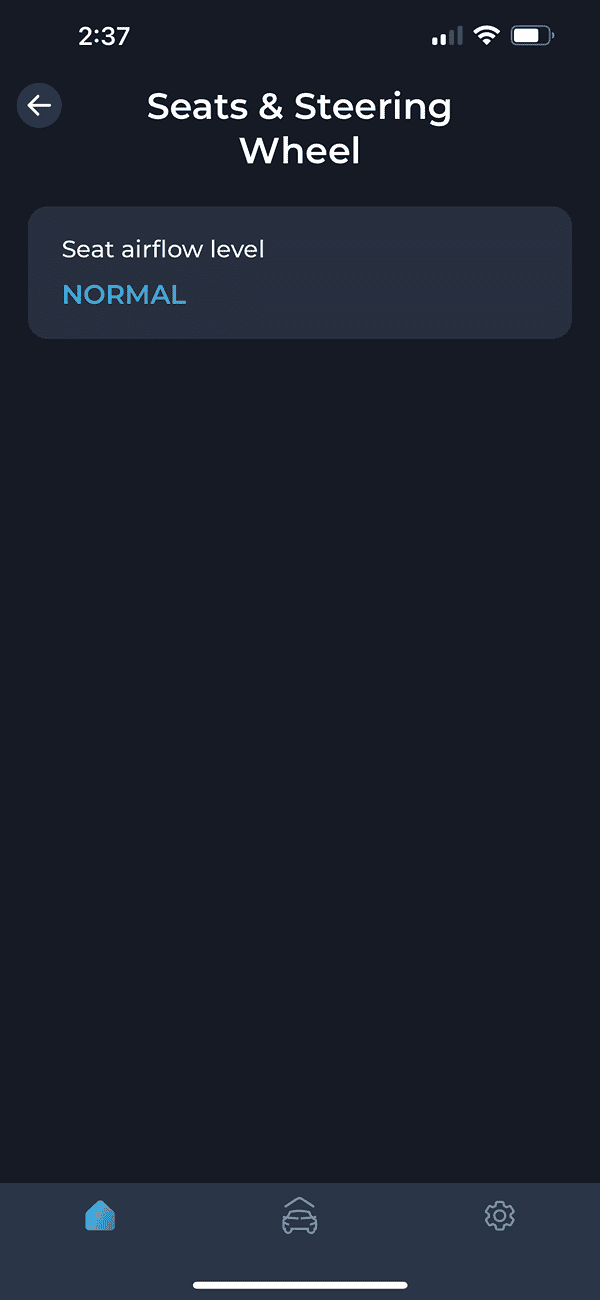

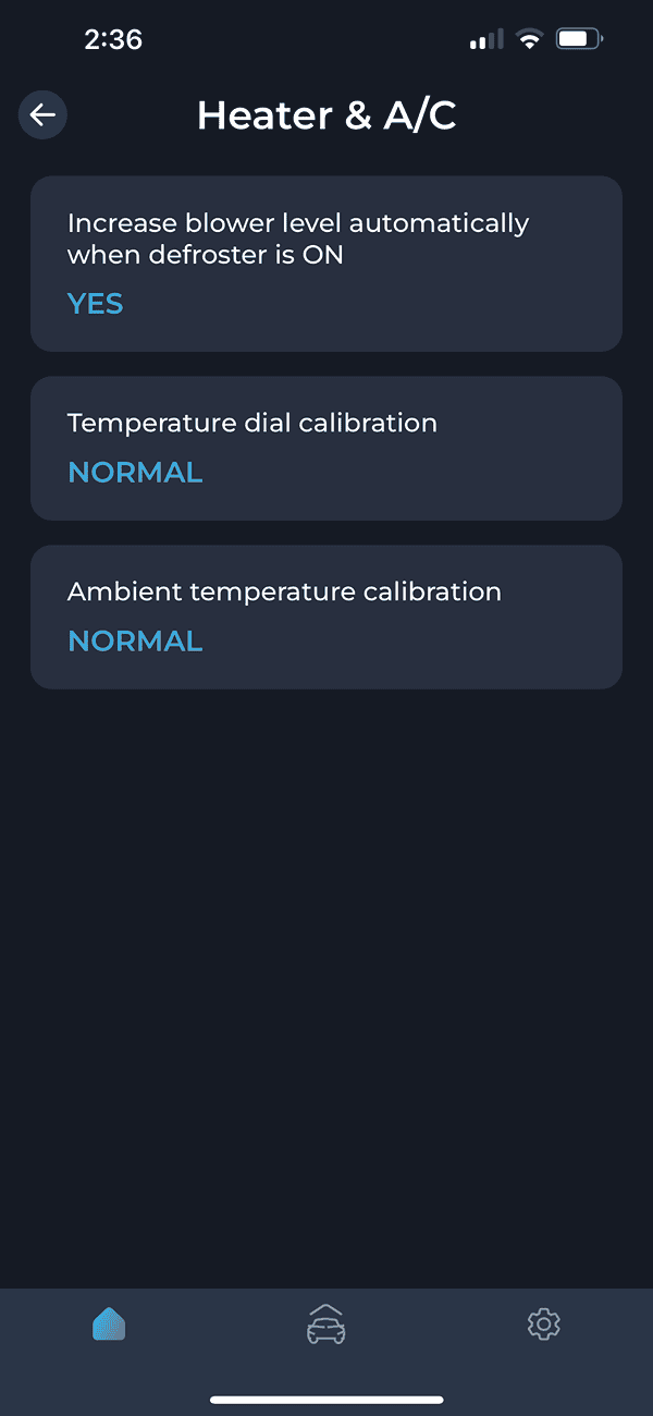

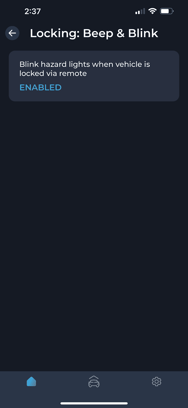

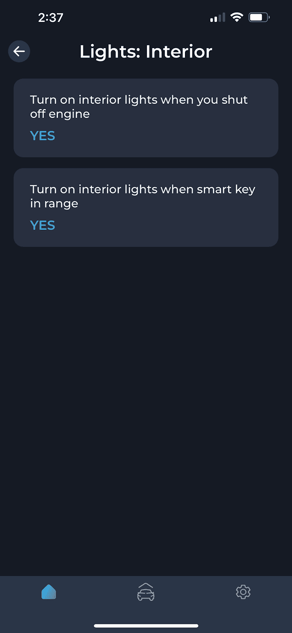

For those interested, here are all the options it gave me:

Disabling the seat belt chime and engine noise is great! I didn't realize how annoying the engine noise thing was until I turned it off lol.
