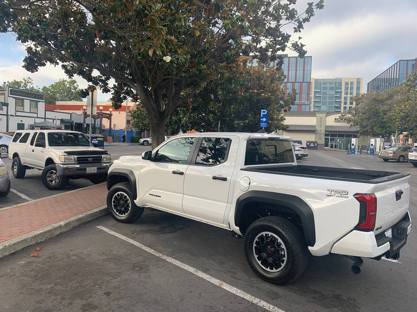

On trash day, everyone puts the cans out away from the curb, and I can’t really get out of the driveway and turn in the street, without pushing them lightly. I also do this frequently with my own safety cones, used for my own reserved parking. With my 99’ I would just push ‘em back enough to get out. On the 24’ the buzzer goes off and it locks up when I do this. Absolutely frustrating!
The other thing I find difficult is the door window ledge is higher (or I sit lower), and I can’t really see parking space lines without opening the door. Again, this causes the transmission to disengage and park.
Anyone else irritated by this? Can either of these safety features be disabled?
