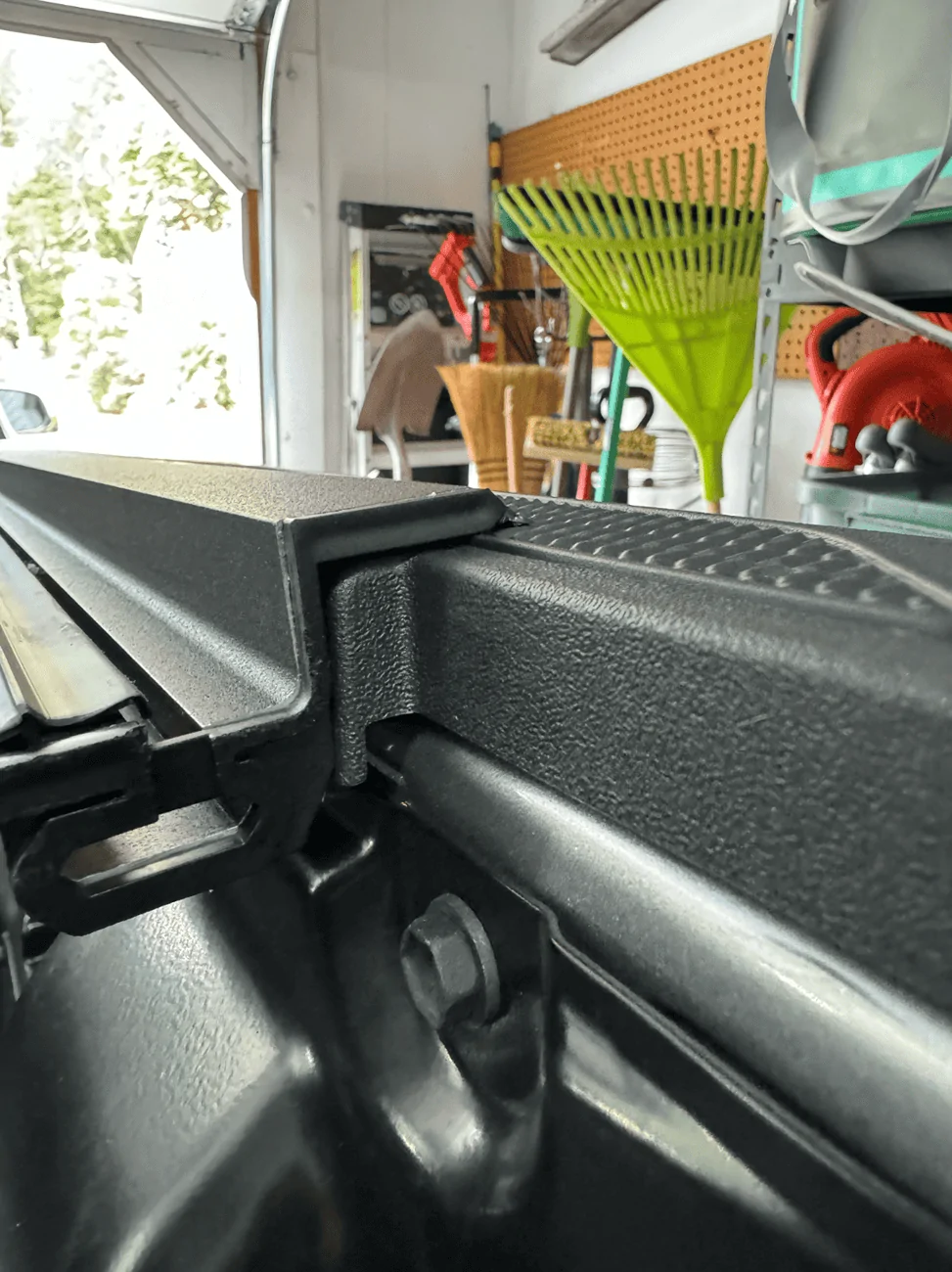

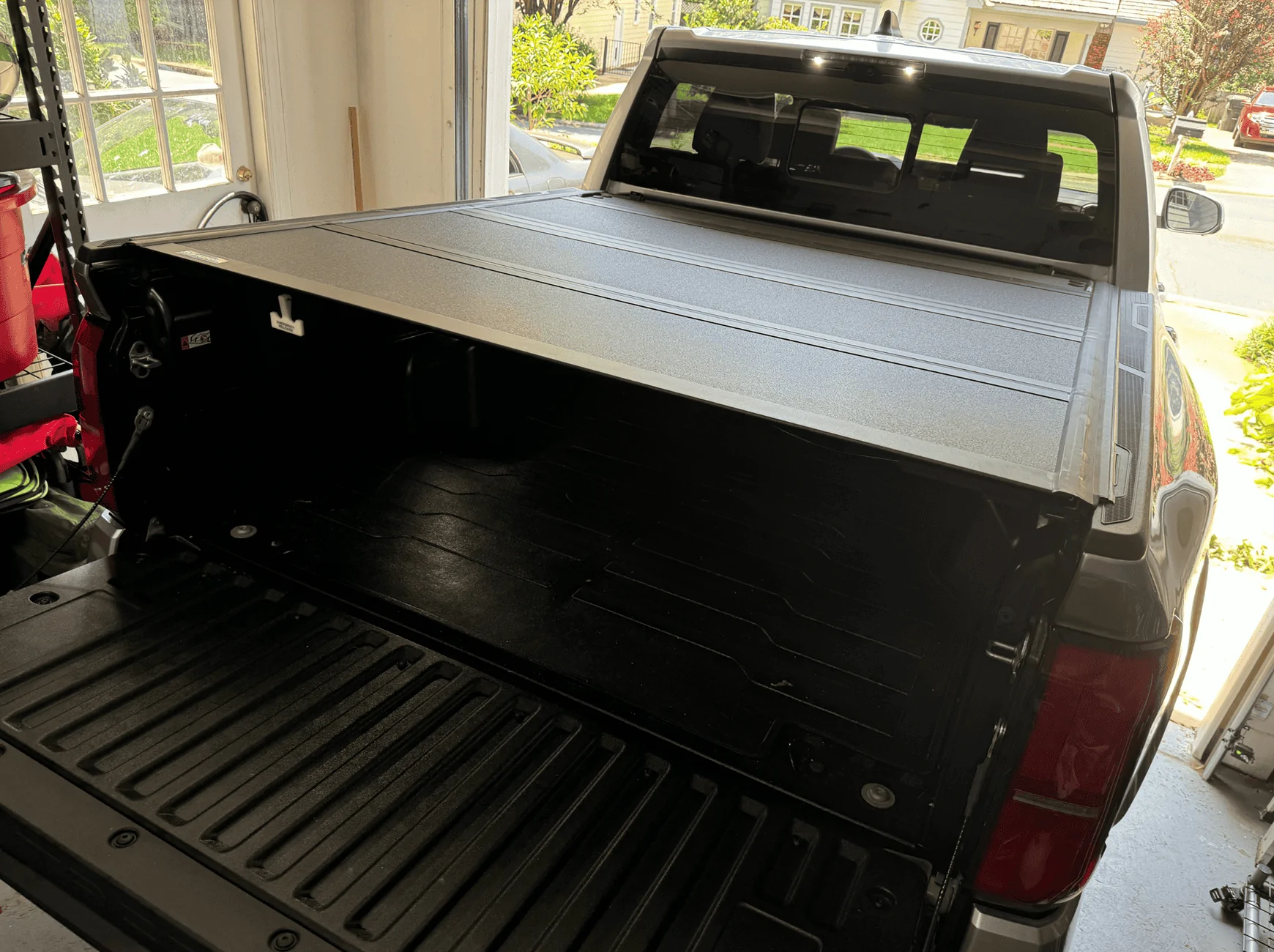

I installed my OEM tonneau this past weekend. On the whole, installation was easy... but I will point out a few lessons learned in hopes they benefit someone else.

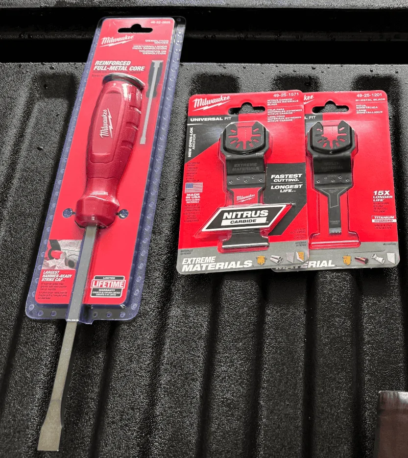

1. The TORX T30 bolts in the deck rail can be wayyyy overtorqued from factory and strip out (this was the first time I ever stripped a torx bolt). Be careful removing these and maybe start with a manual driver instead of impact driver. My resolution was to use my oscillating tool to cut a big slot in the bolt cap, and then use a big 1/2" demolition slotted screwdriver to break it free. I had to use channel locks perpendicular to the driver to get enough torque to succeed. I attached a few pictures of the bolt and the tools I used.

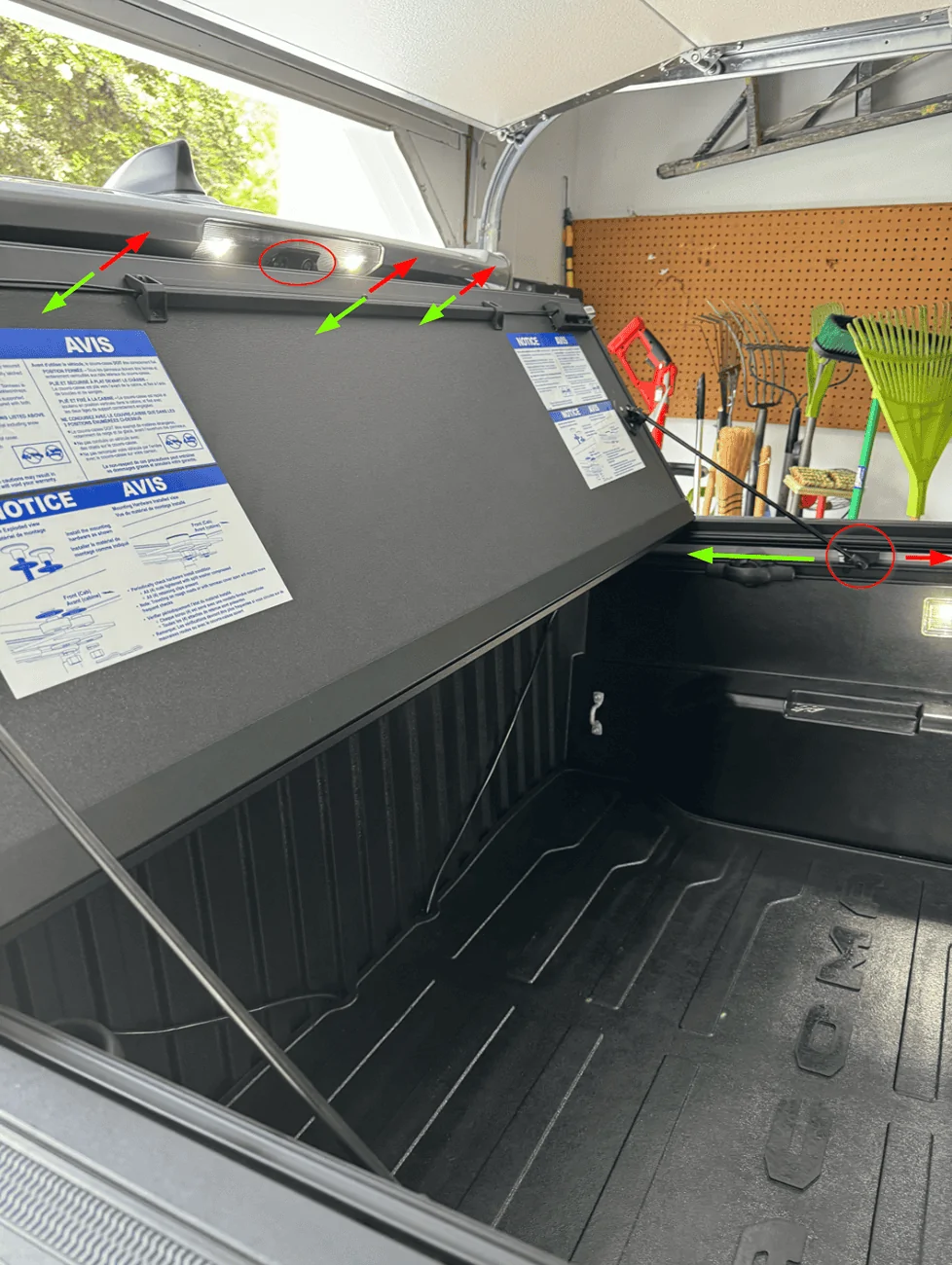

2. Starting with the rails, try to push them towards the cab of the truck as far as you can before securing. The reason, is you want to make sure the support arms (for when the cover is folded up against the back window) can reach the cover to lock in, without pulling the cover towards the tailgate. If they pull the cover towards the tailgate, it will prevent the foam pads from resting against the window, and likely block your rearview camera and/or hit against the painted part above the window. I have a photo showing where you should attempt to align the rail, and what you should try for (green arrows) as opposed to avoid (red arrows).

Hey. Great post thanks for the photos. Just curious as you mentioned installing it in that way to not block the bed camera. Does that method mean the bed camera is almost completely unobstructed or does it still block the majority of the bed camera as one user showed the photo of the view you get from the bed camera. Any chance i can bug you for a view of your bed camera feed please 🙏🏼

Sorry - I meant the rear view camera (the one that shows in my rear view mirror) . The bed camera is mostly blocked. I’ll try to get you a photo next time I leave the house.

Rear view mirror camera is just fine. Just delivered something and had the tonneau cover up and locked in place. Flipped the rear view mirror on and it was great.
