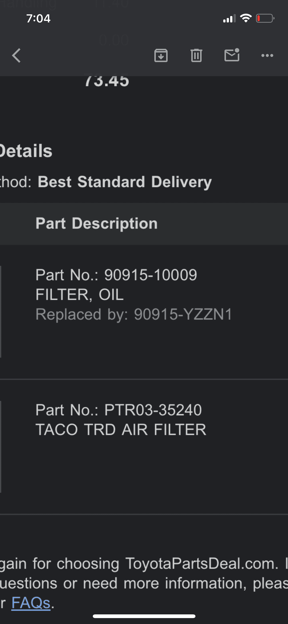

Hey, I just tried to do an oil change on the new taco and figure I’d let you guys know what I ran into. The filter number that I saw as an interchange to the 100009 filter that comes on the truck, is not correct. The thread pitch is different on the YZZN1. I’m not sure why this company switched it out or why I saw it online as a correct replacement but it is wrong.
I figured I’d save you guys some time and money and figure that out for all of us . Haha

Are you saying YZZN1 isn't compatible? I literally just did the first oil change an hour ago and had no issues using it. I noticed they weren't visually identical on the inside, but it threaded on just fine. 😬

I restarted the thread 5 times. Maybe bad threads on the first one I had. Never tried the other one. I wasn’t about to force it on.

90915-YZZN1 is the correct filter. It’s listed in the parts catalogue and was a match to the one that was already on the truck.

YZZN1 worked for me. Sounds like you got a bad one.

I must have. Oh well, hopefully the company sends me a replacement. On another note, oil changes are a lot easier/cleaner on the new truck vs my old 2.7 3rd gen.
