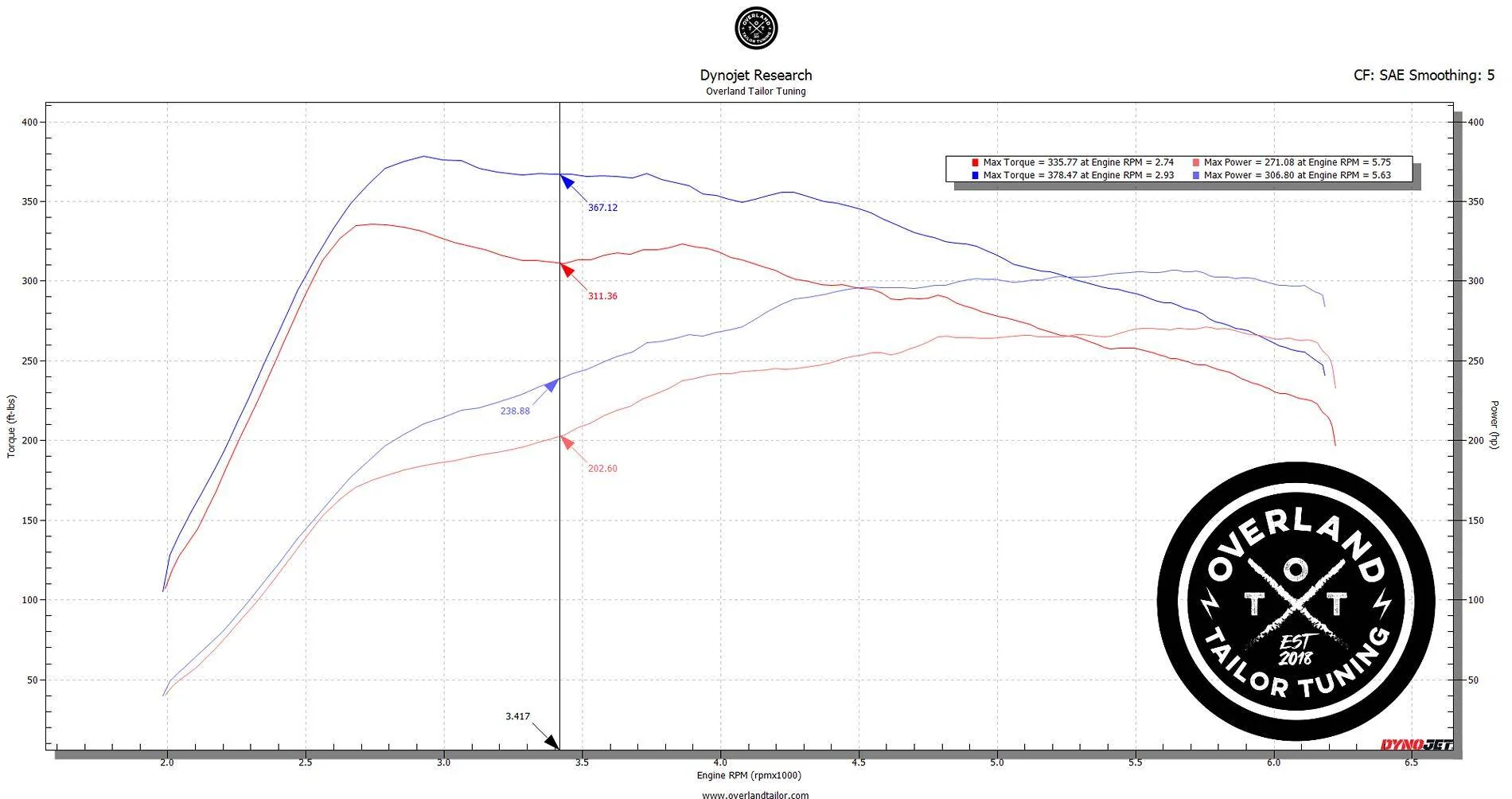

Hey guys! Hope everyone had a wonderful holiday season!
It's been a while, but we've been hard at work with development. We're making progress and have the transmission details worked out giving us control by drive mode status and other developments. I wanted to drop in and remind everyone that we've not forgotten or slowed down our push to bring something fun and exciting to the 4G Tacoma!
If you're interested in a sneak peak of what's coming/possible with this platform, below is a run from a Beta file which is compatible with Regular through Premium grade fuel (This was done back-to-back w/ premium as the baseline). There is massive power potential relative to the previous generation's N/A engines. While this chart only shows WOT power, the calibration enhancements at part throttle are as as big or larger. There is a noticeable improvement in spool and part throttle torque.
Towing trials and data analysis have shown that the increase in torque available at part throttle can improve (lower) transmission temperatures, allowing the converter to stay locked or in a gear higher than it would have otherwise in stock form.
I think the best way I can summarize the current landscape for tuning the 4th Gen trucks would be: They don't necessarily "need" a tune like the 3rd Gen did, but what is possible, and what you can gain is 3-fold what was possible on any of the prior generation trucks. These things make 5.7L Tundra torque and horsepower tuned - in a midsize!
RED: OEM Calibration (Gear Locked); 91 Octane
BLUE: OTT Beta Calibration (Gear Locked); 91 Octane

This is amazing. Can’t wait :cool:

Thanks for the update!
Are these graphs with proper 87 octane as the "regular" and are you using 91 or 93 as your premium.
Please label/legend for us

During this testing, the truck had 91 Octane in it for both the stock and tuned run. Unless explicitly stated, we'll always compare the vehicle in a "back-to-back" state to avoid confusion.
I've updated the original post.
