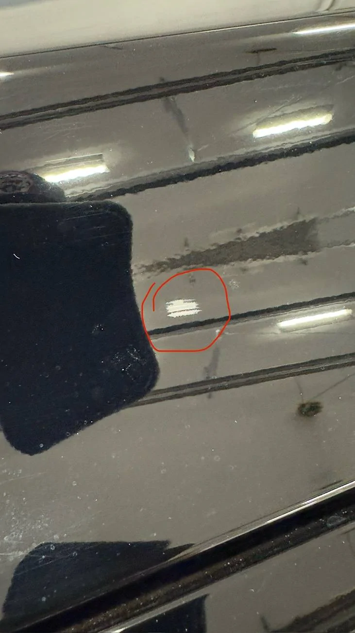

So the unfortunate happened on my 650mi road trip home with the truck only a day old I got a nasty rock chip on the side of the hood somewhere in the middle of wyoming. The chips is pretty big and deep almost down to the metal in one spot. I have called around a few placed and found a quite to fix it. they gave me two options, one for $375 to basically make it less noticable fill in the chip with paint. The other option is $950 and they would sand it down and fully respray the hood. they offer a lifetime warranty on the respray and have really solid google reviews. But what i'm struggling with is that is a brand new truck and i want it to look perfect, but on the other hand it a off-road truck that will actually get used off road and more chips and scratches are inevitable.

Same boat, brother, except mine are around the rear fender flares and fender itself (seems to be a known issue). I went the Toyota touch up paint route. When done correctly, you can achieve very good results. I would avoid having the entire hook sprayed so early on. The $350 is an option but perhaps you can achieve the same results? That first one is the worst, but it’ll get better. Won’t be the last…

I feel like non-metallic colors are usually pretty easy to touch up. I unfortunately have WCP and ended up with a couple knicks in my tailgate after I let my cousin borrow my truck (was a bad decision and I knew it ahead of time, lol).
My truck's WCP is notoriously hard to touch up (as it's a multi stage paint) but I've had really good luck with https://www.automotivetouchup.com/
I've pretty much used it and/or Dr. Colorchip on all my cars. For the automotive touchup stuff, buy a super fine tip paintbrush. Take it easy and don't over apply coats. For colorchip, apply, smear, wipe, and repeat.
I like to relate scratches, knicks, & chips to the stages of grief. First it's shock, then guilt & anger. Eventually you fix it, things may not be exactly the way the were before, but they're much better, and soon you'll forget it about it.
I wouldn't worry about it too much or overthink fixing it. Try the cheap options first, even Dr. Colorchip may work well on black.
