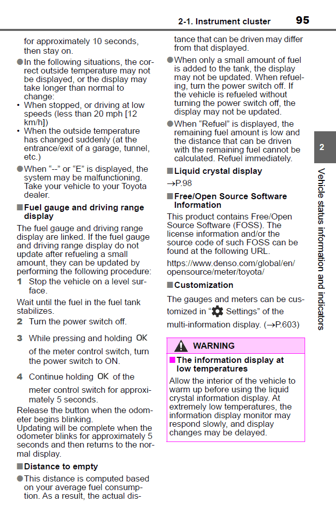

It will "learn" over time. I've tried the "small amount of fuel/manual reset" procedure explained on page 92 of the manual below. It think it helps "accelerate the process" of getting more accurate. That said, I have a 24 Taco Pro, getting around 21/22 mpg and still the tank/full miles to empty is only 252. We'll see. It is annoying.
