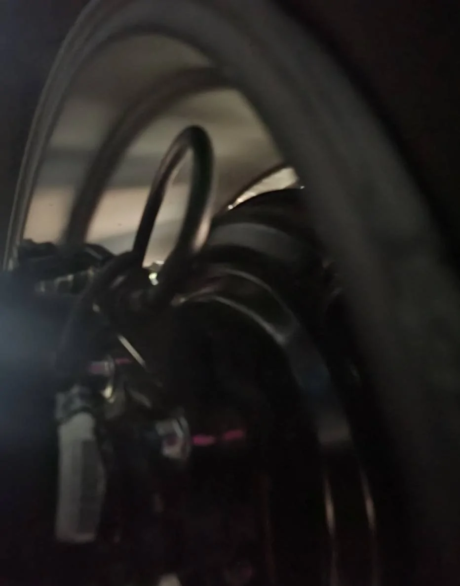

Anybody know what the planned fix is? Replace the lines with steel? Reroute?
Hopefully reroute! They loop up about 3-4 inches! Awfully close to the wheel.
2024 Tacoma RECALL for Brake Hose Issue: 2024 Tacoma 4WD 4-wheel drive models w/ 16-inch brakes and 17-inch Toyota wheels IMG_5968

I’m always amazed how a team of engineers couldn’t foresee a problem with that design on an off-road truck. Nobody thought wow that brake line is very close to the wheel….
You'd think! But they design these new ones to be used on the city streets and highways to compete with the car market knowing most in North America will never be on anything rougher than gravel roads.

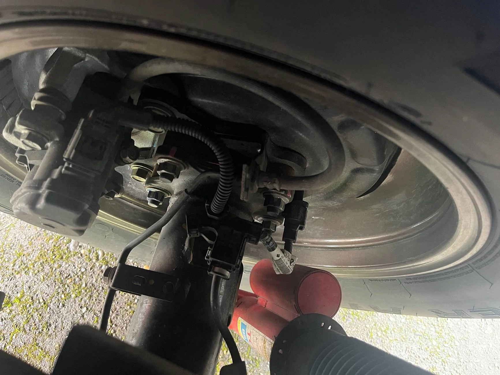

I’ll be interested to see what the fix is. Could be a zip tie. Doubt it would be anything more than replacing the soft lines. Maybe an angled or offset port fitting?

Just looked at mine. It's not horrible close, but I could see a bunch of mud. I'm at +44 and from what I can see it wouldn't matter if you were at 0. That line is dead center of my wheel. I'm not entirely sure how they're going to fix this. I feel like they're going to have to move the line onto the axle or maybe spin the bracket down. Either way they're going to replace lines. I don't see a zip tie doing much good.
