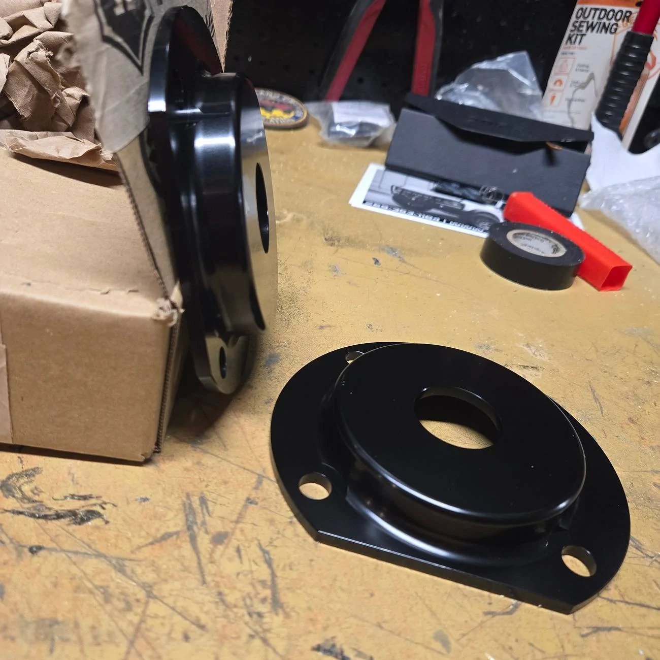

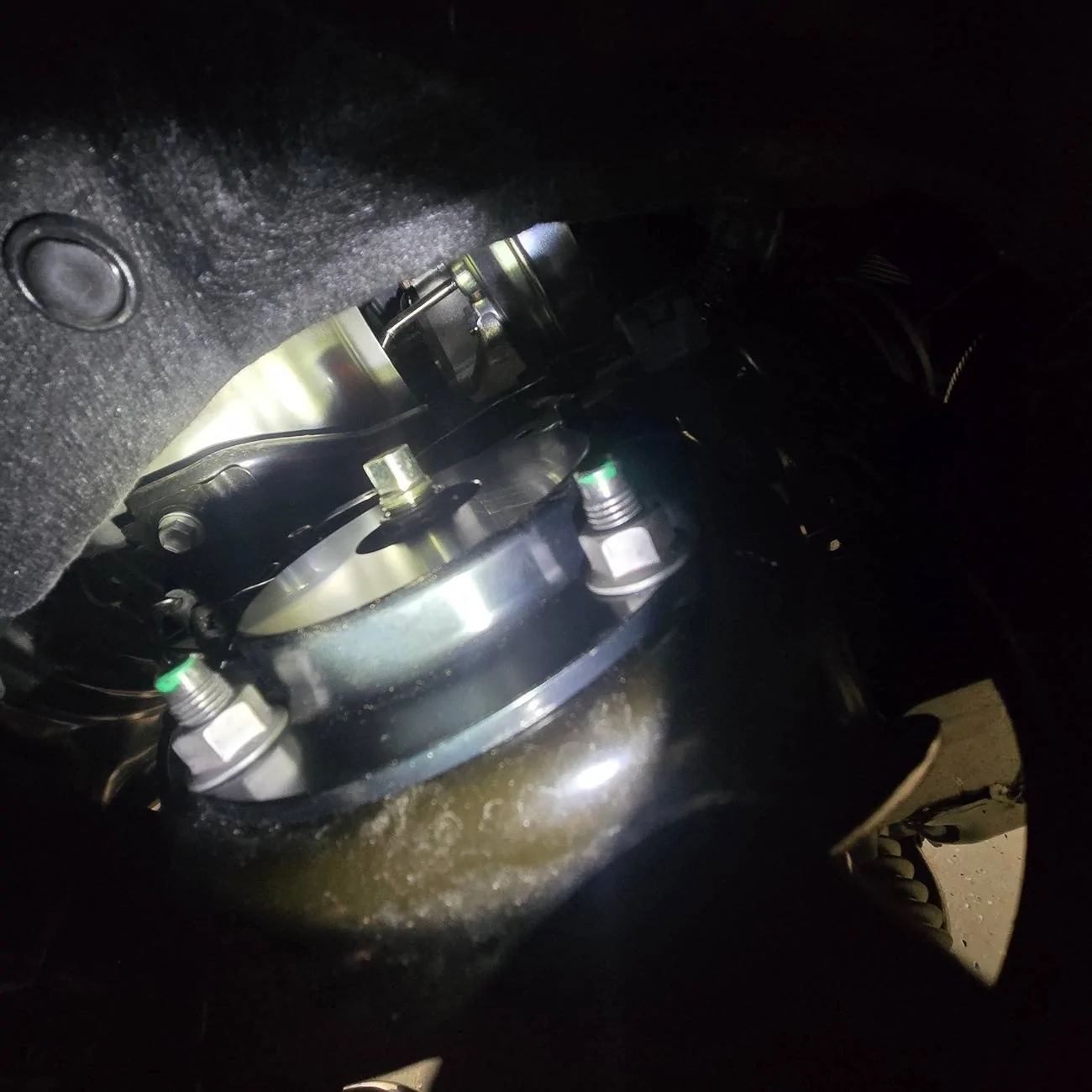

The ICON plates are the easiest install I have ever done. 5 minutes per side and a 14mm socket. In the Icon video he says the flat spot goes to the rear. That is from the direction he is facing vs the rear of the vehicle. More accurate to say flat spot goes to the engine side. There is a plate there so it is pretty obvious.
Thank you for sharing this. I plan on getting the same kit, as it seems to be an important component to remedy the issue with the shock/strut mount for the top of the shock. I was going to pay someone, but you just convinced me to do it myself
Nice, I’ll be doing mine this weekend.

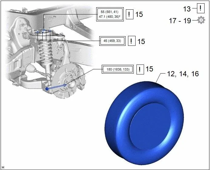

Did you use any specific torque?
I did not. It was pretty easy to loosen and I just tightened it down with a standard socket wrench. I would have been more careful with an extended length wrench

I just installed the Icon kit as well. Easy job. I had to use a 14mm flat wrench though because I couldn’t get the regular ratchet to fit in that space. Before installing I’ve had the truck off-road and in sand dunes a few times now and haven’t had any issues aside from the turbo getting really hot as turbos do.
