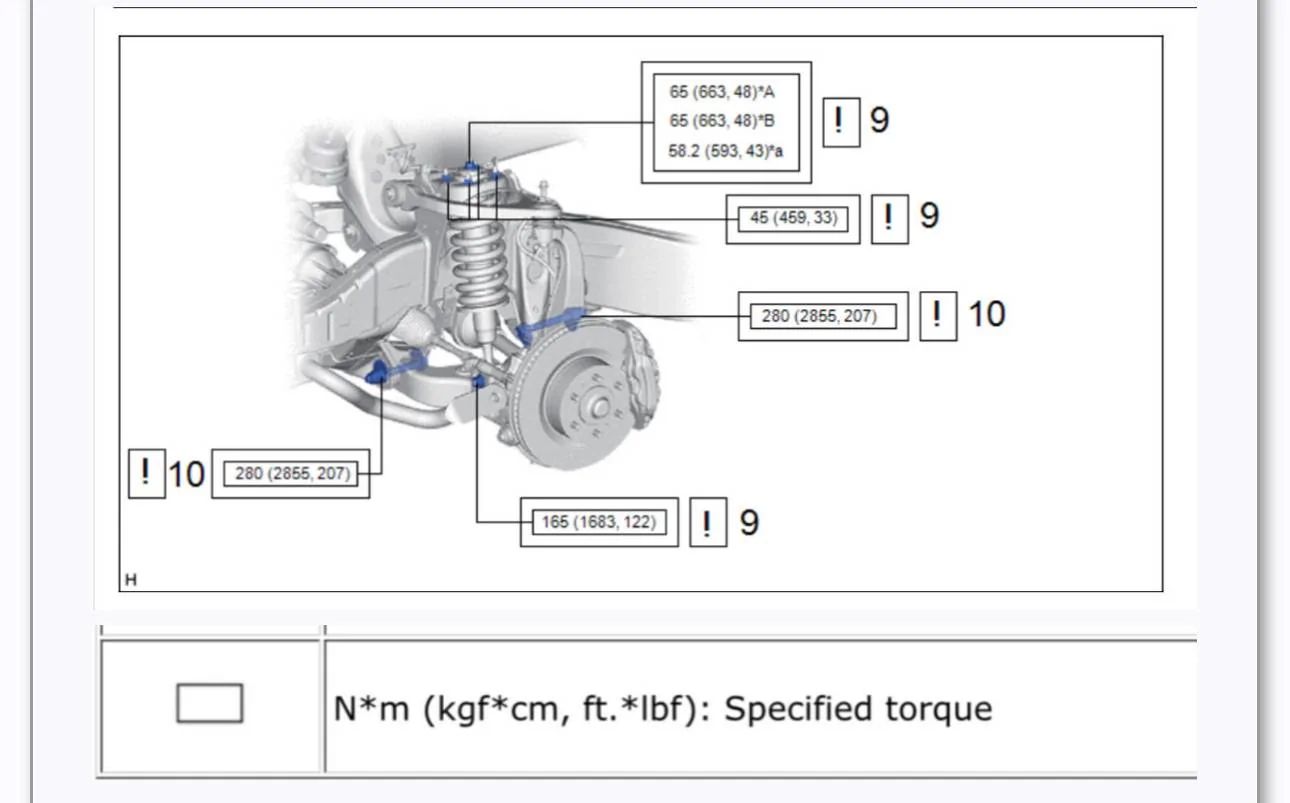

Instructions from icon said to torque the nuts back to factory spec. Does anyone know what those nuts should be torqued down to?
CuriousTaco
Jan 13, 2023
132
142
Seattle
TRD OR Base
Found a diagram of the 3rg Gen Tundra that showed 33 ft/lb.
These should all be snug, but definitely not overtightened to avoid stripping the pressed bolt grooves (not so much the threads). Same is true for front spacer kits that have new top bolts like the Readylift kit.
