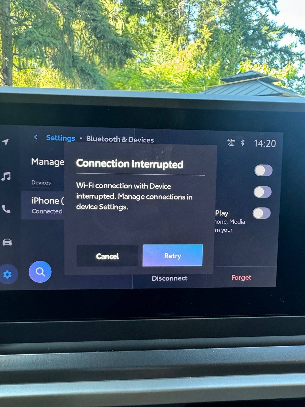

suddenly after working fine previously my apple car play will not connect wirelessly at all. All that shows on screen for issues is this photo I added. Tried forgetting device on phone and truck. And I have Bluetooth on. Whenever I go to connect to car play wifi automatically turns off.

I have both on but when CarPlay goes to connect wifi will turn itself off every time

That’s what mine does as well.. but in 2 months I’ve only had the problem one.. Obviously yours is more problematic? Did you shut down your IPhone? Sometimes it fixes a multitude of problems?

I’ve reset my phone and will update when I try again. Not to worried as I know the new vehicle will have its bugs. If it keeps going I will contact the dealership

Issue fixed. Resetting your network settings on iPhone seems to fix the issue for now

I would in the future have your phone and vehicle both forget each other and reestablish your connection ground up.

You cannot have the truck WiFi on at the same time using CarPlay - I don’t know why but I know you can’t use both simultaneously.
