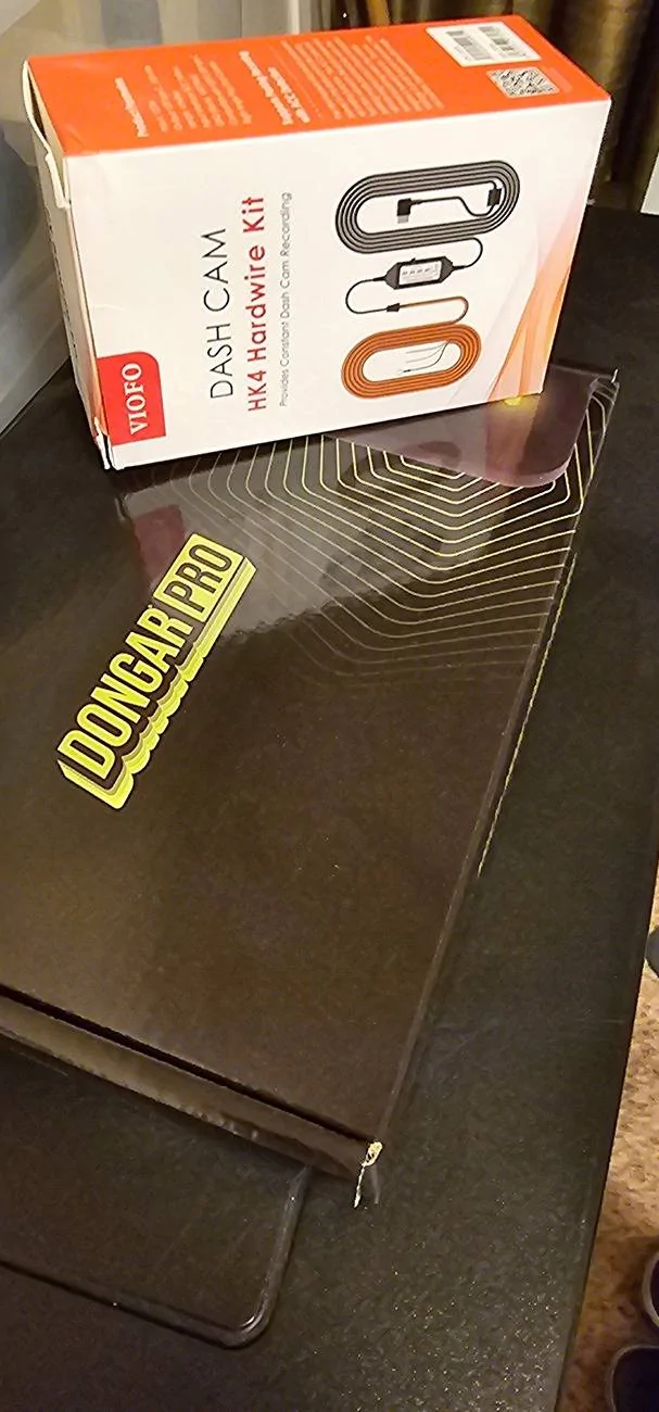

Were you able to hardwire to the fuse box and close the cover... Wanted the Dongar for a clean install
Bought the hardwire kit but trying to avoid extra fuses or a cover that won't close

You cannot. The fuse cover I just put in the glove box. The big black panel that covers the fuse box still goes in no problem. It won’t be subject to any elements. I had an add a fuse already for my hardwire radar detector so I am good. I’d rather have a good dash cam were the parking feature actually works. I bought that same VIOFO kit. Wired it yesterday. Selling the Dongar. That was a $60 mistake.

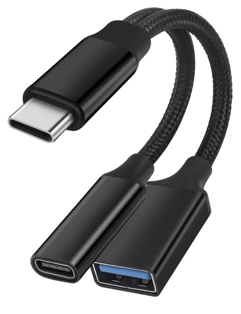

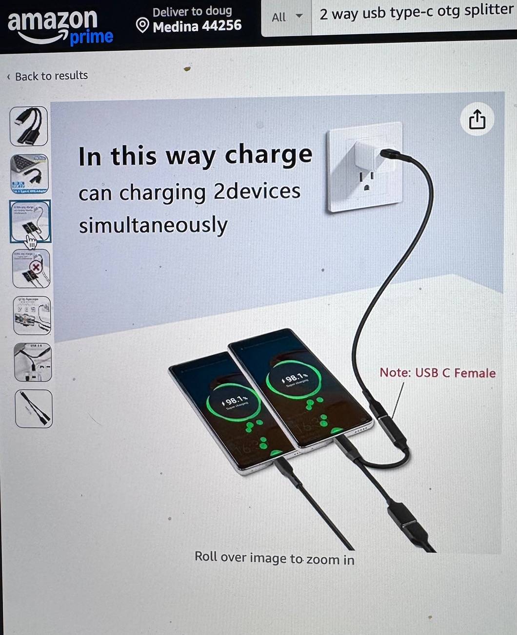

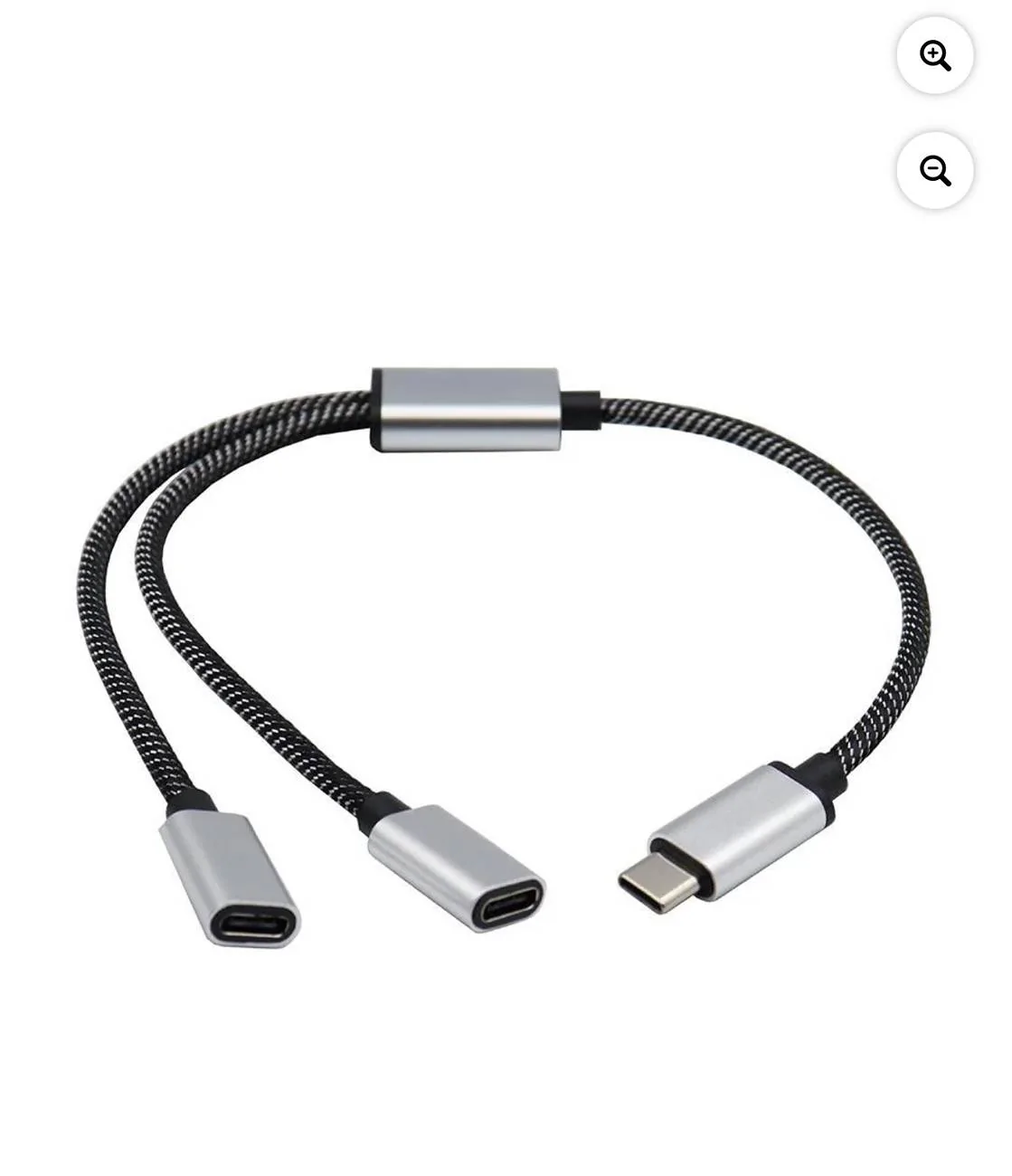

I would assume you have to get an adapter from the garmin 3 (usb c) long enough to reach the garmin 2 like a y adapter
I ended up buying something pretty close to that one, but one of the splitters had to be for a
USB -A because that’s what comes from the rear camera and I also found out that you have to be plugged in from the Dungar to the first camera 1st, and then you give the power to the second camera. You cannot plug the splitter into the Dungar itself and then give equal out to both cameras

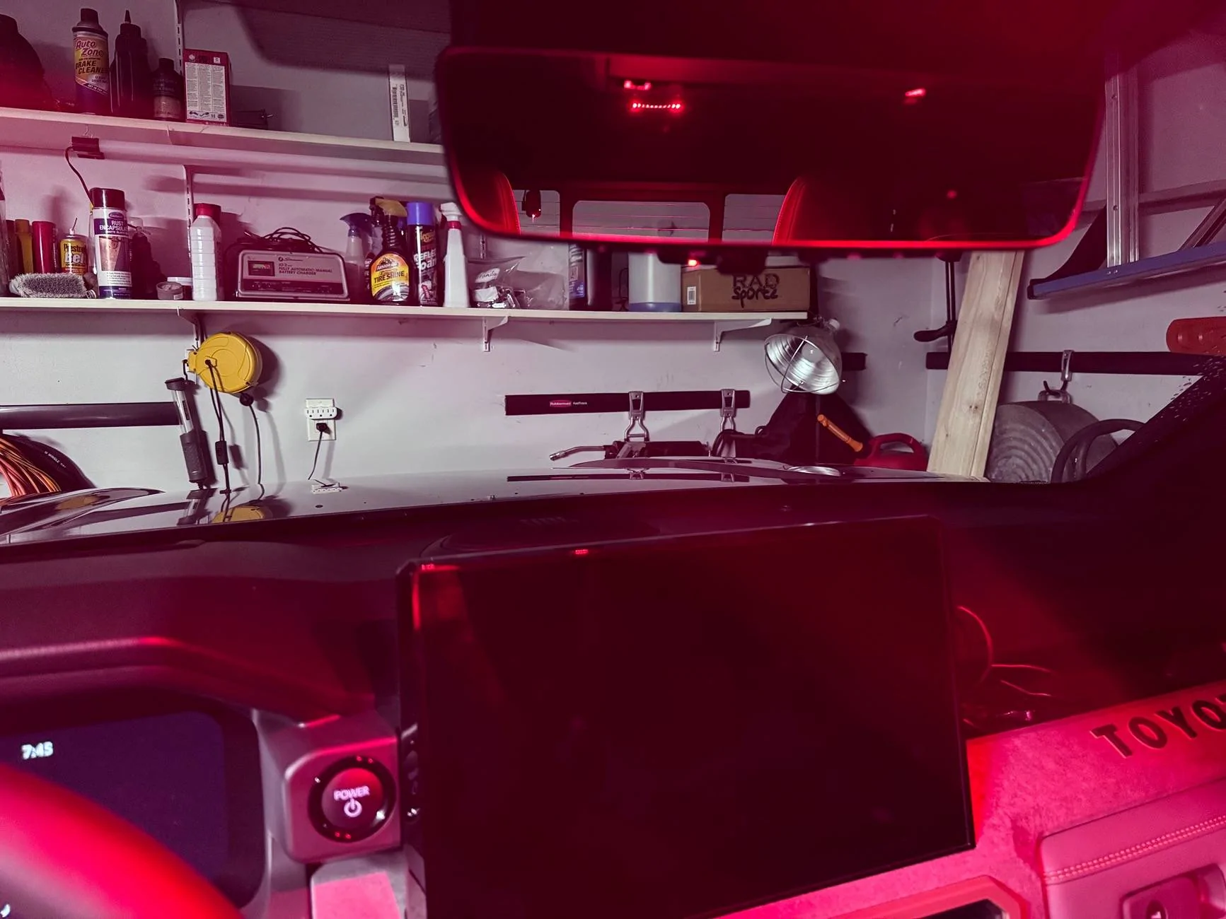

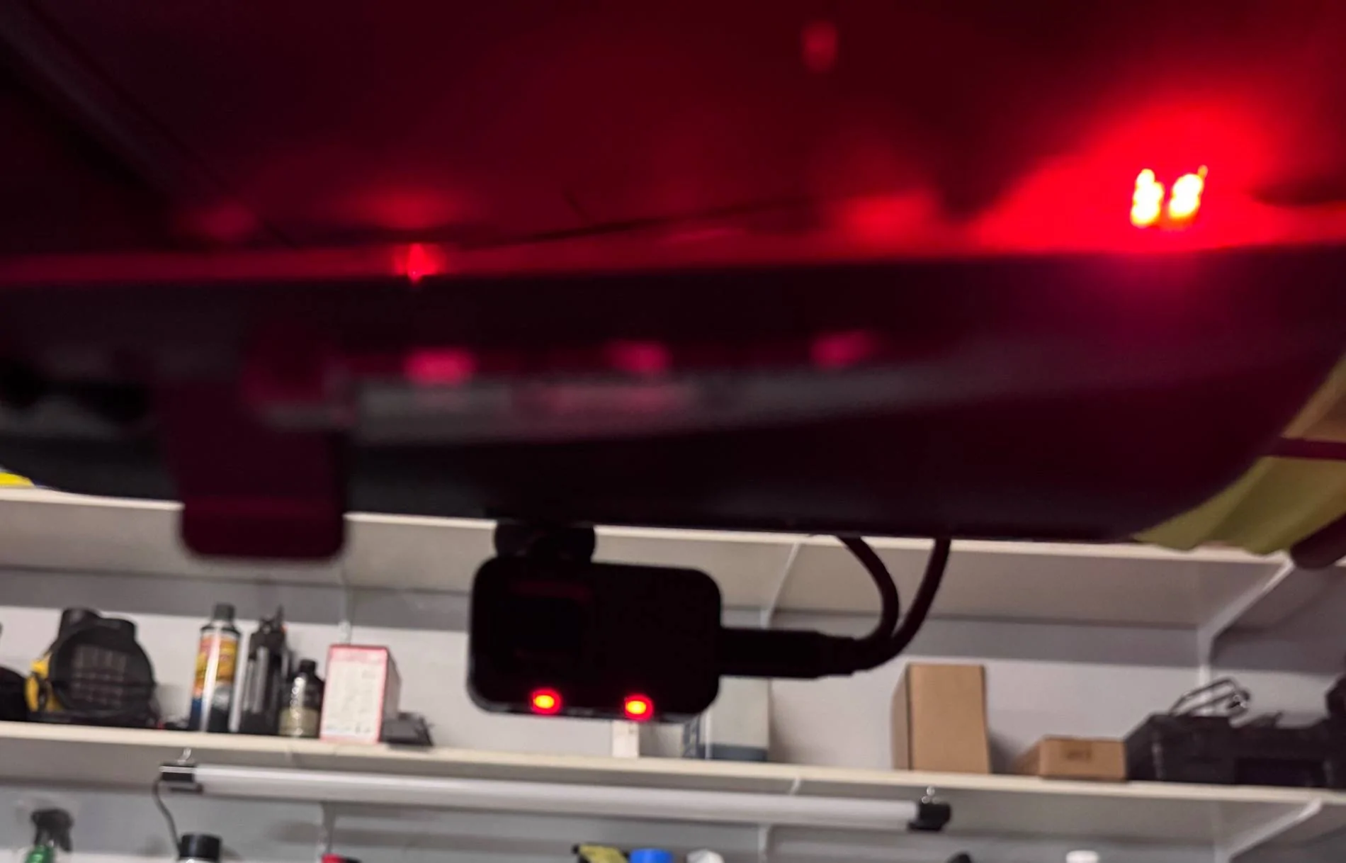

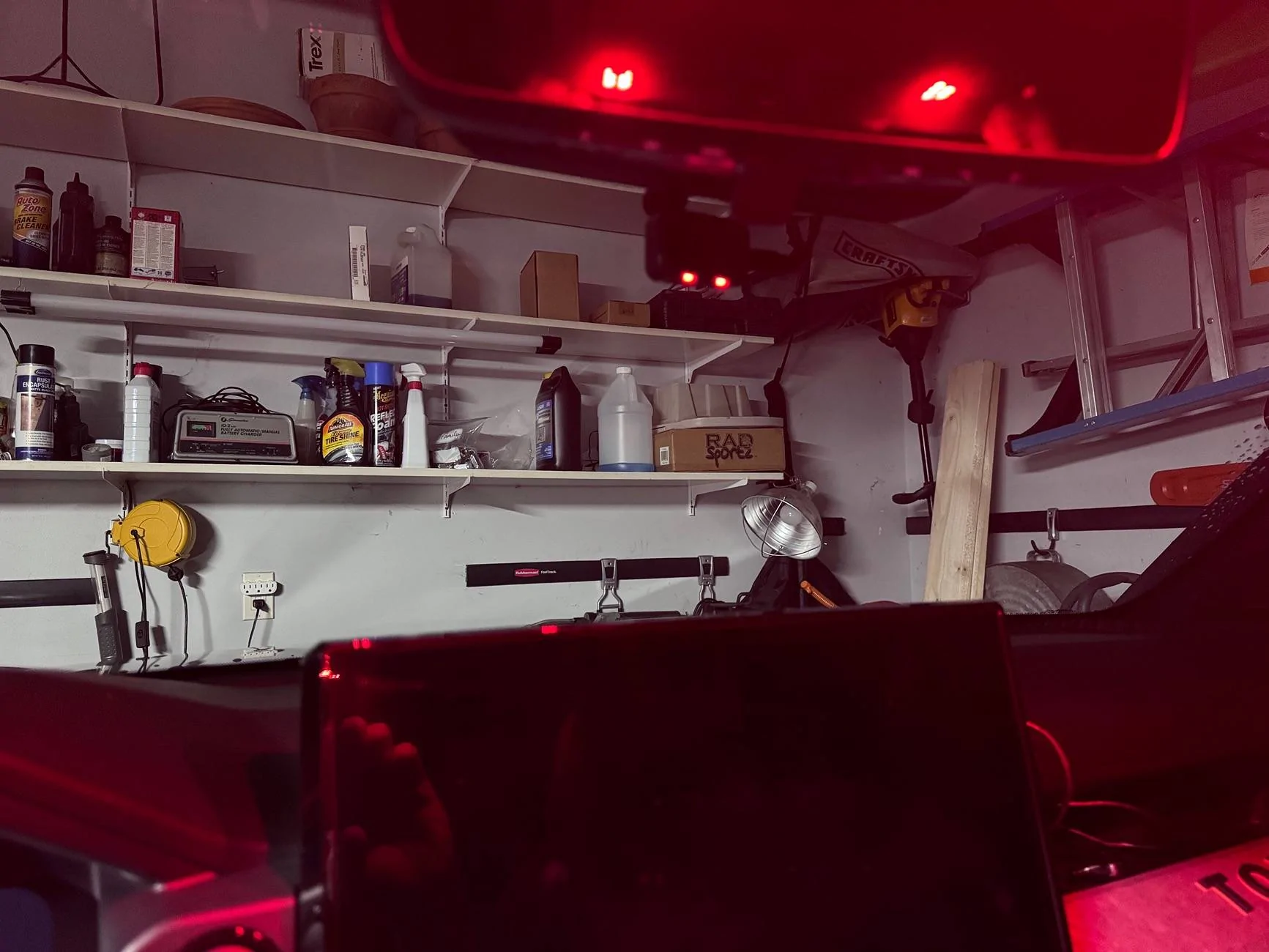

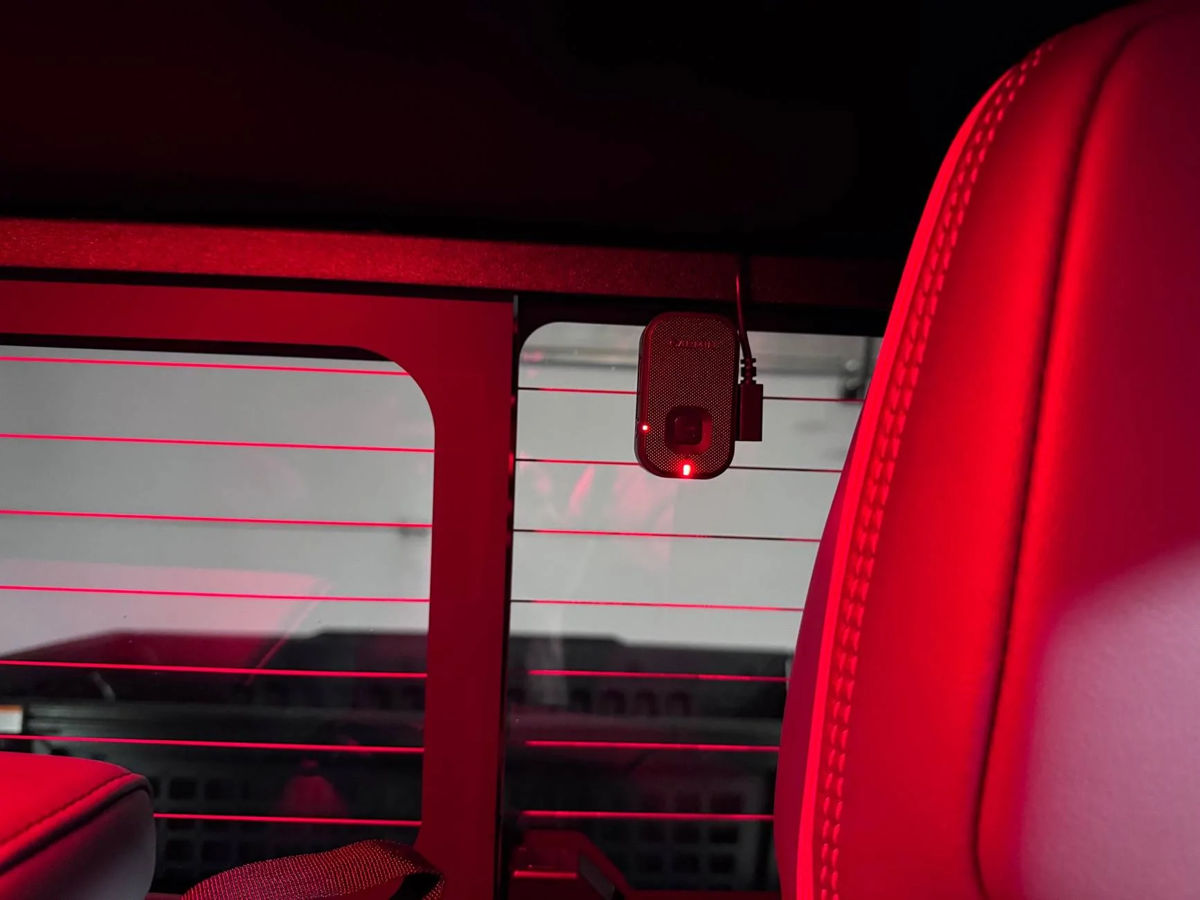

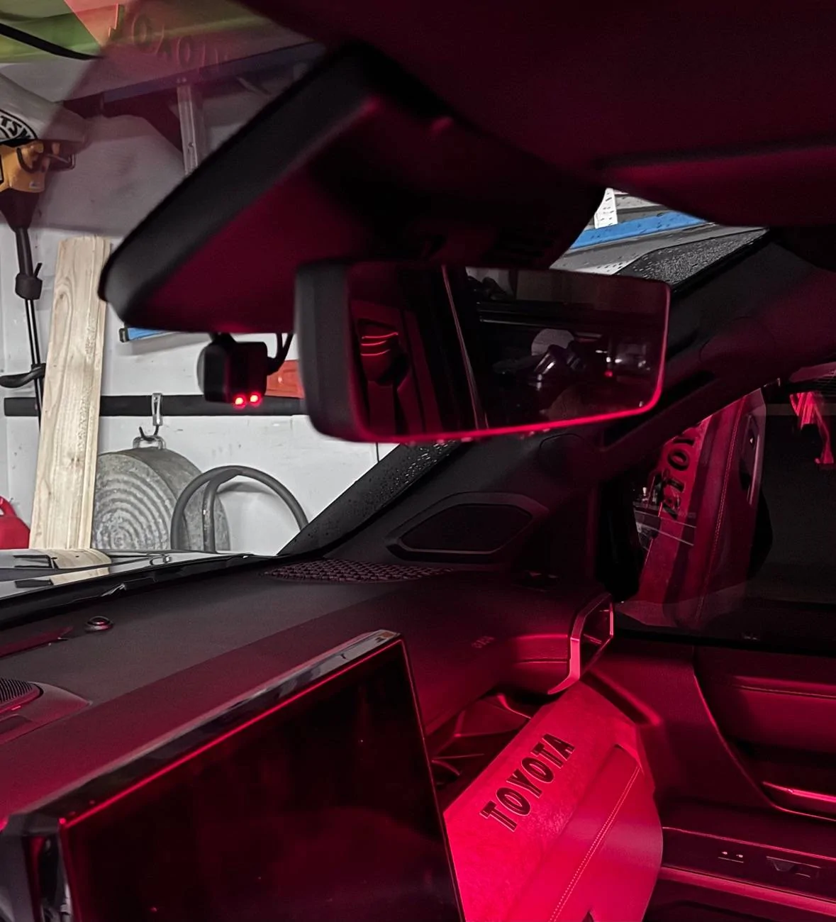

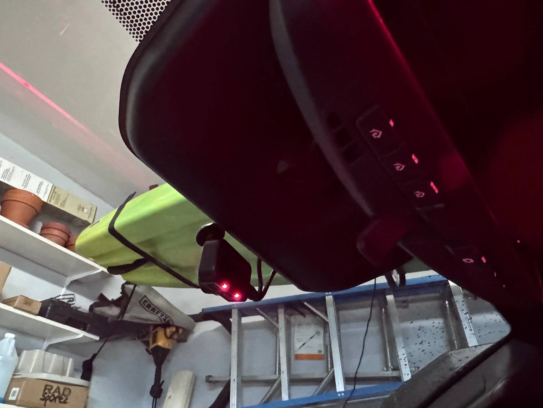

In my case, that wouldn't work to well because I'm in a double cab truck so I would lose way to much view out the back window. Just got done with the install on my 2024 tacoma Trailhunter and although it was a tight fit with everything inside of the cover above the mirror, all is working as it should.
I love how small they are.
