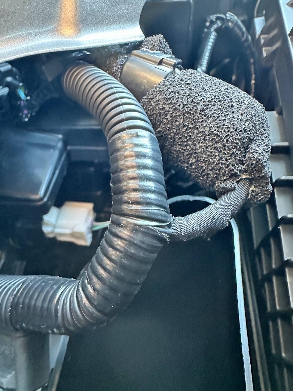

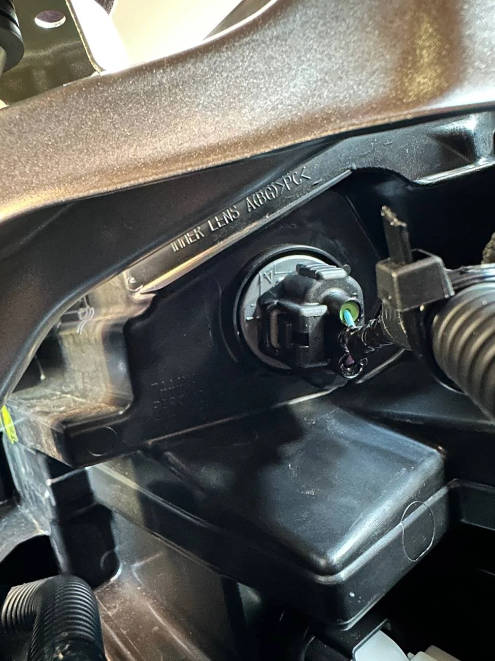

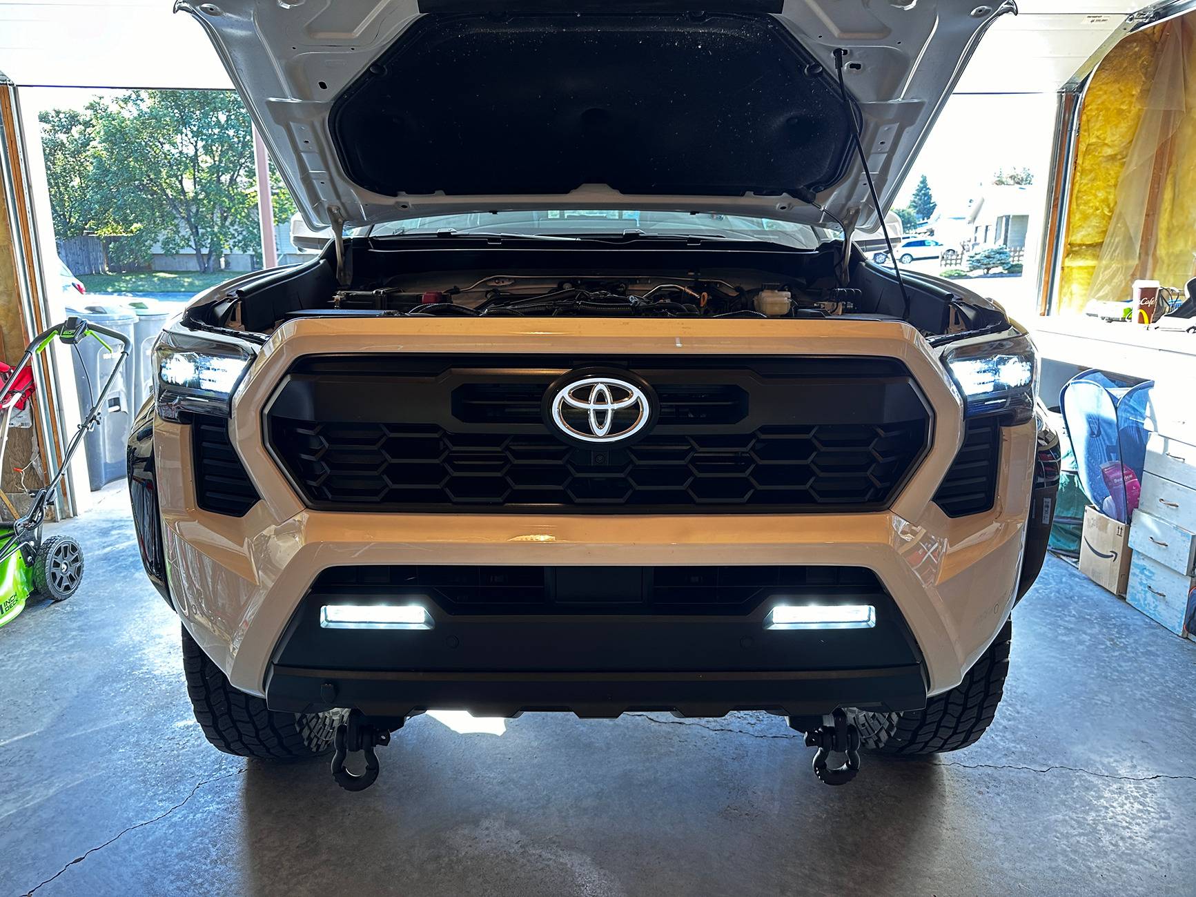

Here are some pictures of how mine is setup but it does not work with just the DRL's during the day on auto.

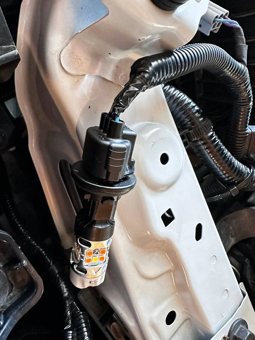

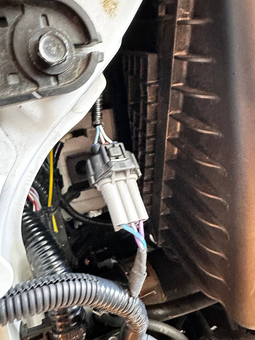

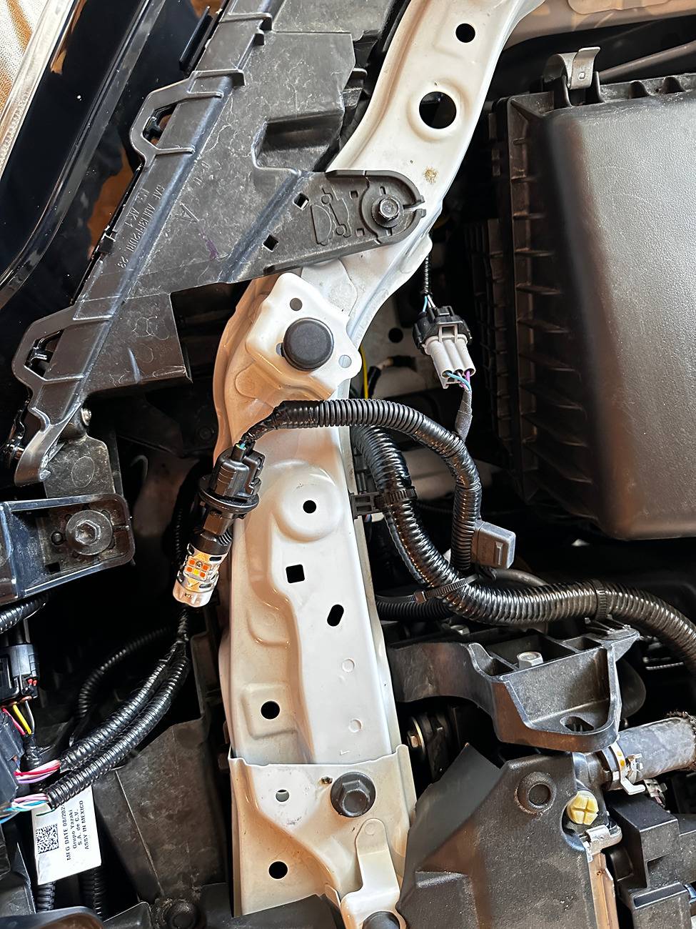

Finally figured it out. The DRL three-prong connector is the LED plugin connector. Reference the attached images for the connection to the illuminated logo connecting plugins.
Just got mine installed, I was expecting the illumination to be brighter. I was unable to see it during the day and then it was underwhelming at night. Is your like this?

How is it during the day with the drl on and headlights set to auto?
I can’t really see it, but it takes a really bright light to be noticeable in sunlight which I didn’t expect this to be, probably just a couple watts.

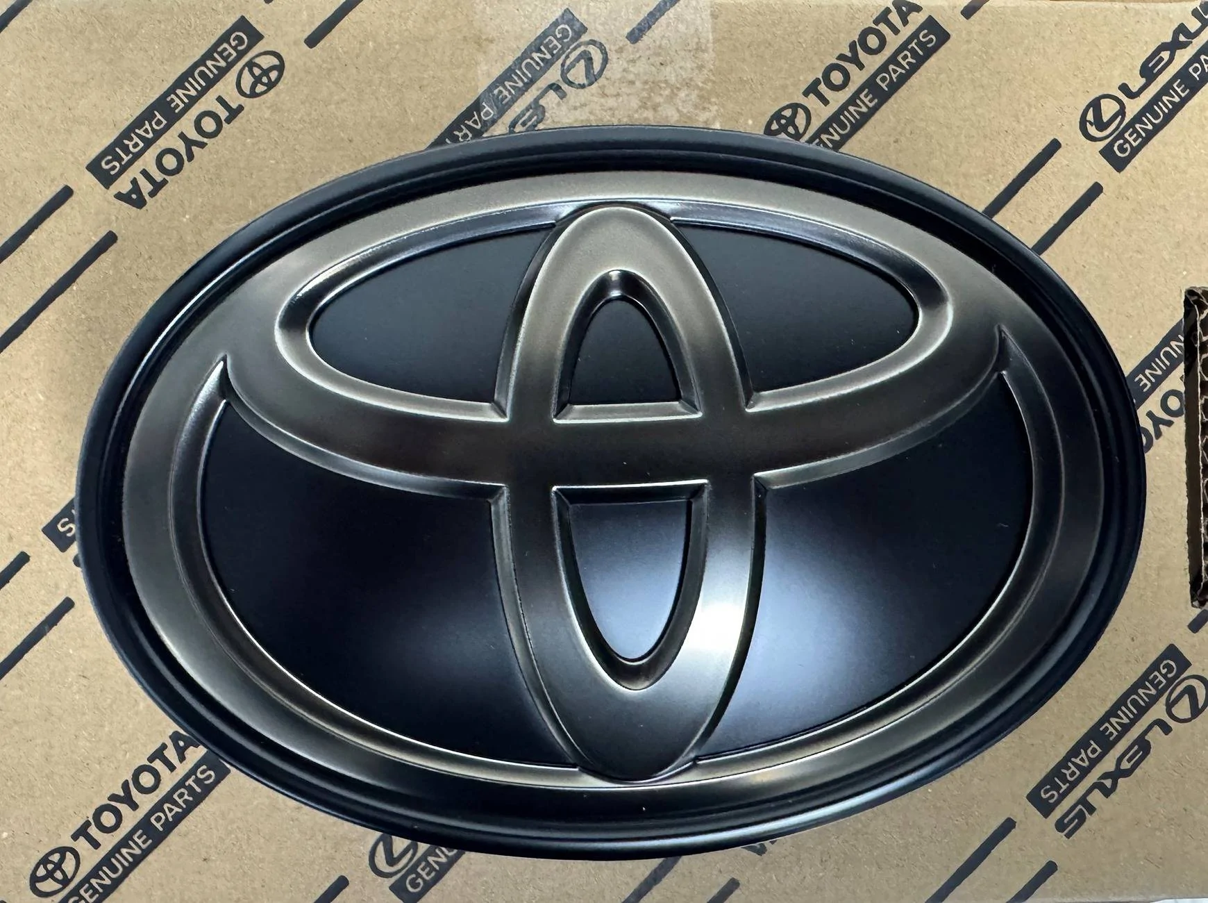

Wasn't a big of the chrome considering that was the only thing chrome on my truck. I purchased the illuminated emblem and threw a little matte clear tinted with a little bit of black, I think it came out pretty good!!
