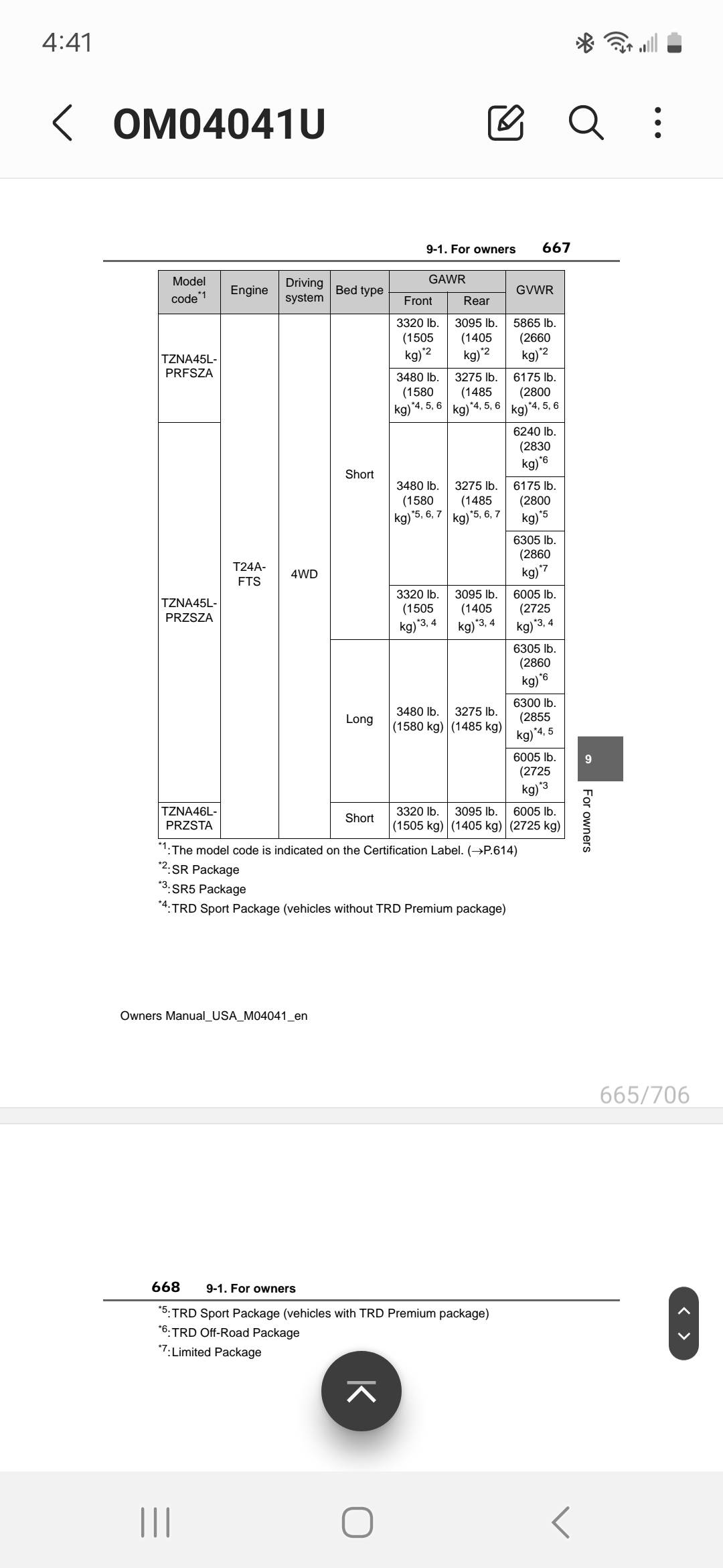

So when you look at the weight capacities in the 2023 Tacoma and 2024 Tundra manuals they list them being a couple hundred pounds less than what seems to be reported at dealers and media reviews. What's that all about? See below:
2024 Tacoma Payload, GVWR, GAWR Figures for 2024 Tacoma (published in owners manual) Screenshot_20231214_071338_Samsung Notes
2024 Tacoma Payload, GVWR, GAWR Figures for 2024 Tacoma (published in owners manual) Screenshot_20231214_071711_Samsung Notes

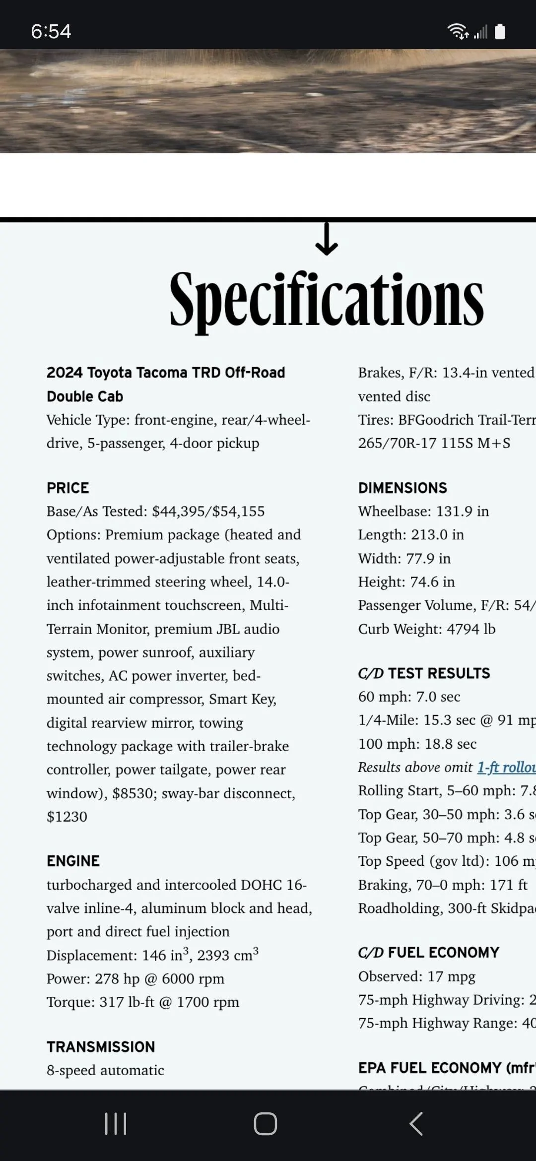

So after some sleuthing yesterday and opening a can of toyota payload worms I think the 24 Taco payload will be much better than 1200. 24 Tundra and 23 Taco listed sticker/manual payloads are hundreds of pounds lower than real GVWR-curbweight. This appears to go for the 24 Taco too.
GVWR for Offroad Taco according to manual: 6240
Curb weight as tested by Car and Driver (with full tank according to their protocol): 4794
Actual available payload for fully loaded offroad with full tank: 1446
Not too shabby, something without a premium package and sway bar disconnect may actually be approaching 1600 or 1700. I'll happily eat my own criticism in this case.
2024 Tacoma Payload, GVWR, GAWR Figures for 2024 Tacoma (published in owners manual) Screenshot_20231214_164128_Samsung Notes
2024 Tacoma Payload, GVWR, GAWR Figures for 2024 Tacoma (published in owners manual) Screenshot_20231215_065438_Chrome

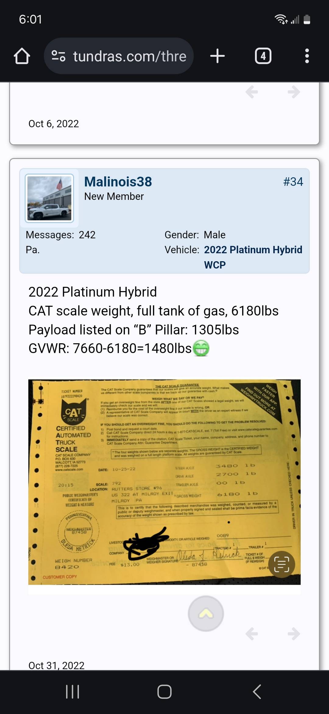

Here is a platinum hybrid tundra, gotta be one of the heaviest trucks they make:
2024 Tacoma Payload, GVWR, GAWR Figures for 2024 Tacoma (published in owners manual) Screenshot_20231214_180136_Chrome
