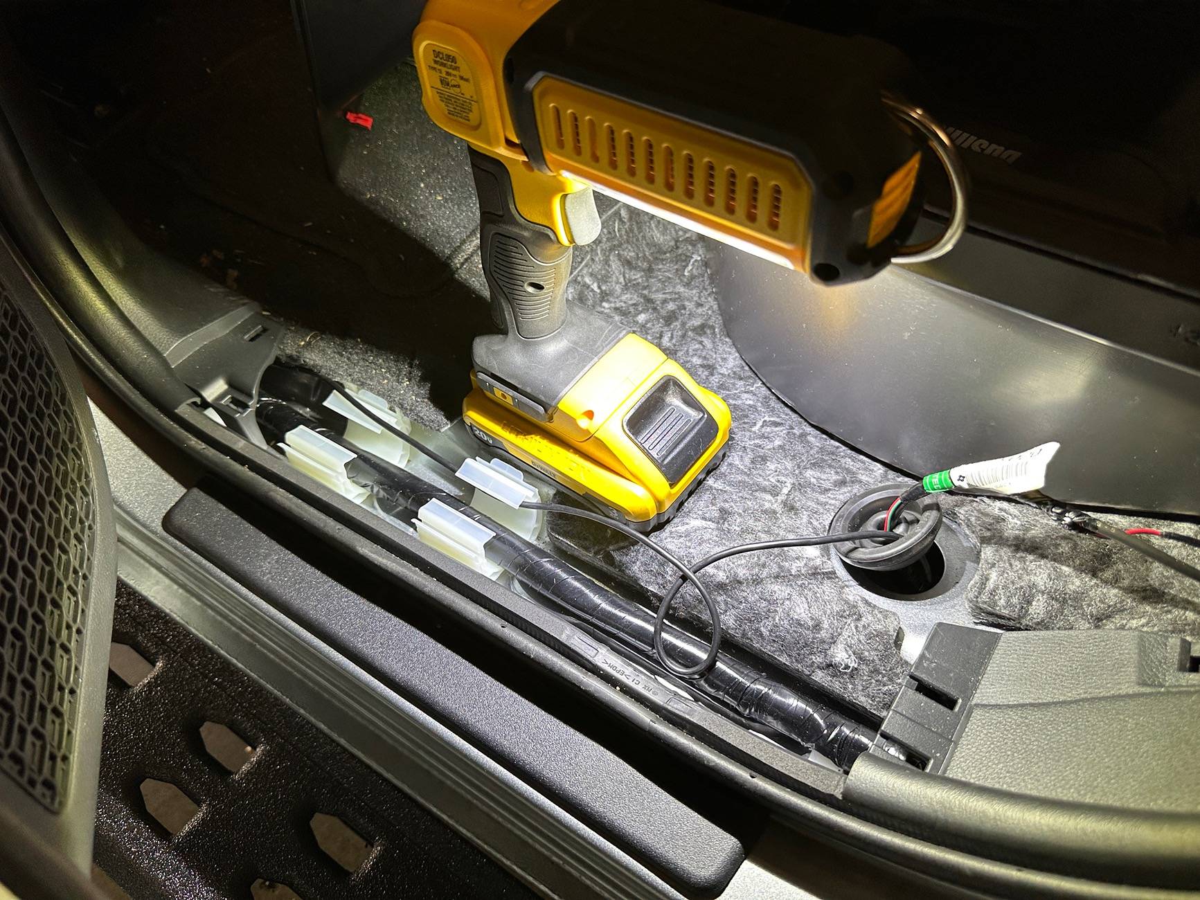

I used the one on the driver's side near the rear seat for the black wire in the photo. Sounds like there's probably a couple of these grommets on the floor that could be used.
I had a quick question, I wanted to route the wiring from my solar panels into the cab via this same grommet but on the passenger side. That side has a loom of wires going through it already. I wasn't sure if I had to make another slit or not.
Did you just make a small slit on the drivers side grommet, pass the wires through, then seal?
Thanks!

... but on the passenger side. That side has a loom of wires going through it already. I wasn't sure if I had to make another slit or not.
That is exactly what I did.
Thanks!
Pretty much, just a small slit using an exacto knife. Didn't really need to seal it because it's already snug going through the grommet.
