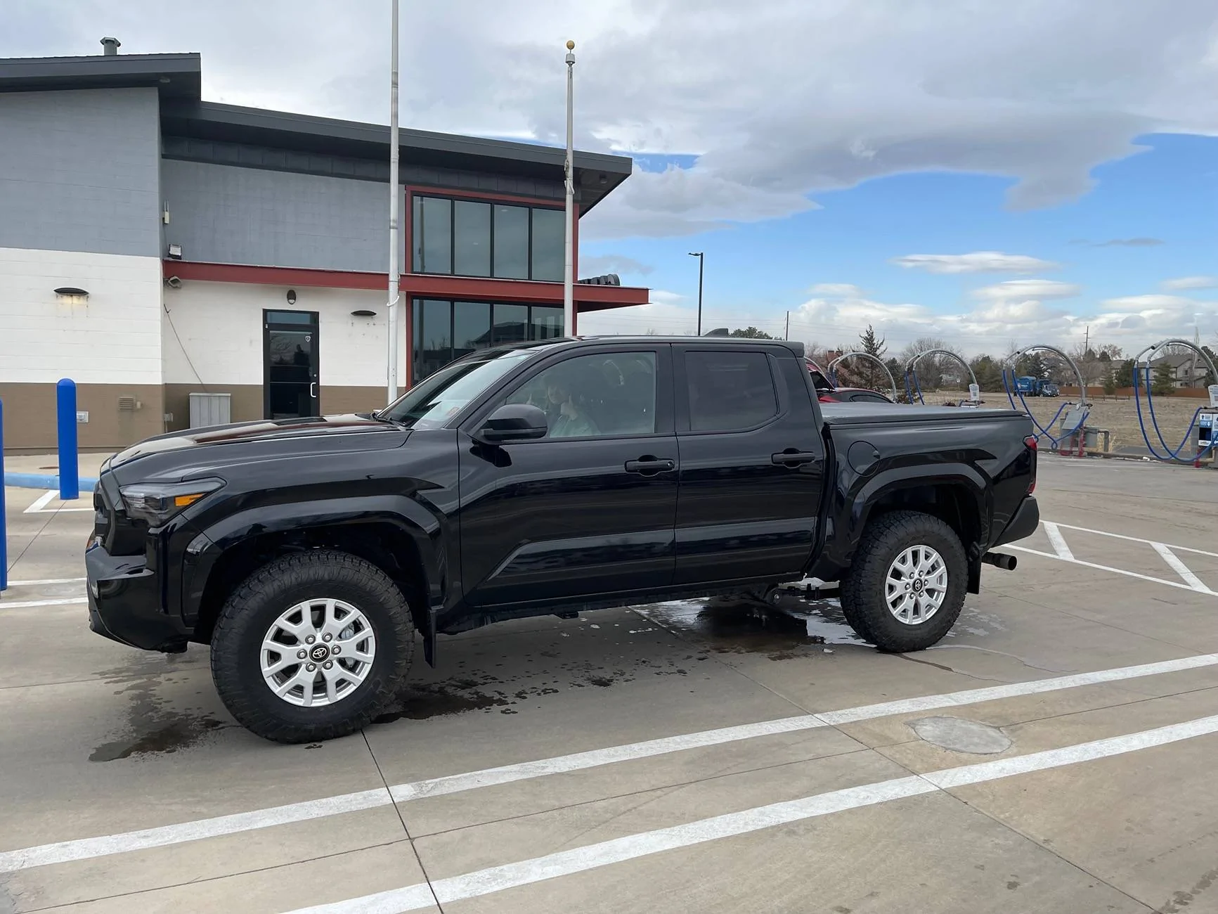

Neither the speedo or odometer is really completely accurate in my experience with the SR. I got my truck on 245 70 r17's but since it's the manual and I get the more powerful engine, I put on 255 80r17s.
Something I noticed pretty quickly owning the truck on a road trip with other people was that the 245's read about 3mph faster on the speedo at highway speeds than any of the other cars I was around. I tested this against the local speed warning things, and it was always reading higher on the speedo by a fairly considerable amount.
The difference between the 30.5" tires and the 33" tires is night and day. The manual transmission is clearly geared for the larger tires-less lurchy- and I found that the speedometer is pretty much dead accurate on the 33s through the same methods I tested the smaller tires.
I got bored on a road trip along i70 though testing the mile markers against my odometer with the 33s and found that for every 2 miles I went, I had to go 21 1/10 mile markers. Or just about 1.05x the odometer reading. I compared this to distance between gas stations vs what my trip odometer read and damn it, it was that 5% difference.
Basically the SR at least is geared and speedometer accurate on 33s but the odometer reads about 5% under what the actual distance traveled was
