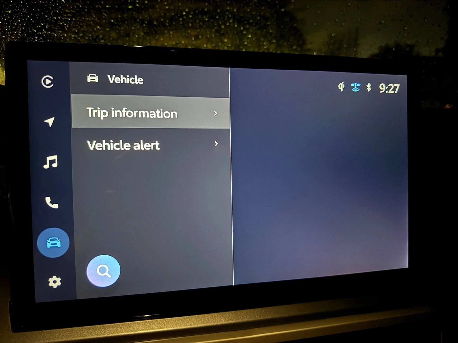

Took me a little time to figure out how to do it.
After tank fill up ….
1. Vehicle info on your display
2. Trip information
3. History
4. Tap tap Update
Your previous Average MPG will move to the left and your new Average MPG will start to the right. This will also reset your Total Average setting in your instrument cluster. The pictures are a little misleading because the MPG numbers are different, but that because I was sitting in the truck in the driveway, with it running and the MPG was changing, both the places will show the same MPG. Do this at each fillup. If you tap Clear
All - All your data will be cleared and it will start over. I don’t see a need to ever do that.
Total Average is total since you tapped Update.

Are you tapping Update “not clear data”?
That it the only thing that I can think of that would do that. It will only show previous best after you tap update and a new bar starts the right of the current one.
