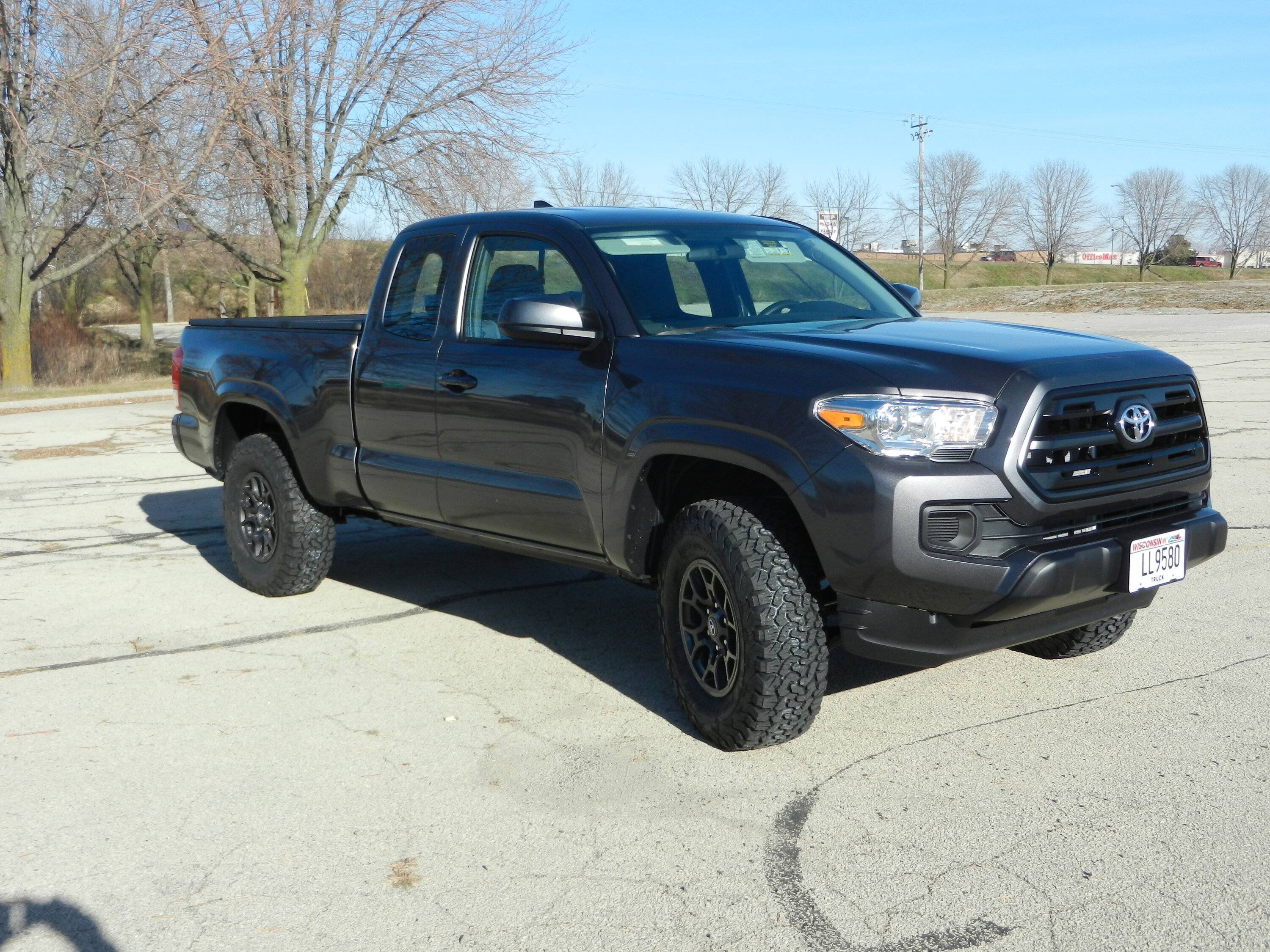

I always budget new tires within a week of buying a new truck.
Truck delivered 12/15/15 SR with 245/75R16, week later 265/75R16 KO2's, no mods.

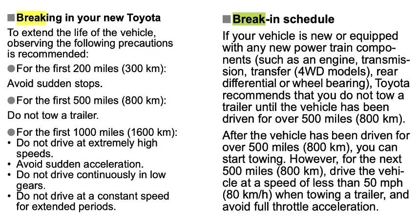

Here's the break-in recommendations I found in manual covering the first 1000 miles:
From their initial road trip, which was over 1000 miles, the only violations I see are starting to tow a 2500 pound trailer 277 miles too soon, and towing above 50 mph for ~777 miles. All the exercises after that are post-break-in period, and tires are stock for the Off Road trim- unless I missed them swapping.
TFL is certainly one part entertainment. But I and many others really appreciate their stress tests that seek to verify manufacturer claims. And in my opinion nothing they've done was outside the bounds of what Toyota espouses (other than early towing of a light trailer).
